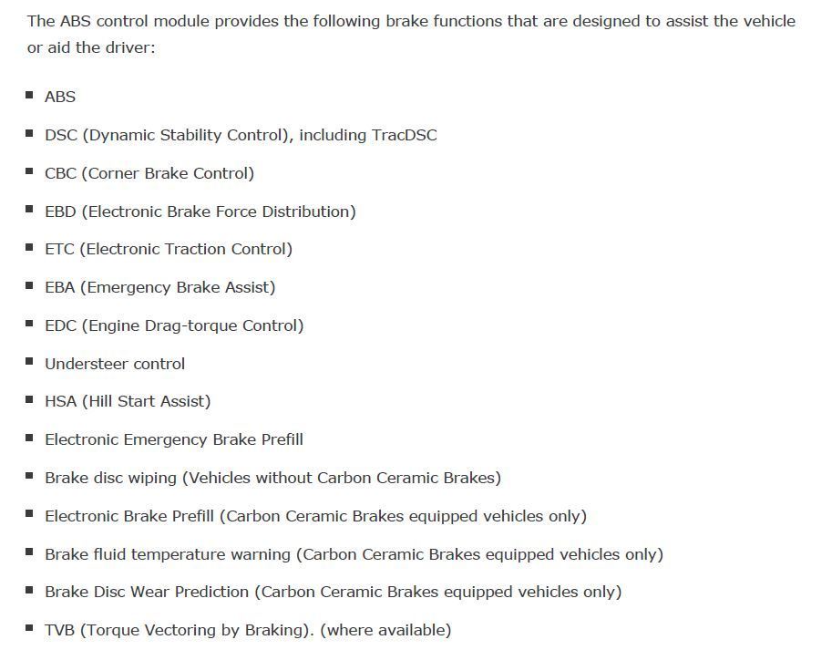

From what I have read the ABS control module handles all that now and there is no separate bias valve like there was in the past.
Here are the functions the ABS module provides;
It stops any one wheel from skidding so if the bias is off for some reason the system should compensate and adjust dynamically to the current situation.
