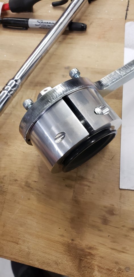

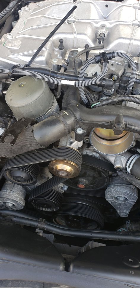

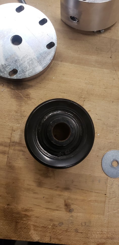

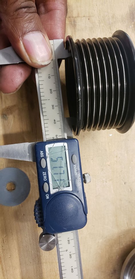

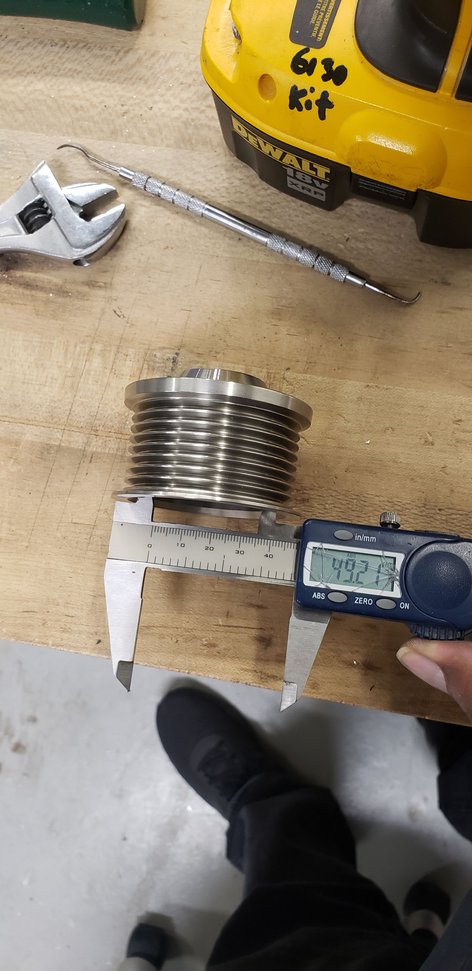

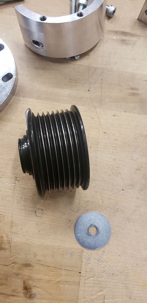

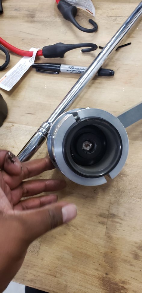

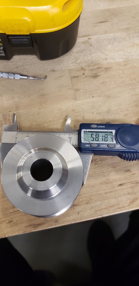

After waiting over a month for the US postal service to deliver my pulley I finally installed it.
First things first..... NO MORE CUTTING OR GRINDING UPPER PULLEYS OFF!
Also the was no grinding needed on the snout to fit.
I had an hour of time put into the removal and install from start to finish.
There is a little more low end torque which I was hoping for but Im going to need to ditch the Racechip and get VAP to tune for the pulley.
I made a quick youtube video showing the removal. Excuse my elbows,they're a little ashy. LOL

Very nice puller, where did you buy it?.
The right tool for the right job always makes life easier.

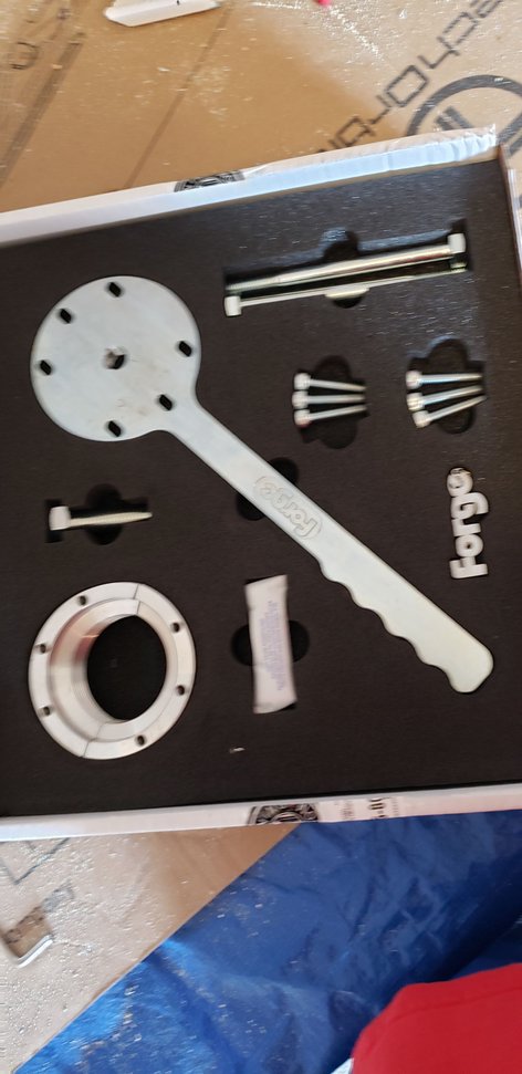

They are a nicely made tool however, there is just not enough room to weild one on the F-Type.
I tried the forge puller but had to send it back as there is little to no room left to play like there is on the XF unfortunately.
Ended up with :
https://altaperformance.com/i-140071...oval-tool.html
and a low profile bolt puller that screws directly into the faces.
This solution was just about low enough profile to have room to get a ratchet/socket combo on.
Uro tuning.
Its designed for an Audi S4.
Ended up with :
I first purchased that puller but didnt have confidence in the puller.

Nice puller tool!
I have not seen that style before and it seemed to work great for you.
How much was it?
$157.
I'm willing to rent this 1 out since it will be sitting.
