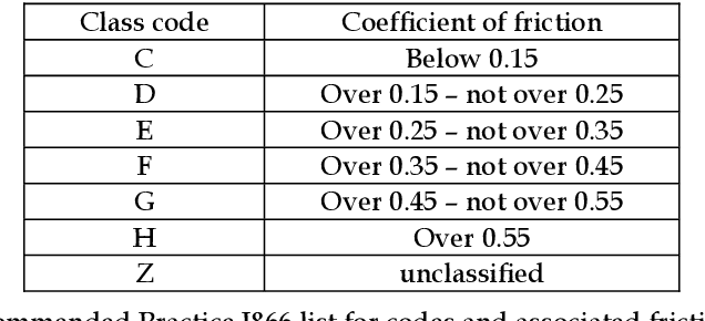

Many brake companies will produce a brake pad for you. The backing plates are simple enough to make, and the pad material is common. I've asked Carbotech to make pads for my truck and they did!
https://www.motortrend.com/how-to/di...des-explained/
Here is a handy chart to compare the friction rating and the CoF. My fav Carbotech pads, the XP8's are 0.56 or H rated when hot. By way of comparison, an F rated Ceramic pad could be rated at 0.36 and have about 40% less stopping power. That's a huge difference.
