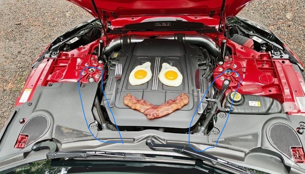

I’d start by checking the tightness of the bolts that hold the cross braces.

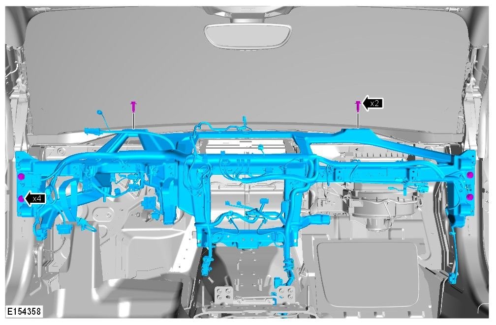

Are we speaking of the four (4) in the door jams? As shown in the image below? Or others?

Cross braces underhood and the undercar ones if a vert. Otherwise, it would be 'take it apart and re-test' until you find it, noises like that are tough.

I copied Graybeardnw’s amusing photo from another thread. Cross braces are circled.
