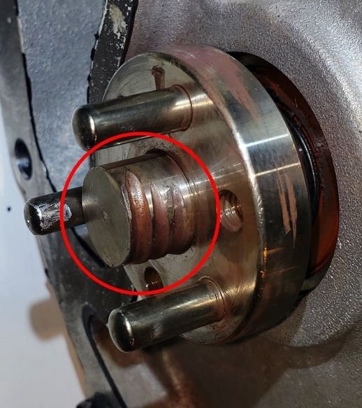

Another trick?
Usually this noise is very noticeable on engine shut down. With the car running open the drivers door. Now shut off the radio. Now shut off the engine and listen. There is a rather loud clunk as the engine shuts down. This is the easiest way I have found to determine this.
Now it's not something that's critical and my car has been doing this for at least 20K miles. If left too long then the spring on the coupler can and will eat into the snout shaft. Then you need to replace the entire snout and not just the coupler but be aware there are bearings in the snout so it's not a bad idea to replace the entire assembly anyway. But it is more money for sure!
Note this is NOT an absolute requirement and many have simply installed the new coupler on the worn snout shaft. Your car-your choice!
Here is a picture I stole from Reaxions in one of his VERY useful threads!
Note the reddish color is from rust and there can be quite a lot of it depending on the car.
See attached service bulletin discussing this problem.
Note I have NOT discussed the solid coupler or spring coupler variations as that is another whole chapter of SC repair!
I favor and recommend the Eaton factory solid coupler above all others.
Did you use the Aluminum pipes?

Let’s clarify a couple of things: there are two engine-mounted high pressure fuel pumps. They are, by nature, noisy, therefore and contribute to the general “clicky” engine noise common to direct fuel injected engines. This noise does not indicate malfunction, but an excessively noisy pump might suggest replacement. An educated ear is needed to differentiate between normal pump clicking and a pump needing replacement
Next, if the SC coupler does not knock/clunk excessively when the engine is shut down, then it is not likely to need replacement. My 55,000 km V6S had a single knock/clunk on shut down, and always had this noise. But when the coupler was removed (as I was having aluminium pipes installed in place of the original plastic pipes), it was found that neither the coupler nor the shaft itself showed ANY signs of wear. The shaft was in perfect condition and rotated freely. The sort of damage in the photo shown in an earlier posting is probably not common for a car in normal use.

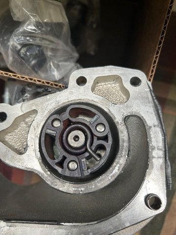

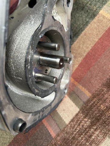

Further to my posting #8 above, here are photos of the original coupler from my 55,000 km V6S. You can see the condition of the coupler shaft.
Old Aug 21, 2024 | 06:47 AM
Tayls77's Avatar
Joined: Mar 2018
Posts: 161
Likes: 58
From: London, Ont
Still looks like new, appreciate the responses, really nothing serious to worry about at this point!
