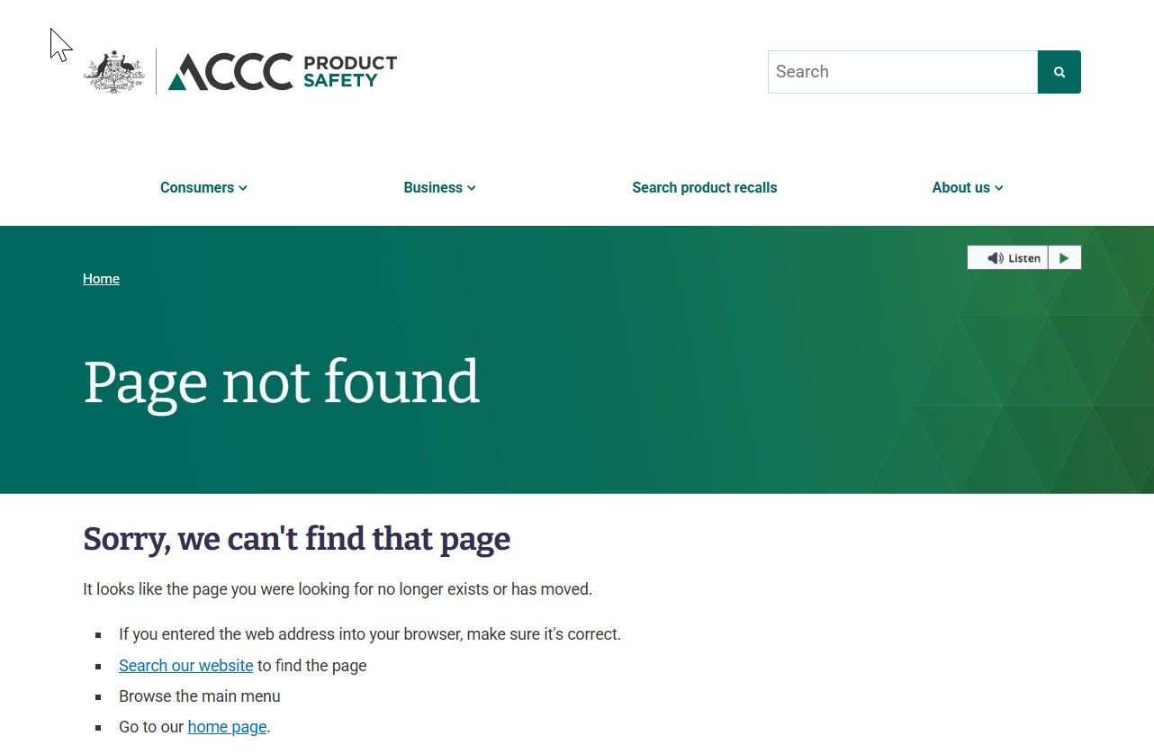

Hi, I just went to post #156. The link fails to get things for me:
Nothing is there, at least from where I sit.

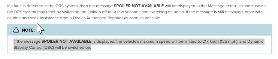

So I dug a little and this is what the literature seems to say from Jaguar:
https://www.ownerinfo.jaguar.com/doc...04366/G1703543
Those are their (JLR's) words.
Yep, same here, link no longer works.
So I searched the ACCC site and nothing, it's gone.
But I did find this web page from over 10 years ago: https://www.drive.com.au/news/2015-j...iler-may-fail/
Extract:"Jaguar Land Rover engineering has identified that EMS [energy management software] failed to apply the vehicles speed limiter to restrict the road speed when deployable rear spoiler (DRS) failed to deploy," the recall notice states.
"Where road speed exceeds 217kph with the DRS [deployable rear spoiler] in the down position vehicle stability will be compromised and the degree of directional control minimised, this significantly increases the risk of an accident."
Owners of affected vehicles - vehicles with VINs SAJAA65B5F8K15254 to SAJAC61B5F8K15884 - will be contacted and asked to see an authorised Jaguar workshop. All affected cars will be updated with "the correct calibration software".
Hence my reading that the rear spoiler has no real effect below 217 kph (135 mph).
