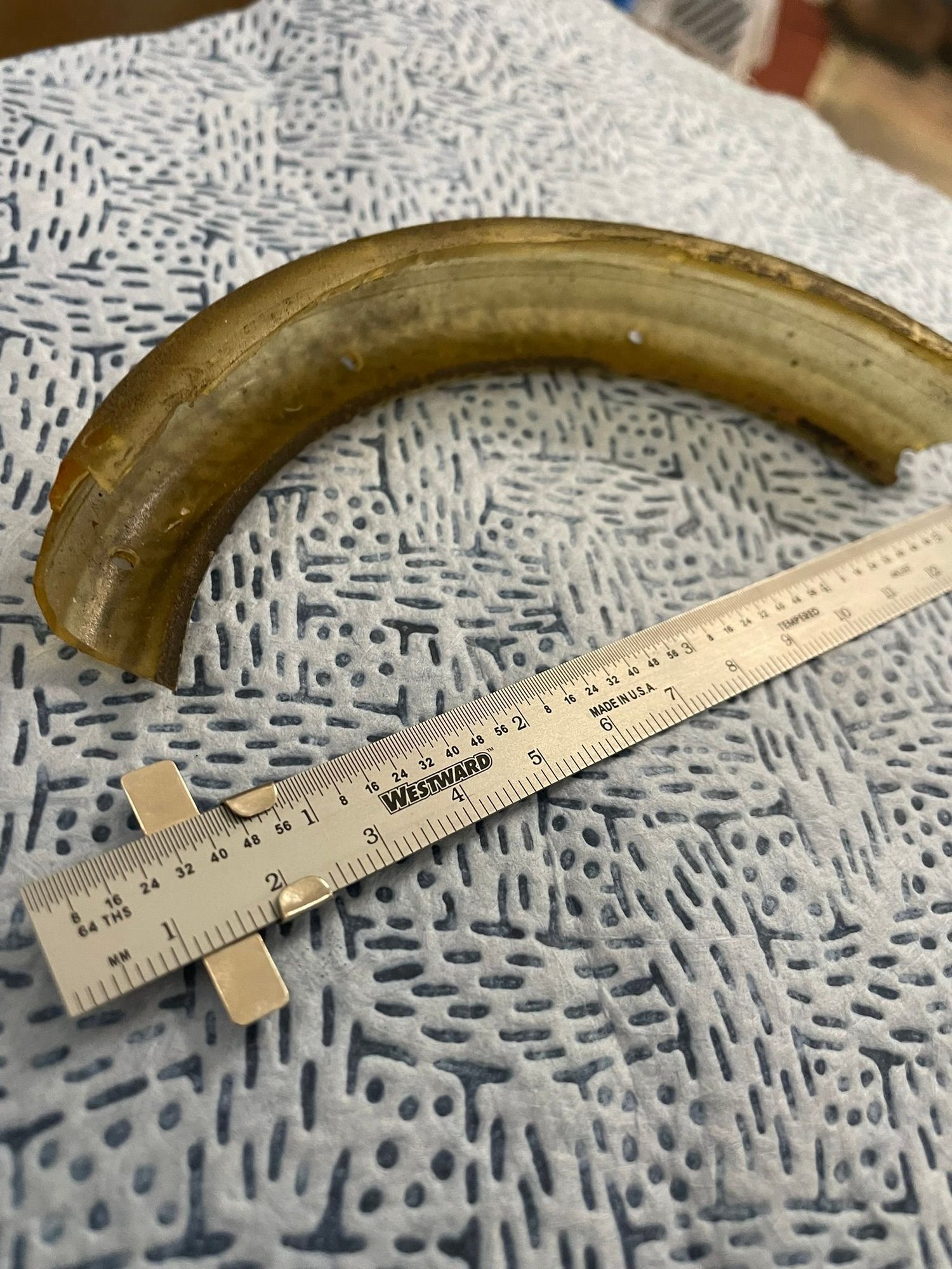

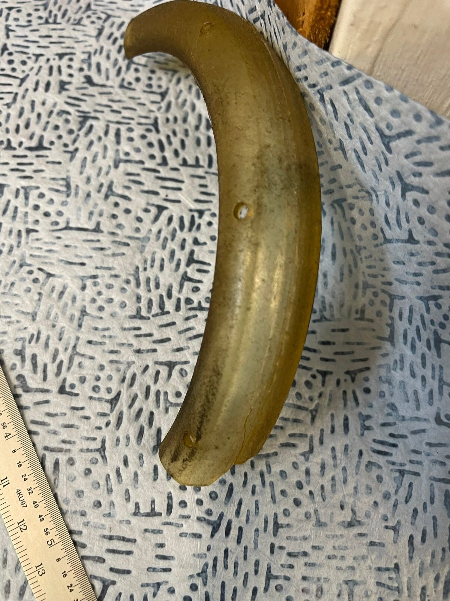

We had an intermittent rear CLUNK for over a year on our '14.
Then one day, we found a cover for the rear coil spring on the floor of our garage! It is a discolored clear tube that fits around the coil on top...you can barely see it.
I ordered a replacement spring isolator for a Honda coil spring. Told myself I would replace it at the next yearly service. But as a faithful member of the Procrastinators Society, I didn't 'get a round tuit'...I just sprayed some silicone/lithium grease up there.
LO AND BEHOLD, I haven't heard the CLUNK all winter! Good thing too, as I've been delaying sending the year's dues to the society....
Here's a picture of our car's droppings.
