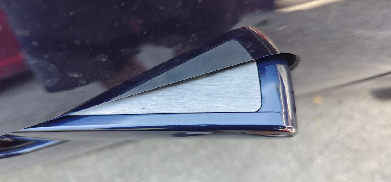

Ok, I took the time today to work on the car.
With rebrushing the aluminum I ment using the scotch pads I have to brush my watch bracelets (I am a watch enthusiast as well) in case of scrathes or refinishing. That is also the easiest way to get the rest of the lettering off.
The refinished handle looks like this (sorry car is dirty):
I ordered brake caliper decals in different sizes. I used the smallest which is a tiny bit larger than the original (I like it better though), side by side they look like this:
And this is the finished result. Make sure the surface is absolutely clean for the application:
I really like the end result. I actually like the slightly larger lettering better than the original one. That is though highly depending on your taste.

PilotR - what do you mean you re-brushed the aluminum? Did you paint the Jaguar logo back on? Or use a label?

did you mask off the area around? Where did you get your caliper decals? How did you avoid the little key emblem?

I did but only for the brushing to not scratch the paint. You just use normal tape. You just cut a small piece of the scotch pad and brush in the same direction as the original brushing. The lettering will go right off, its not really well printed. That way you wont hit the key printing.
The caliper decals I got from etsy.
Shop is called caliper stickers:
www.etsy.com/en-gb/listing/1038566326/jaguar-2020-brake-caliper-decals
