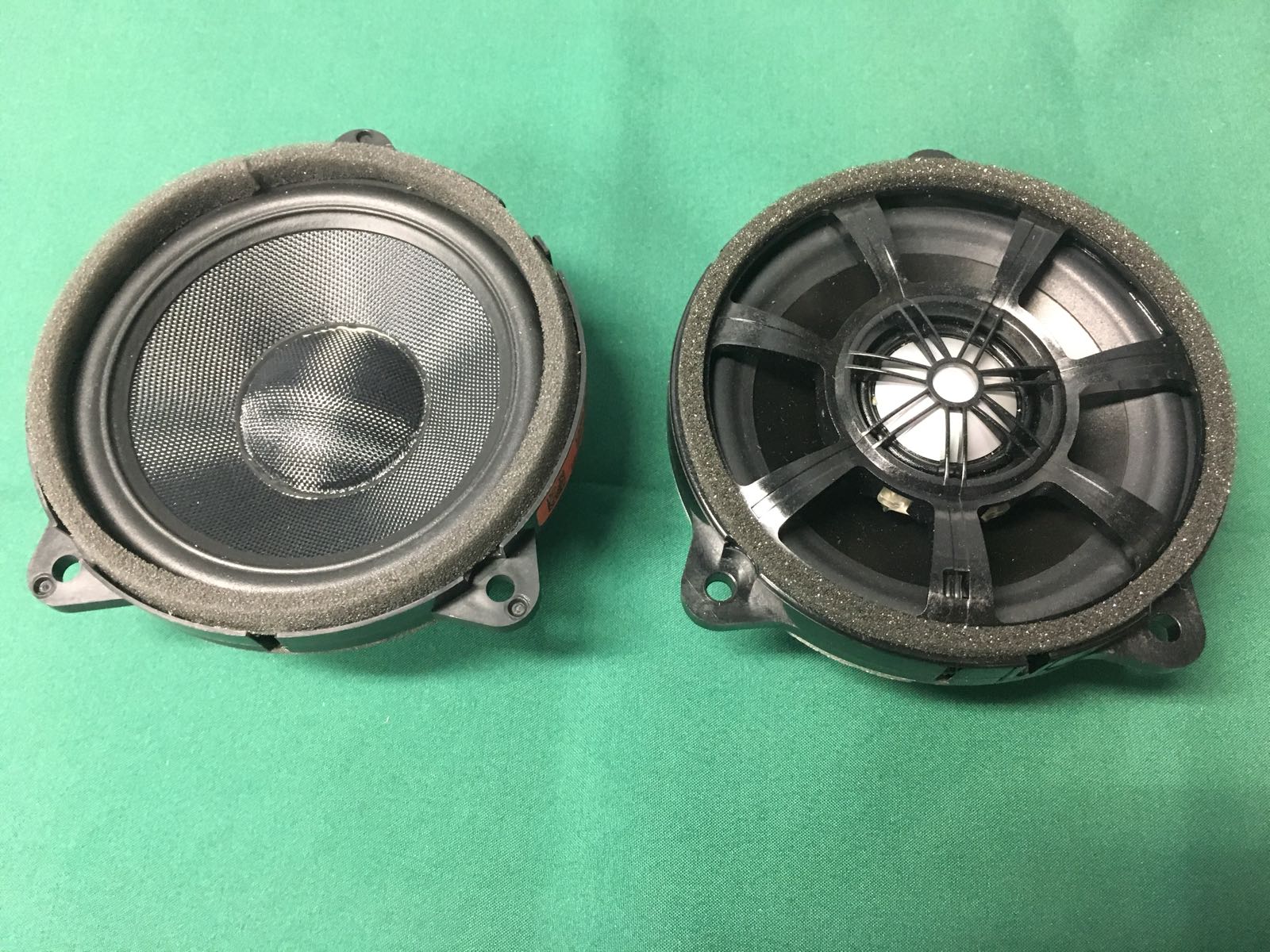

I'm thinking of switching out all of my Meridian 770w door speakers for the Signature line per Cambo's list. Trying to decide if changing the center speaker really makes much of a difference. Any input on before and after with and without changing that center speaker? Just not sure how much its involved in the average soundtrack? Thanks.
I will be using LR033292 Tweeters, LR047119 woofers, and LR033293 Mids
If I switch the center channel I'll probably go with the C2D2079

Well, I replaced the door subwoofers with the Signature line. They do sound a bit better. I also took the time to dynamat the door cards which has helped a bit as well. I am still left wanting more powerful low end when the top is down, which I know is not an easy thing to do in a convertible. If I add an amp and use the speaker level inputs that go to the woofers behind the seats, does anyone know what frequencies these rear woofers are receiving/crossed over at? I'm just wondering if they have any filtering for sub base which would make that input not useful for adding a subwoofer amp.

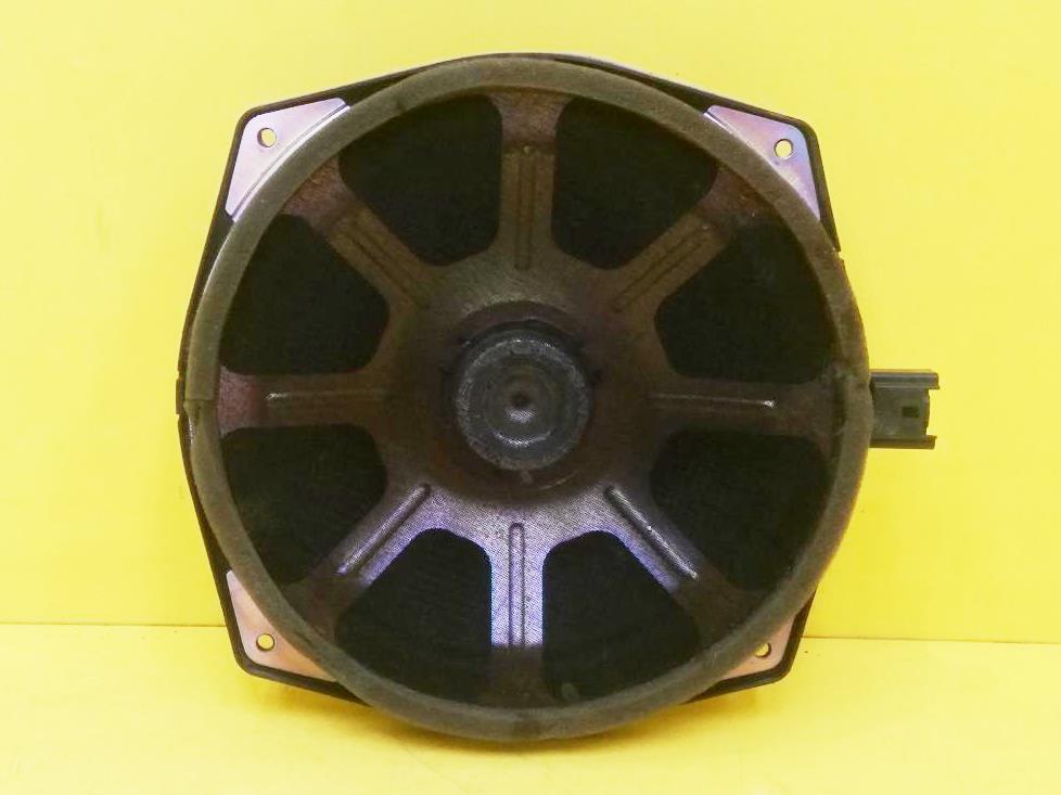

The 200mm drivers in the doors are woofers/midbass, not subs. The 200mm drivers behind the seats are the subs, though they are also flimsy and not in proper enclosures. I've seen at least one person replace the subs with better dual 2-ohm drivers and they said it was an improvement. Honestly, in a convertible that's probably not sufficient but the problem is you also don't have much of any trunk space for a proper enclosure. A good single 10" sub designed for small sealed enclosures will do the trick. Something like the Image Dynamics ID10 V.4 would be a good choice. You'll want to use the speaker-level signal from the subs behind the seats to feed your DSP/amp.
Thanks. Its interesting you say the rears are subs because when I isolate them using the balance controls they do not sound like a sub at all. They sound like midbass fill. The doors are clearly reproducing the lowest tones. That is why I was concerned that the rears have some kind of cutoff for the lowest frequencies. Space is definitely the issue. I could mount a slim sub in the trunk but with the big metal wall I'm not sure it will sound very good at all with the top down.

There is also a midrange driver behind each seat for "fill". It's likely that the woofers in the doors do a better job of playing their respective frequencies and you are actually hearing the 90-200Hz coming from them, which is still bass. The poor quality of the rear subs coupled with the poor installation means they probably can't do much in the actual subwoofer range below 90Hz. You can try playing some test tones at various frequencies. Even if the door woofers have a high-pass filter at 90Hz, that won't be a hard cut - it will roll off so they will still be trying to play below that at something like -12bd/octave. I'm completely guessing at the actual frequencies here. It's just to explain the concept. I'd love to know the actual cross-over frequencies of all the channels.
Yup, I see what you mean now. I played a 40Hz tone and you can really only hear it through the rears not the doors. I opened up the cavity to look at them today in hopes that I could figure out a way to make a better speaker work back there but its a complicated mess with the seatbelts and wiring. I could replace the drivers like Paul did, but that doesn't seem to make much of a difference. I guess I will try the trunk sub route and see what happens. Thanks for the help.

Yeah - the rear subs are TRYING to play that 40Hz tone but just aren't up to the task for several reasons. So it's their responsibility but they do the job poorly. Personally, I'd skip trying to salvage something from that stock location and go right to a good single sub in a proper enclosure in the trunk.

By playing test tones I've seen them respond to as low as 20Hz.
I have a coupe, so your installation may be a bit different. I detailed in the thread below how I replaced the rear subs and the replacement speaker parts I used. I replaced the (6) door speakers, (1) dash speaker with and the (2) subs behind the seat. I left the mid-range rears as is, there is no easy replacement.
I put a class D amplifier and LC2i in the hatch area where the spare tire would ordinarily go. I also updated the software for the factory amplifier (a very noticeable improvement in quality).
I also made an "enclosure" for the subwoofers by packing high density foam (think memory foam) around and behind the subs. This helped pretty dramatically to get them to hit the lower frequencies. The open baffle design from the factory is totally inappropriate for the subs.

Originally Posted by Cambo
The Titanium dome tweeters are p/n C2D30486 or LR033292
The 100mm "B&W" yellow Kevlar midrange speakers are p/n C2D2076
The 100mm "Meridian Signature" black Kevlar midrange speakers are p/n LR033293
Can see here the black ones compared to a standard surround speaker with paper/rubber cone.
Attachment 210921
The 200mm "Meridian Signature" bass speakers are p/n C2D24861 or LR047119
Attachment 210922
Hi Cambo.... So, let me make sure I have this right before i start ordering parts with reckless abandon for my 2014 V8 S:
  • a 100mm Ti Dome tweeter and a 100 mm midrange go in each door
  • 200mm bass unit go also in each door.
  • IF I want to upgrade to the 770, i would also need the amp and a center dash speaker as well.
