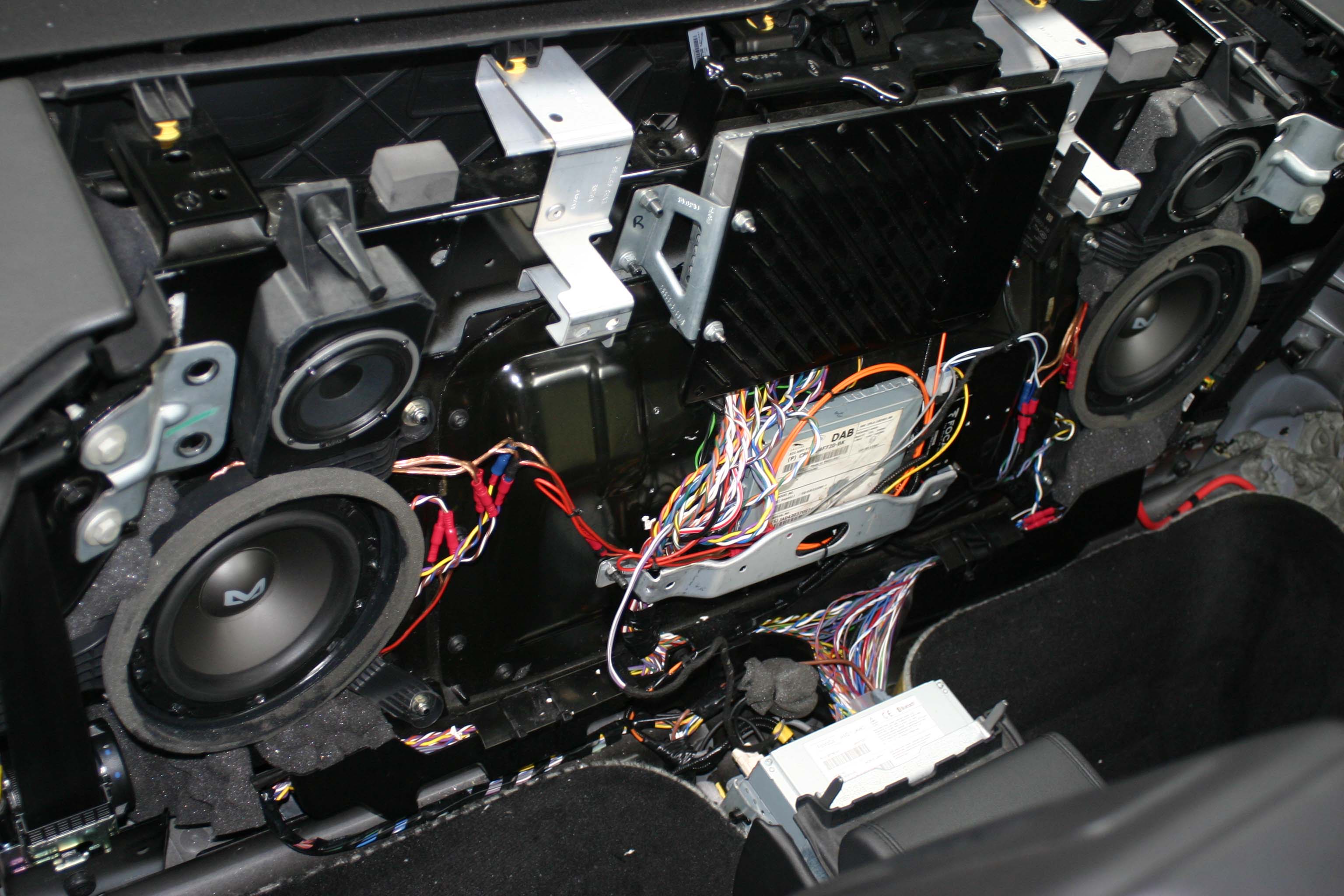

Jeremy, I finally got a chance to watch your 2nd video.
Your car has the NGI Infotainment system in it, this is the newer version that uses Ethernet for data transmission between the head unit and the amp, not MOST fibre optic like the earlier cars.
The Mobridge DA-1 is not going to work with this system.
Here in this screenshot;
Your hand is on the IMC "Infotainment Master Controller" from the NGI system, not the Sirius receiver
The amp above your hand is an NGI amp.
"At first glance I don't see the fibre optic cable that I need" yes because it's not there, there is no fibre optics in this car, it's Ethernet.
Sorry to be a bearer of bad news, but I guess you already figured that out.

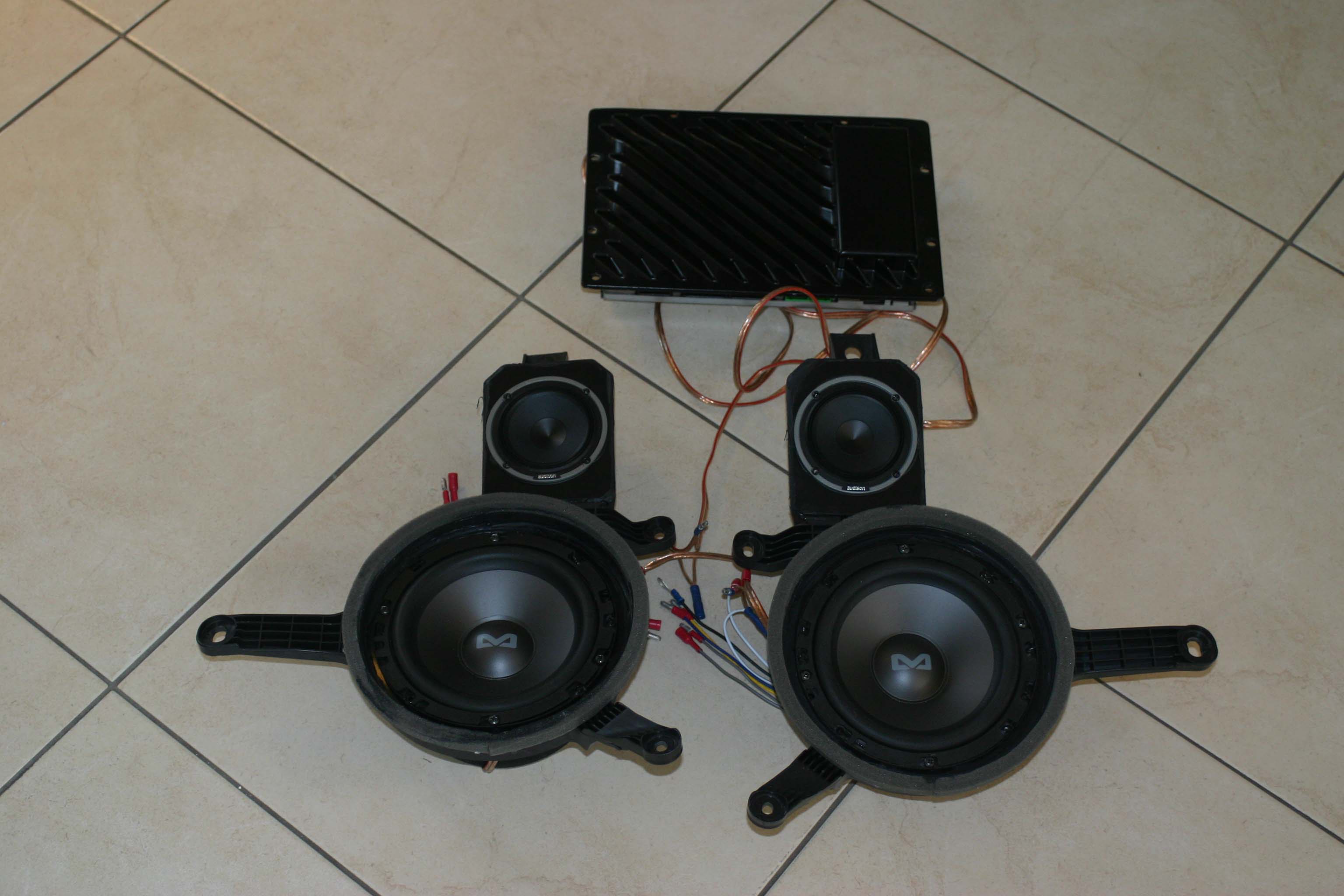

Here's a side by side of the standard Meridian speakers and the Meridian Signature Kevlar ones.
The difference in sound has been described to me as "night & day" in the F-Type with 380W Meridian system, seems like it's a worthwhile upgrade before going to the aftermarket.
Not much of an upgrade over the premium meridian stock system?
Old Mar 23, 2018 | 03:20 AM
  #85
Cambo's Avatar
Joined: Jan 2011
Posts: 8,637
Likes: 4,526
From: Sydney, Australia
If you mean the 770W Meridian Surround, then we have not tried these exact speakers in one of those yet.
And the 380W system in this 2017 is not the same from an electronics & software point of view as the 2014-2015 cars with 380W, or the 770W Meridian up to 2017 either.
But slojotaa upgraded his 770W system with some other OEM Kevlar speakers (yellow "B&W" Kevlar) and reported a considerable improvement.
At the end of the day, the factory speakers in both the 380W and the 770W Meridian are not the best JLR have to offer, there is definitely room for improvement, whichever way you go.
