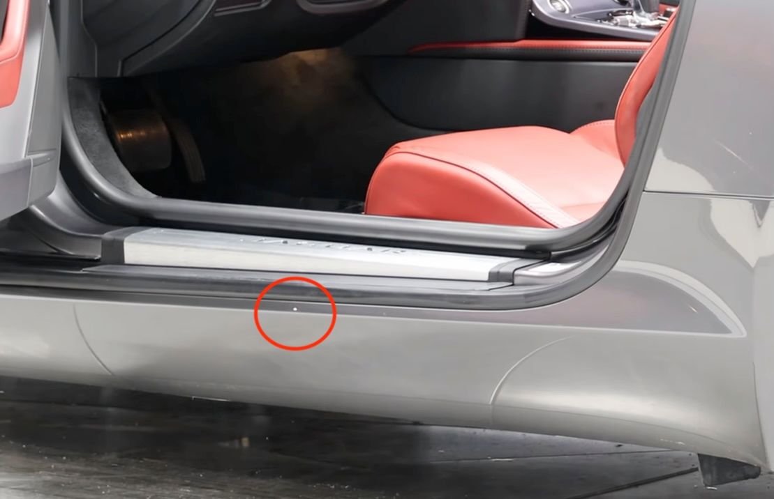

I was able to look at the car on Friday. I have to say, what a beautiful car.
I tried to put my want to have one aside and be critical of it as I looked it over. This is what I have found so far:
1. Engine cover (part number T2R20744) was indeed missing and it seems to be from the last time it was serviced because the engine looked naturally clean… They will install a new cover.
2. They are also replacing the hose that goes from the coolant expansion tank into the rest of the cooling system (part number T4A1783) . It was cracked at one side of the "T" where all three hoses connect.
This one:
Not a photo of the actual car, this just to show where it goes.
3. Tires: Front tires are gone. Rear might have 1-2,000 miles still in them... So all 4 will have to be replaced.
4. Wheels will need to be reconditioned as they have some curb damage.
5. The paint overall is in great condition but I did see one chip on the side sill drivers side.
