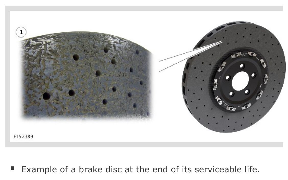

I haven’t had to replace pads yet, but getting there. The rear pads are almost done. I’m surprised the dealer didn’t change them. For CPO 50% is the minimum. Also, for track use the recommendation is to never go below 50%. I would ask them to replace the pads. I would guess it has just 5k miles left, and I would watch it carefully, if the pad back contacts the rotor during braking, the rotors are toast.
A little roughness is fine, but indicates wear. Here’s what the service manual says about the surface condition:
Should also check for cracks and any large chips.
I agree with SinF, if you’re dead set on getting it and you haven’t bought the car already, I would negotiate hard. The rear pads are out and the front ones are not new. Have them fix the vibration and replace the rear pads.
