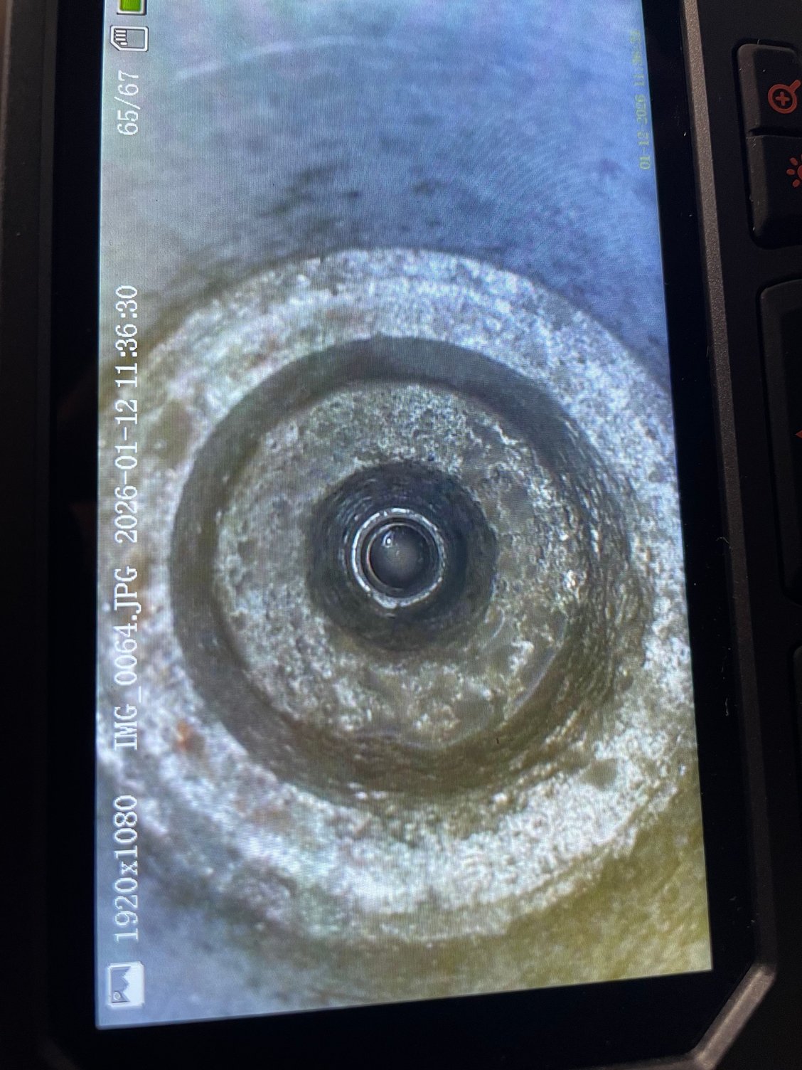

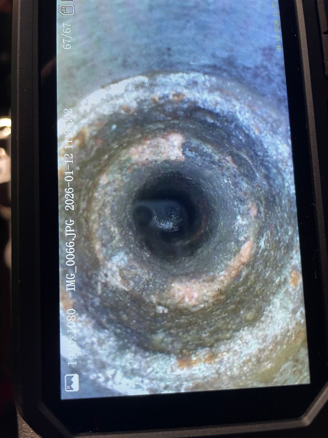

Jan 12, 2026 | 03:49 PM
Hi,
I'm in the same situation right now, pictures are attached. This is a used 37k engine I just purchased. Is it fixable or should I return the engine?
Cylinder 5
Cylinder 5
Cylinder 6
Reply 0
