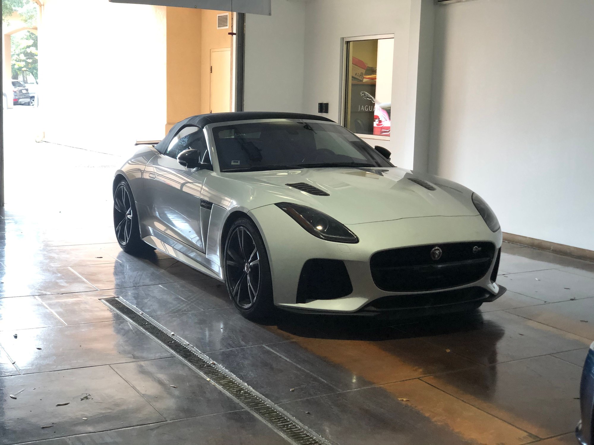

Nice shot today when I was at the dealer.
