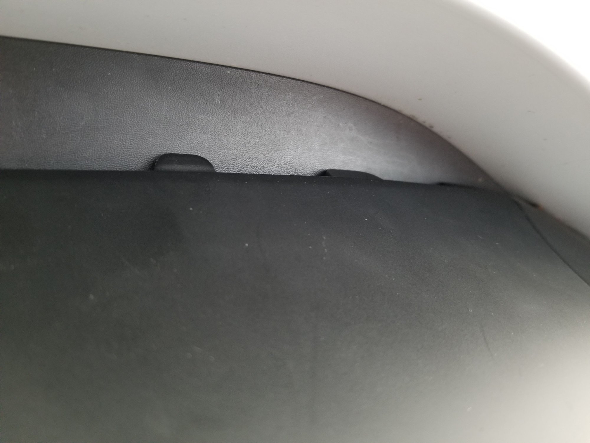

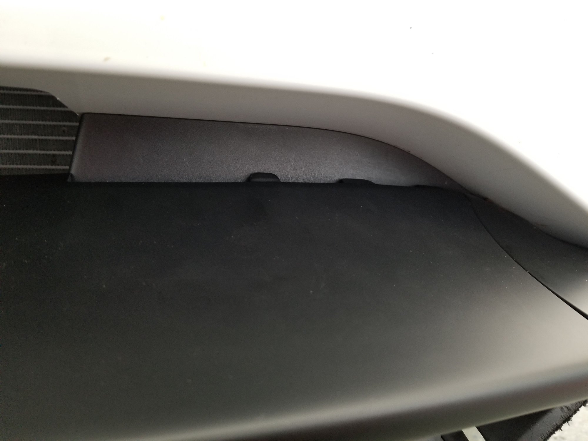

Any assistance in identifying which bolts/screws/fasteners need to be loosened to adjust the fitment of the front center spoiler would be greatly appreciated. The dealer replaced that part Friday and it wasn't aligned properly so I investigated the problem yesterday and found that the three tabs on the driver's side of the piece were not inserted into the slots in the backing piece. This threw the center piece out of alignment with the end piece. I tried loosing what I could get at just lying on my back but couldn't force the new part into the slots. I'd rather fix it myself than drive the four hour round trip to the dealer again (it would be my third trip for the same repair), but I don't want to do more harm than good.

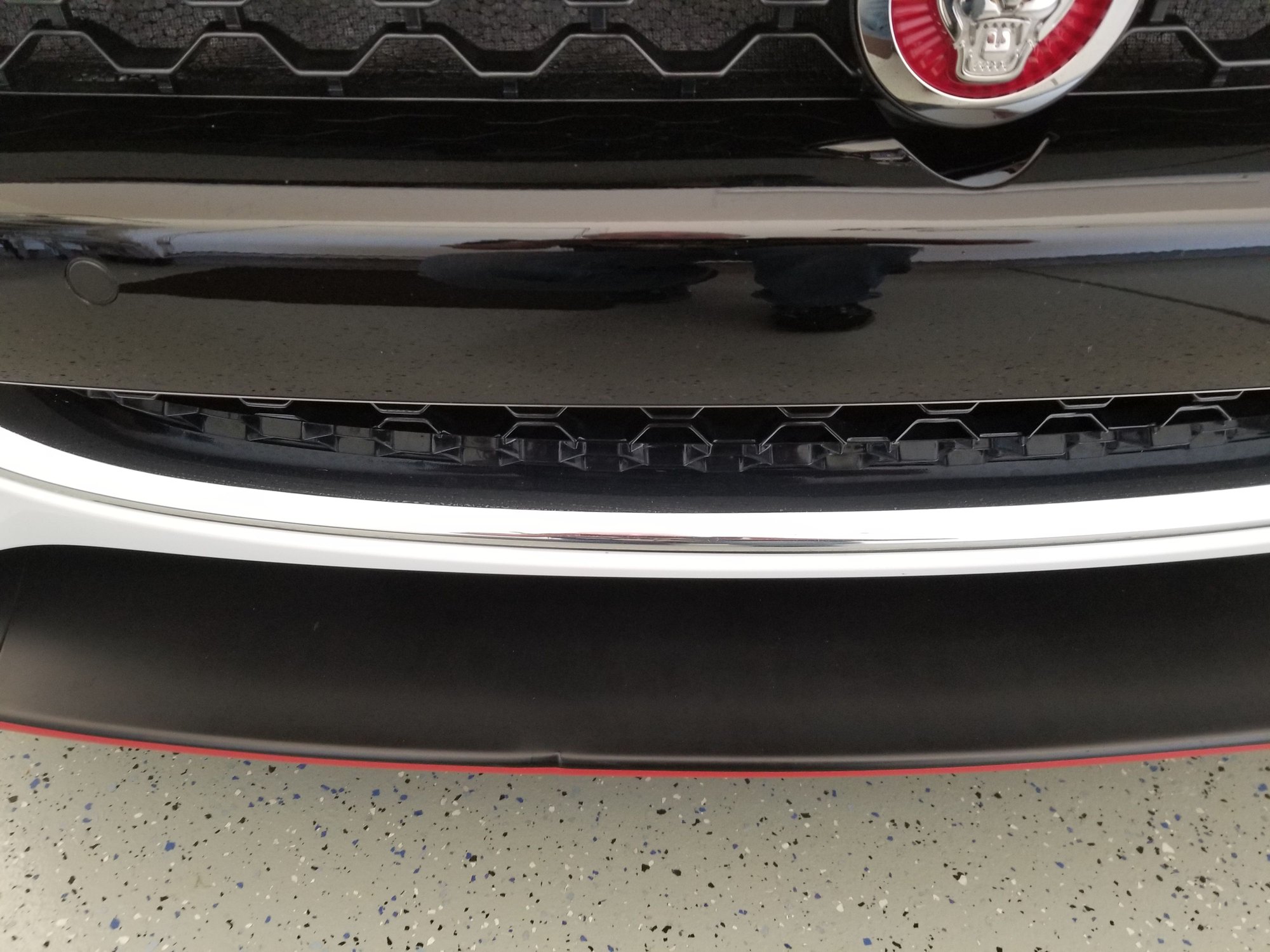

The center piece with the red pin stripe.

Here are a couple pics of the tabs that aren't in their slots and a pic of the bolts so far removed.

I replaced my lower valance two weeks ago. To get to all the screws you have to remove the bottom pan. Their is a screw at each corner and three in the middle. I did it with only jacking up one side of the front so that I could slide under on the garage floor and remove all the T bolts.

I replaced my splitter with a new one a couple of years ago and it was very different to what you are showing - no 8 mm or 10 mm screws or bolts instead five Torx screws (T20???) on the back side, same as Tp10XKR. I reckon the bolts/screws you are showing are for the middle "whisker" piece and not the splitter (no whisker pieces on my car anyway) and you need to do what Tp10XKR and I did - remove the front under tray and then the "cage" plastic piece under that to access the five Torx screws on the back of the splitter, that is if your splitter is mounted the same way as ours.

Yes indeed, the bottom pan (front) needs to be removed to gain access to the splitter bolts.
