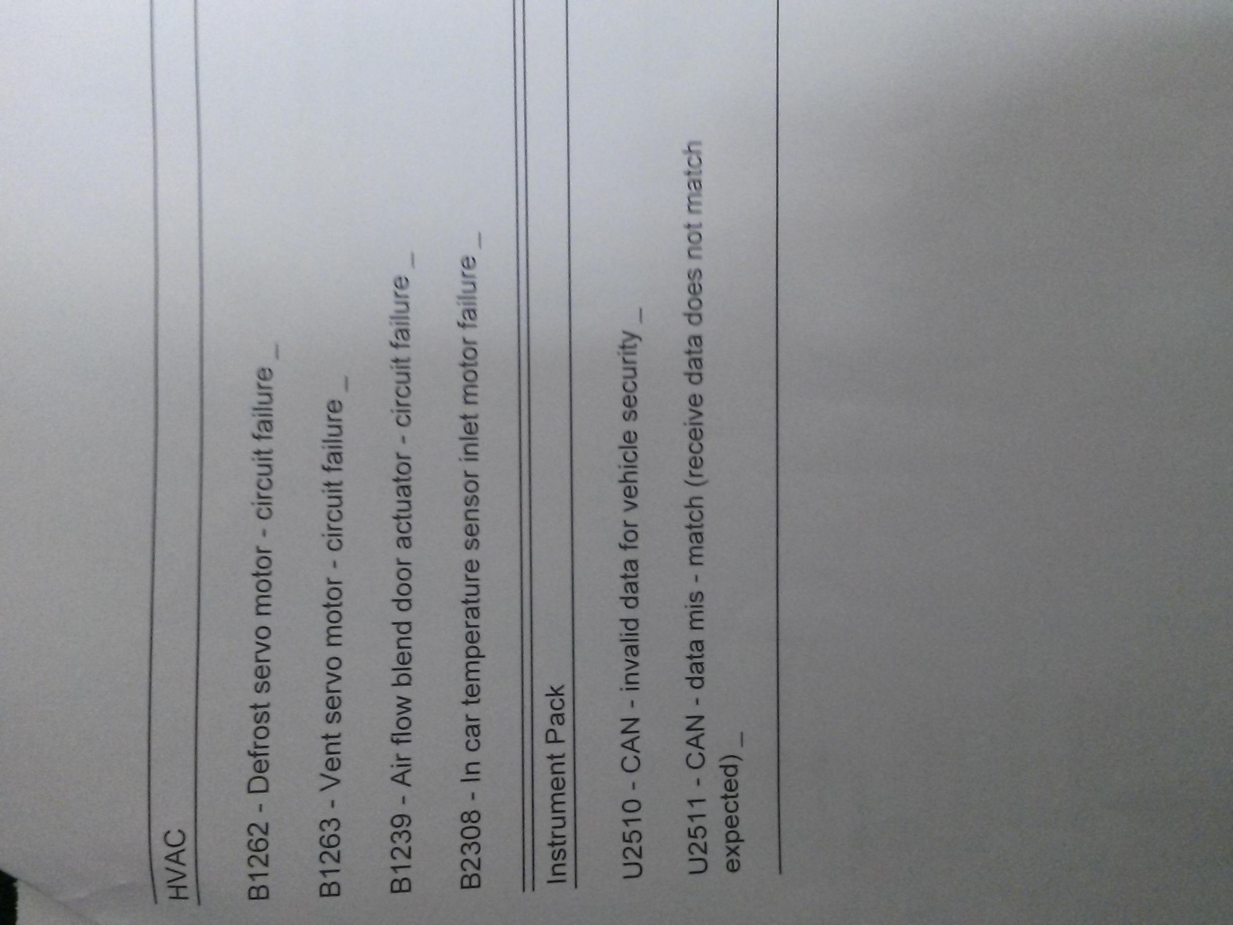

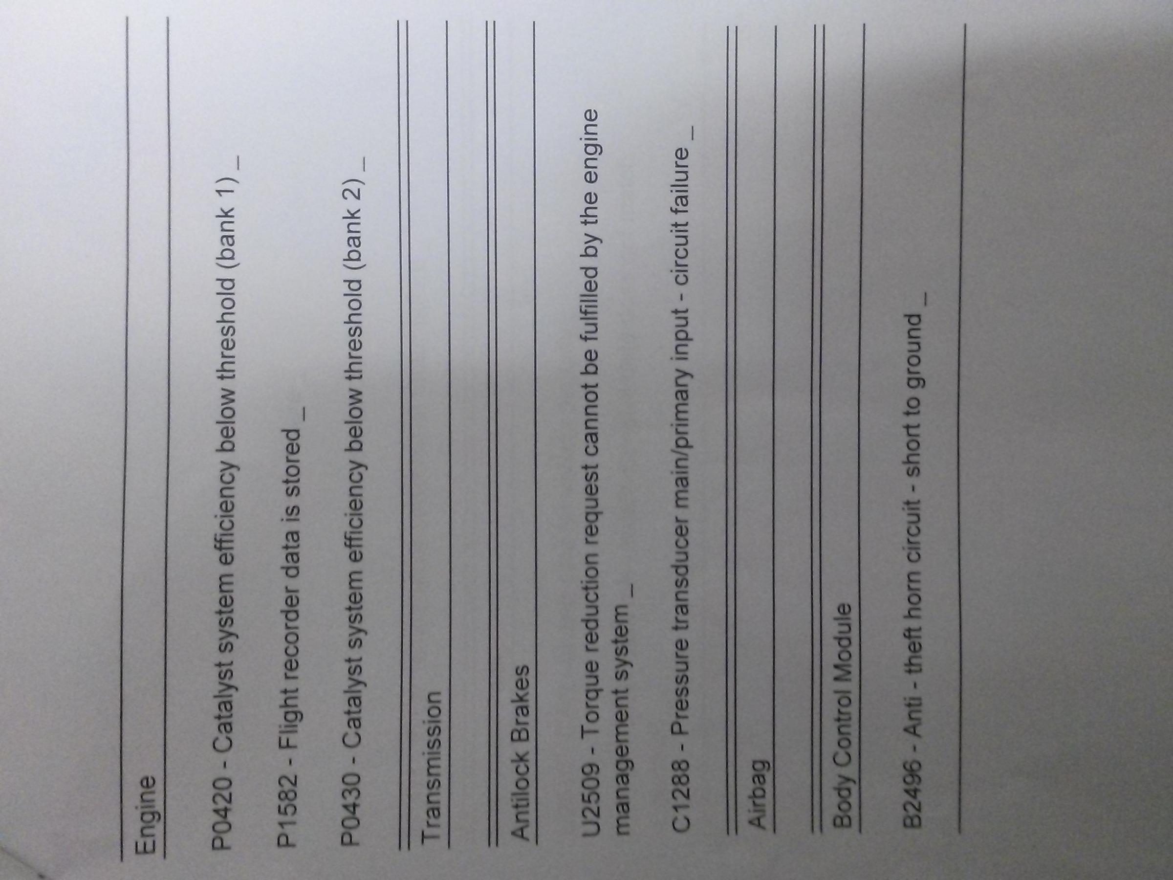

Attached is a printout of a scan done at a shop that works on Jaguars. I was told that minimally the catalytic converters needed to be replaced, but the price they wanted was more than the car kelly blue books for in mint condition (found that to be odd, especially since a google search finds some brand new around the 100 range each...) They didn't mention what exactly was wrong with the brakes. They said it would take 10 hours just to find out...

Before spending money on a catalytic converter, try replacing the O2 sensor.(The lower one against the firewall). Garages are so quick to tell people that their converters are bad. As far as your brakes, not sure. Could just be a vacuum leak by your booster. Seems like they break very easily.

I had the same problem with P0420. Replaced the senor and still had the code. I then put a spacer on first. Code never came back. It's been over 2 years now.

O2 spacer definitely works - but be aware that the problem still exists - you just fooled the computer into thinking there is no problem - your emissions are still high and if there is any compromise such as blockage - you may damage other parts of the system - fix the problem asap.

I gutted the cats and put a spacer on the two 02 sensors that are on each cat. CEL is still on. Will scan and report. Something else I noticed after doing that is every once in a while I get a yellow light and display says cruise not available or something like that..

If you have the ability to remove the cats you can boil them in water and citric acid powder--I did both of mine two years ago still runs great and no codes--replaced all O2 sensors first, all o rings on manifold and new plugs and no help the codes always returned until I took off cats...total cost was $160 to do both cats : $40 for 5 LB citric acid powder, $20 for propane tank (did on outdoor grill) and $100 for a 60 qt pot (you need this size for rear cat) boil each cat separate for 8 hours with half the citric acid in each batch and that's it ..
