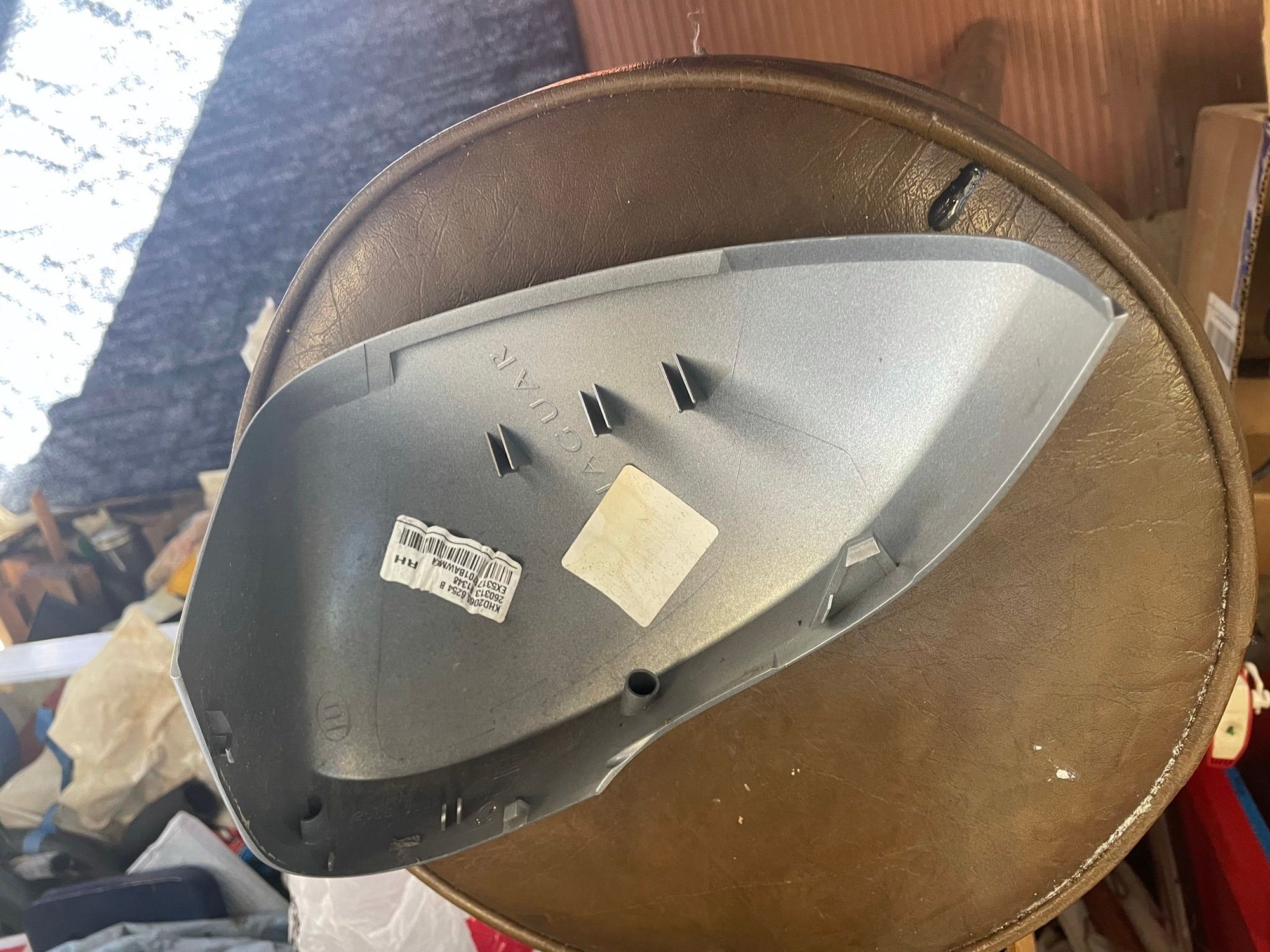

Does anyone have a photo of the tabs to see if maybe part of the tab broke off? I have searched the internet and not found any pics of the underside of the cap.
Old Apr 25, 2024 | 01:53 PM
Carbuff2's Avatar
Joined: Aug 2018
Posts: 2,264
Likes: 932
From: Exit 30 in NorthWest NJ
HTH. The angle wasn't perfect to see the shape of the 'clips'.
I took a few other but they were not any better
Old Apr 25, 2024 | 02:14 PM
BruceTheQuail's Avatar
Joined: Sep 2013
Posts: 4,113
Likes: 1,399
From: Gold Coast, Oz
I put those sequential signals in myself recently. When putting the caps back on from memory I lined it up along the top and pushed it to join there first and then clicked it in at the bottom. Argh, or it might have been the opposite...
Old Apr 25, 2024 | 04:18 PM
Whatsnext's Avatar
Joined: Sep 2020
Posts: 596
Likes: 133
From: AZ
I am trying to see the small tab on the short side of the cover that goes closest to the window. Is that tab just straight and no extension that goes under the slot it lines up with? It appears so with your photo above which also appears to look just like mine which means the only broken tab on mine is the small one in the middle which shouldn't create the issue I am having. The driver side popped on without issue so clearly I am missing something or broke more than just that middle tab but again doesn't appear to be the case.

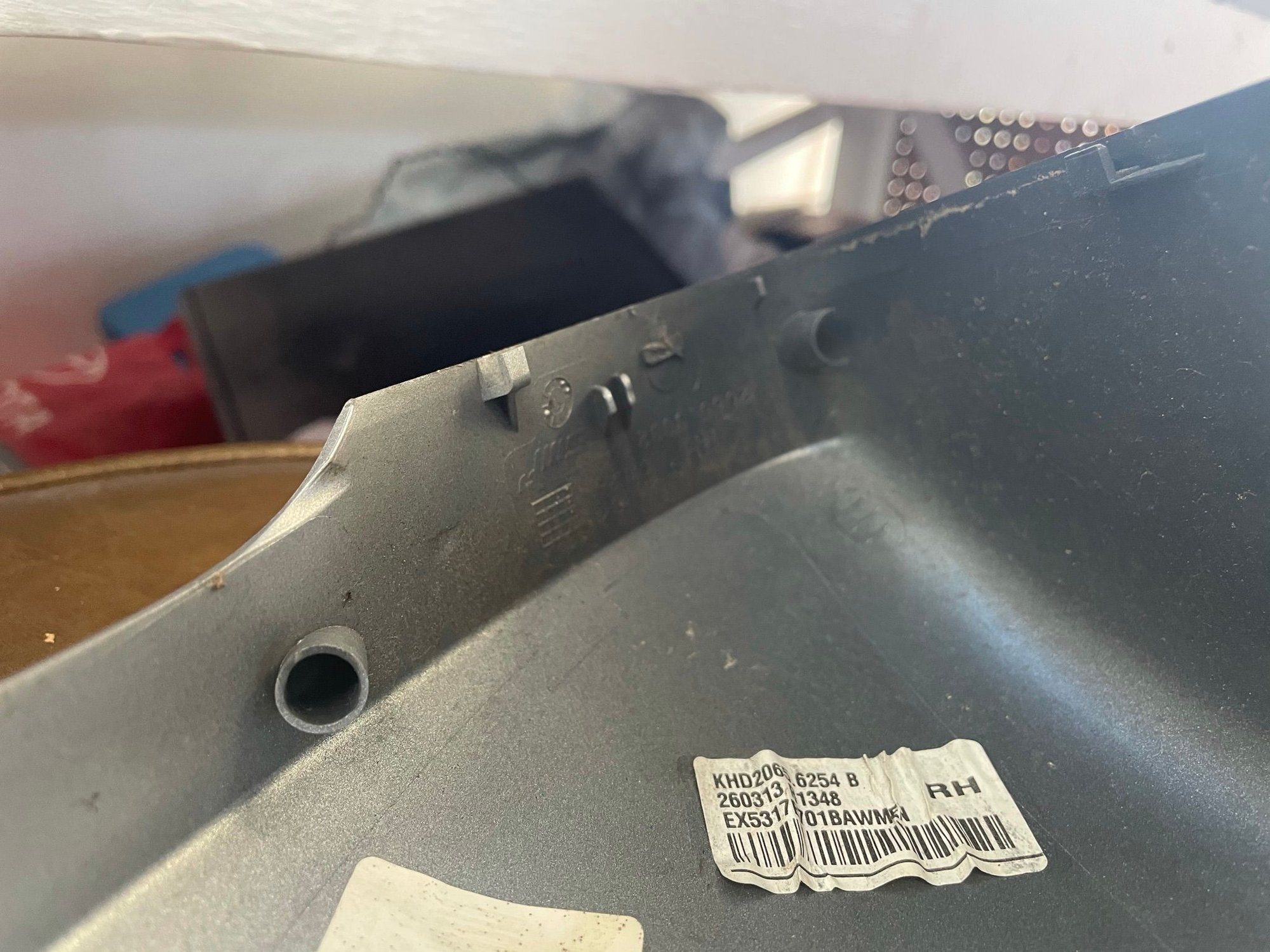

I think this shows the tab. If you look closely it is L-shaped.

I must have snapped the small tab off but odd from your prior pic (if it is the same mirror cover) doesn't seem to have the tab (L) piece on it but yet this photo clearly shows it. And Valerie said how she had to put the tab in the slot first and snap it down. I did watch the videos prior but don't see anyone angling in the tab and then snapping the rest of the cover on. Seems like they line everything up and it "pops" in. If I recall that is how my driver side went in and is on tight. I appreciate the pics and put some 3M double sided tape under the cover and it seems on tight. Thank you
