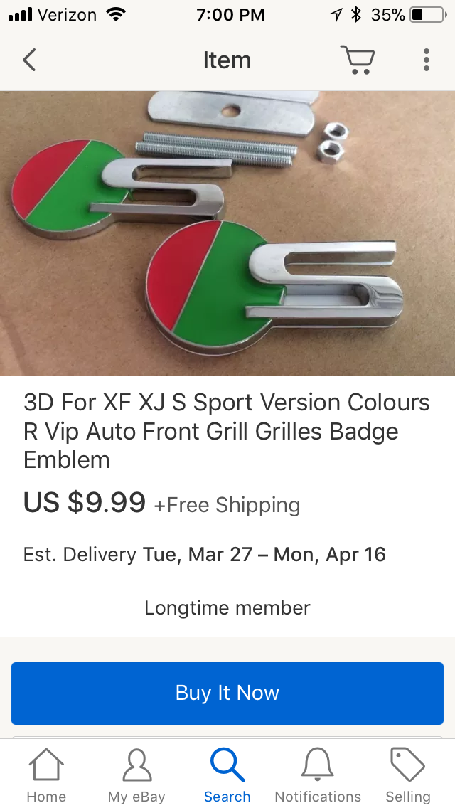

This is slightly different as it has nuts but you could substitute a wingnut.
Attached Thumbnails How to mount the "S" emblem on the grille-de91f910-9637-4584-8fae-9d76a1291e08.png

Or else you could do what I did to stick an "R" badge on the grille of my old XFR (2010 model so it didn't come with the badge from the factory):
1. Buy an S badge like that linked above.
2. Get a tube of black RTV silicone sealant, preferably windscreen sealant
3. Decide where you want the badge to be
4. Fill that one hole in the grille mesh with sealant, leaving it a little proud of the surface (the sealant is thick enough not to run out the back of the hole)
5. Put a small dob of sealant on the back of the badge
6. Press the badge into place, and hold for about two minutes, making sure it is straight
7. Clean up any excess with a soft cloth soaked in mineral turps before the sealant cures/sets
This worked a charm for me and the badge never budged a micron.
