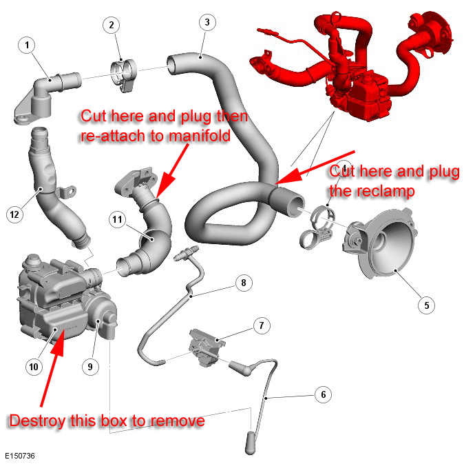

Funny...I did the opposite...You essentially recreated a simplified version of the Jaguar Symposer...I tore mine apart and removed it
Sounds like you are enjoying it, so great. To each his own.

Could you take the existing symposer tube and connect it as Sparayno1 has to the inlet and get the induction whine through that?
Possibly, but you would need an extension hose (like he used in the video), and the Symposer currently connects to the passenger/right side intake. It is built with a diaphragm to modulate sound, and I imagine tuned to the output and pressures produced from that intake outlet (it is not just an air tube listening for sound)…
So I guess it is possible, but not sure what sound it would create. You could also just disconnect the Symposer and connect that hose in the video straight from the intake, to the resonator in the firewall - Maybe that is what you meant? (#5 in the image is the resonator BTW)
As I said...I think I had/have plenty of noise from the front/engine, and rear/exhaust anyway...And with the VAP Cats/pipes, I cannot hear anything else anyway
