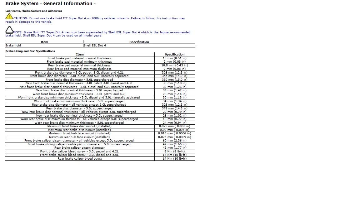

Any idea what the min and new thicknesses are for OEM pads? I found info on pads for CCB brakes in OzXFR's shop manual, but nothing on the standard brakes. I've never measured pads myself, but may give it a shot.
When I had my previous set of tires put on, the guy put his iPhone in video mode, and was able to get it in far enough to look at the pads that way. Nice trick.
Yep, strange that those specs aren't shown in the F-Type Workshop Manual.
But all is not lost, I still have a copy of the 2010-2011 XFR manual and the XFR has the exact same brakes as the F-Type "super performance" brakes, 380 mm front and 376 mm rear.
According to the manual the brake pads thicknesses are:
Front - 13 mm "nominal" (I presume that means "new"), minimum 2 mm.
Rear - 10.8 mm, minimum 2 mm.
Anyway, here is a copy of that page from the Manual:
Remember, these are the specs for XF brakes but they cover the same 380 mm and 355 mm front brakes and 376 mm and 326 mm rear brakes as those on the F-Type so I believe the basic specs would be the same.
