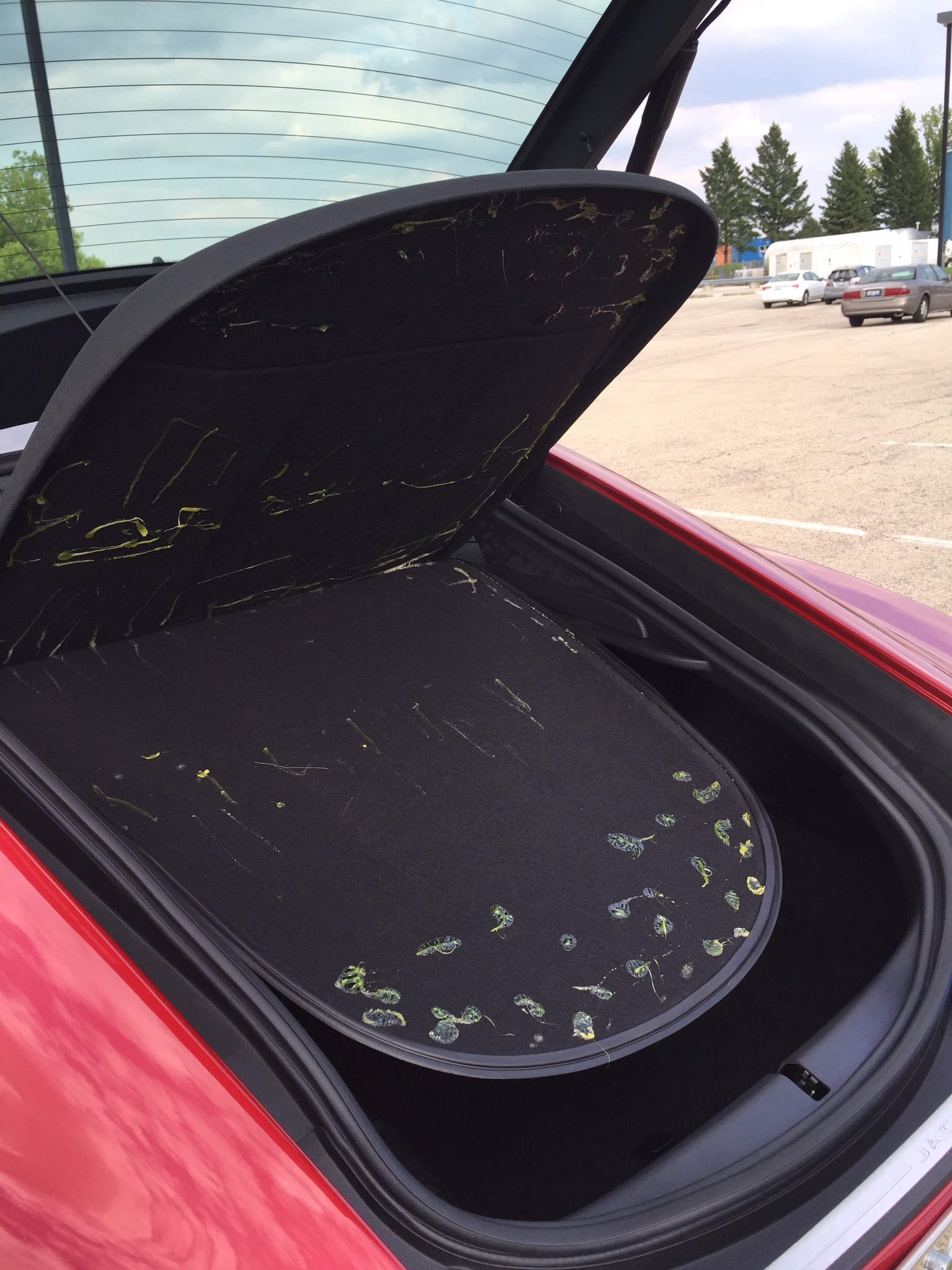

Default Rear deck lid carpet separation
I'm in Illinois and I have a 2015 R coupe. Came out of work and found that the carpet on the rear deck cover had separated from the plastic top piece. Glue failure when the outside temp was around 90F. Dealer applied a new adhesive per a Jaguar technical note. Haven't had a problem since.
Old Oct 12, 2015 | 06:13 PM
  #244
Timbo's Avatar
Joined: Jul 2014
Posts: 394
Likes: 102
From: Ruislip, London
Same thing happened to my parcel shelf, 3 times!!!
They reglued it twice and the 3rd time i said i wanted a new one, my dealer spoke to jag and they said yes, no problem since.
