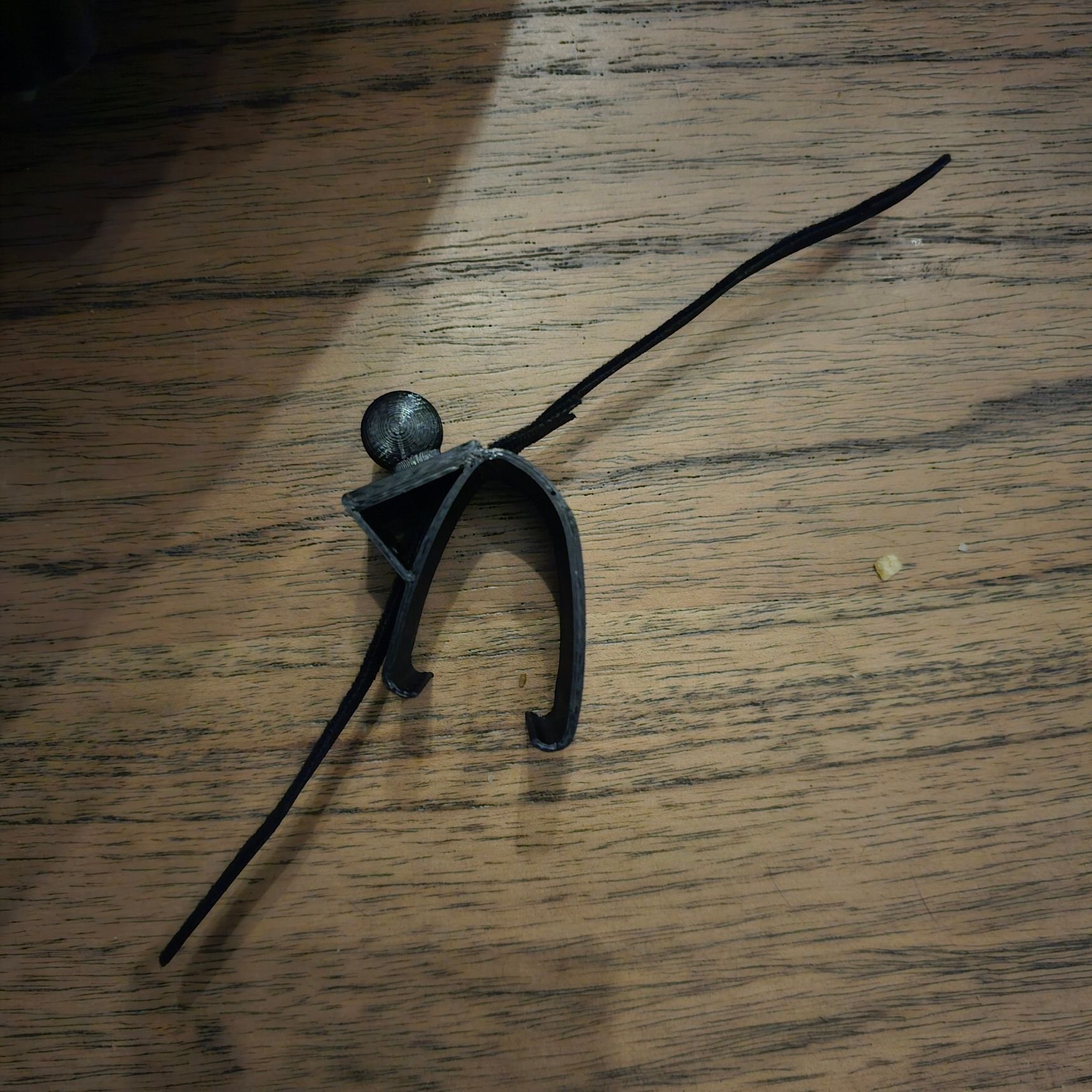

I went through many threads on forums and Facebook pages looking for ideas to mount a phone cradle in the car. Where I live, if you answer a call while driving the phone must be in a secure cradle.

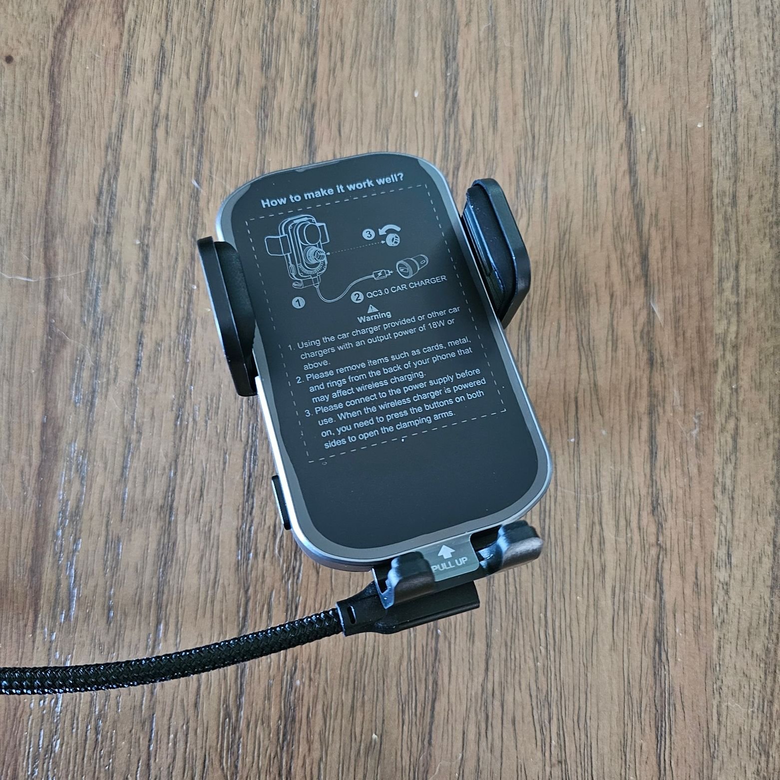

In the past I've used magnetic mounts, which look sleek and elegant - until you hit a bump and your phone slides off. I wouldn't want my phone to go flying in an accident when I would need it, so I started mounting these motorized grippy boys in my cars. They automatically grab the phone when I place it in the cradle, hold the phone solidly in place and charge the phone as I drive, and with the tap of a button they let go.

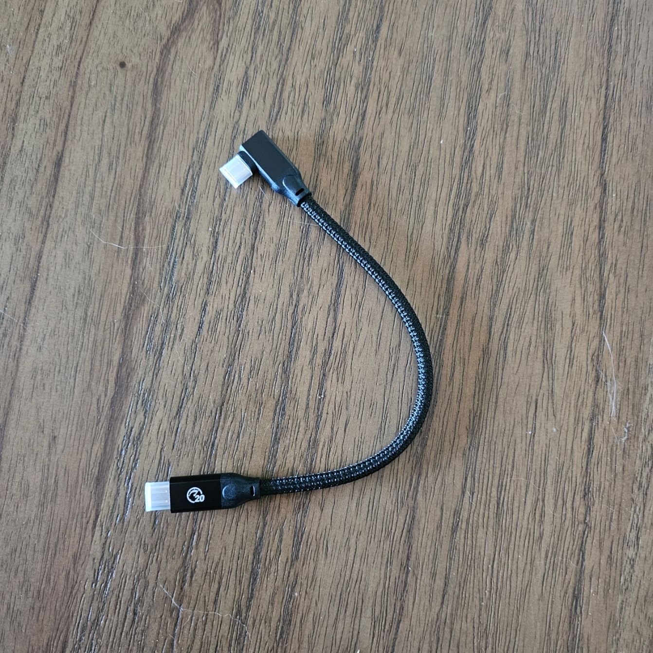

I usually pair them with a 6" USB cable with a 90 degree end so it doesn't hang straight down.
But I usually make a custom mount that bolts the 17mm ball, that the phone cradle snaps onto, firmly into the dash. But the Jag presents a challenge. There's little dash space to elegantly mount the ball, and even if there was I didn't want to drill into it.
So instead I 3D printed this plastic mount that clamps onto the HSH, while doing so high enough that the passenger can still use the handle. It has slits in it so I could pass velcro cable ties through to pull it snug so it won't slide down or unclip unexpectedly. This is a first go, using a file I found online. I already have ideas on how to modify it so there's more range of motion for the cradle to tilt to other desired angles.
