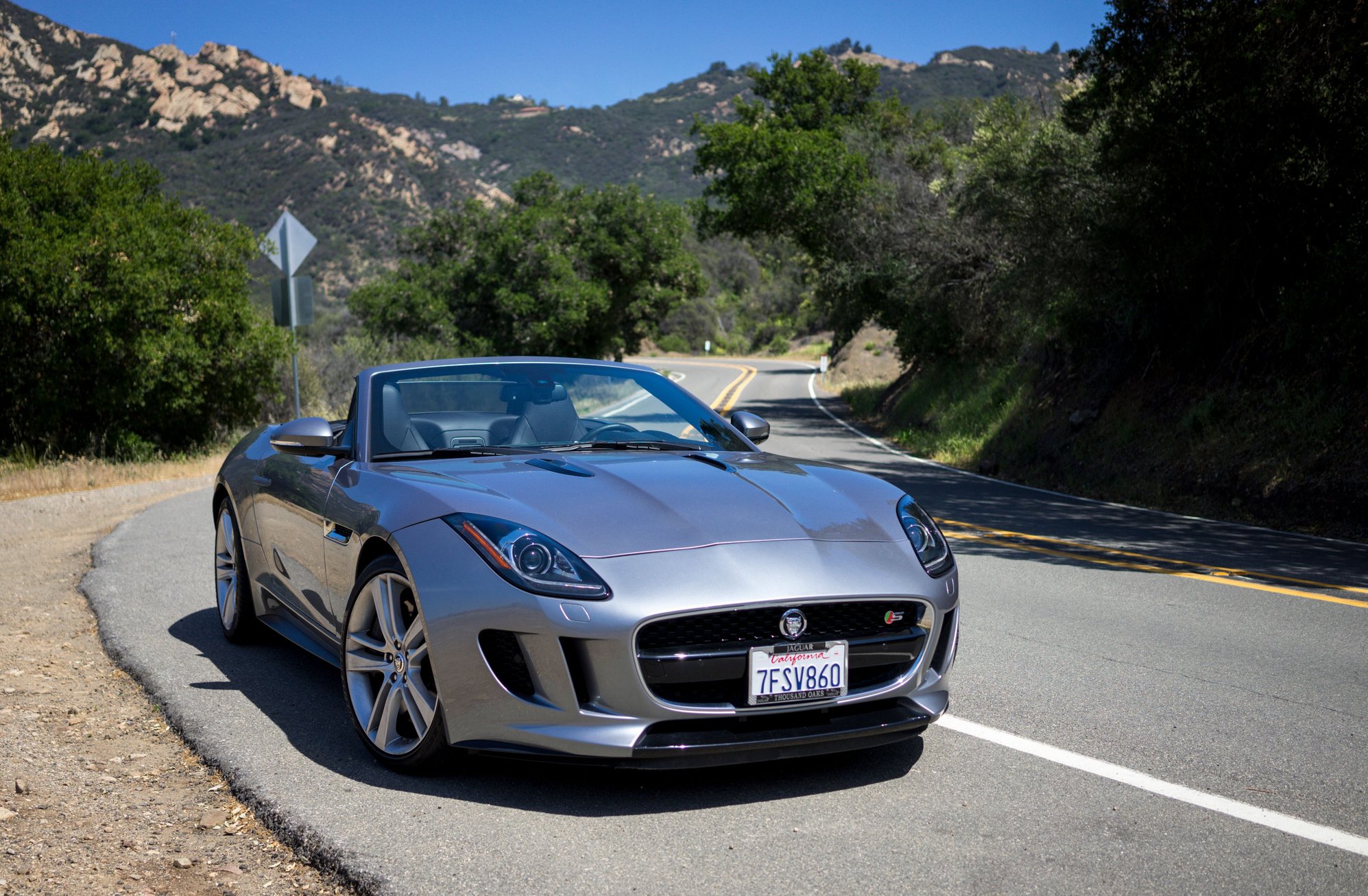

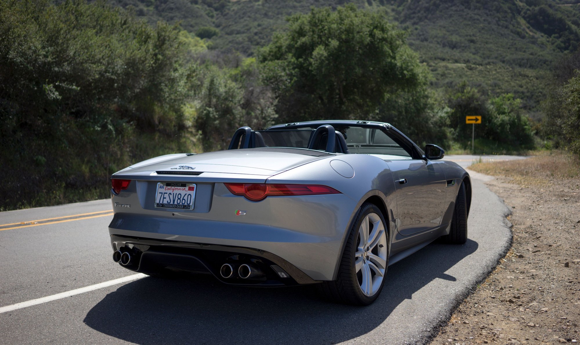

Hey Mike, love the red F-Type in your post. Here are a couple of pics of mine!

Gorgeous! Love the convertible.
