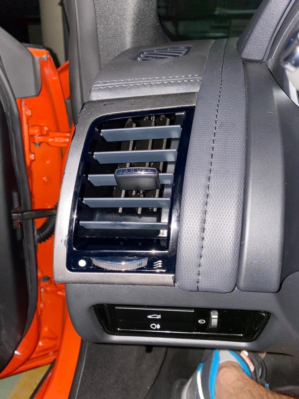

Hi Guys,
I would like to remove the air vent / grill next to the steering wheel to replace it.
THe trim / frame is scratched.
I started to pull on it and the bottom part comes off but i am scared to pull further.
Anyone can help me explain how to do?
I got a V8s 2014
here is a picture

Thanks but i really cant figure out how to remove it after the bottom part. Where is the screw if any ?
Thanks for all the help you can give.

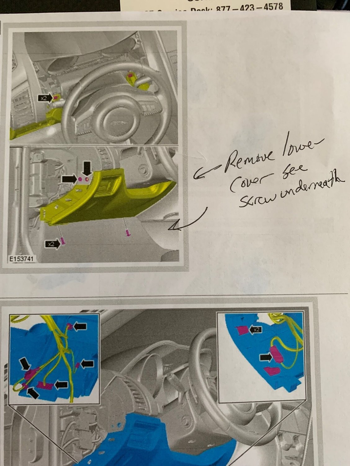

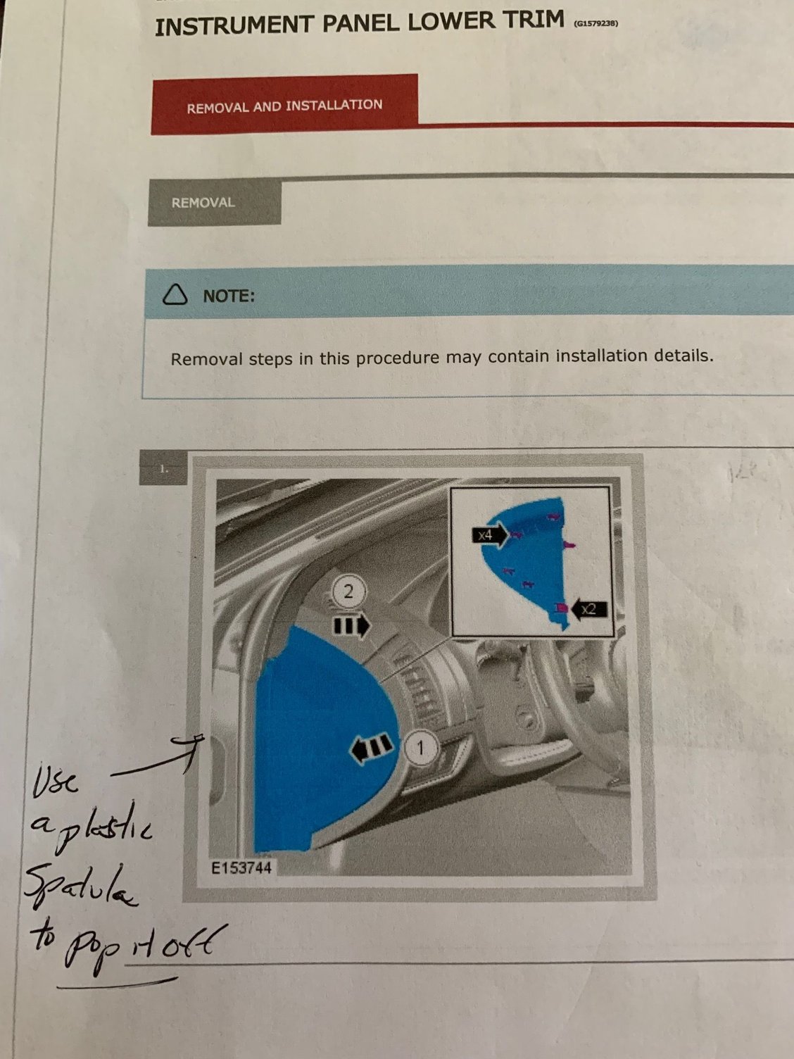

Per my PM to you. Here are the instructions
First remove the side cover
Then remove the bottom. There are two side screws and two bottom ones
Then remove the actual vent screws and remove
ABR
