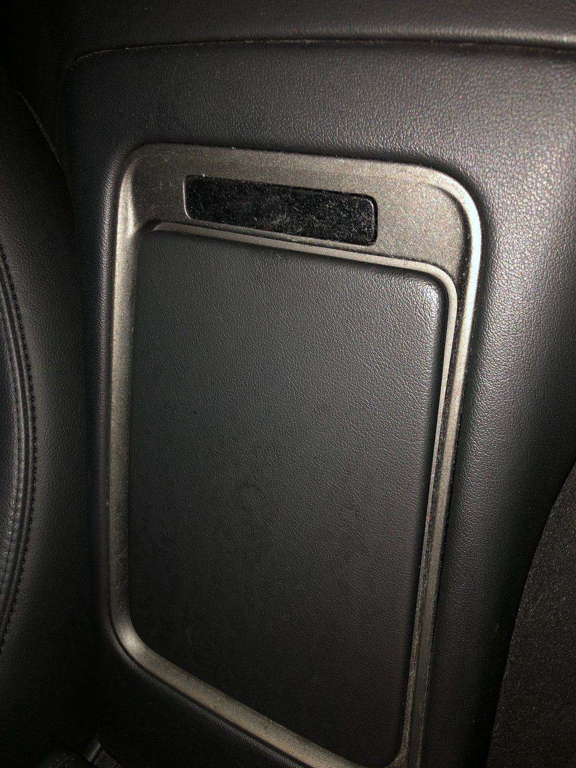

Hello, I'm new to the forums and this is my first post. I just recently picked up a 2014 F-Type convertible, I love it, but its got the dreaded sticky dash bits. I want to systematically go through the car and thoroughly clean the soft-touch finish from these parts that are afflicted. So far I have done my research and looked through the manual and found out how to get some of the pieces out, but I am having trouble with a couple and was hoping a knowledgeable member could give me some guidance.
1. Side vents: I know you can pop off a panel on either side of the dash that the doors hide to get a side view of these vents but beyond that I am lost, is there a procedure anyone knows about to remove these?
2. Rear cubby surround: I know you can take out the roll hoops and then lift this piece out of the car, but I wasn't sure if all that was necessary and I could just use some trim tools to pop this surround out?
Any help would be appreciated guys! Thanks!

I pieced together parts of the manual that pertain to the disassembly of each. I’ll post them here for you Sunday night and some extra tips from my own experience when I’m back in front of my computer. The vents were not so bad. But unfortunately the cubby surround you do have to remove the roll hoops and the entire back plastic to get at it. I did the 770 watt amplifier upgrade (via Cambo) while I was in there to make it more worth it.

Attached is the relevant instructions I pieced together from the manual for the center cubby on a convertible. Regular ammonia works great for removing the sticky coating and NOT the labeling underneath. No soaking, just pour some on a rag and start wiping then rinse with water after.
It is relevant to note that the gunmetal color will be removed only on the steering wheel bits and air vents when stripping the sticky coating, underneath is a glossy black you can get away with having on the interior but you may want to prepare to wrap them while they are out if you are ****.
