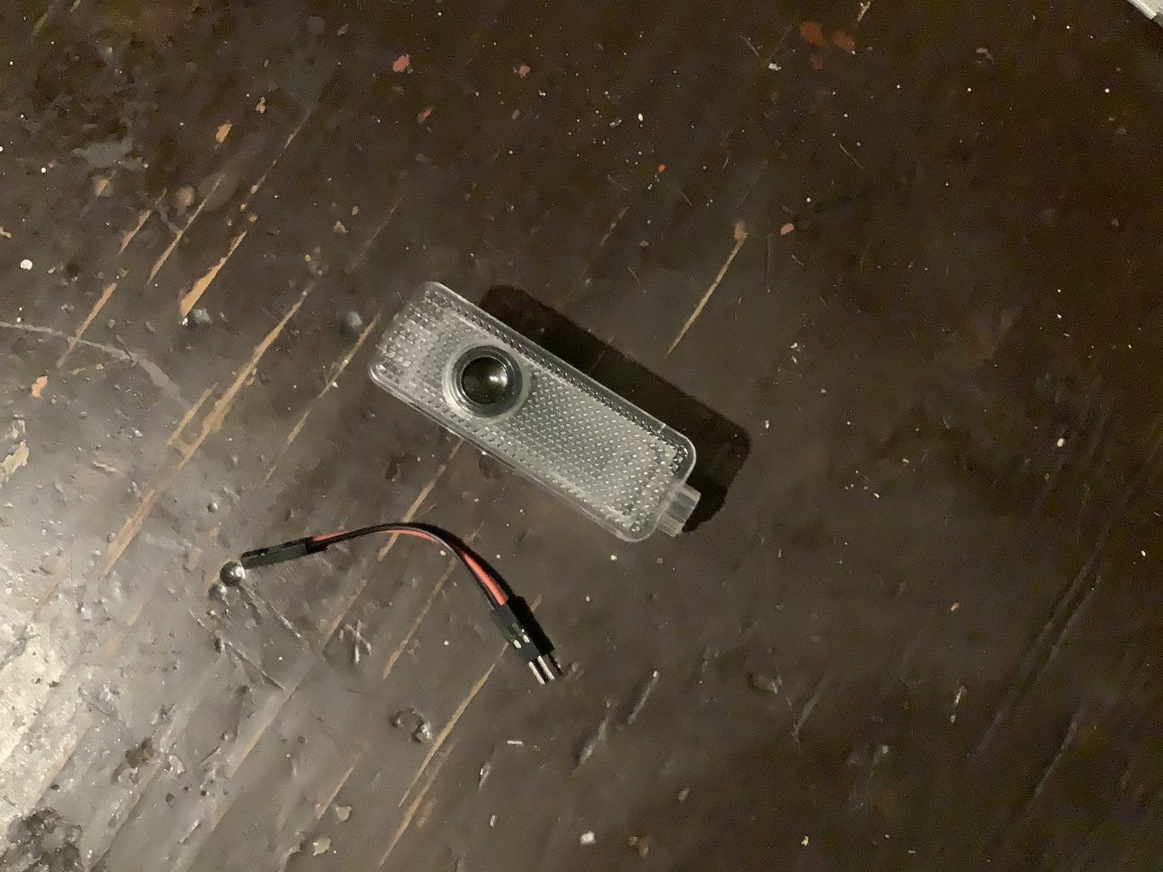

So, let’s try this again. You have the housing dangling outside it’s receptacle with the bulb removed. Grab the light assembly where the bulb was in and just twist that black socket counter clockwise and the harness will pull away from housing. Now, on my puddle lights they came with wire extensions as shown in the photo below, and I chose to use them so that I would not get any wires crimped when I placed the puddle light inside the door. If you need a picture of the original socket I can dig my old housing out and post it here. Hope this helps….
Puddle light with extension.

So, let’s try this again. You have the housing dangling outside it’s receptacle with the bulb removed. Grab the light assembly where the bulb was in and just twist that white socket counter clockwise and the harness will pull away from housing. Now, on my puddle lights they came with wire extensions as shown in the photo below, and I chose to use them so that I would not get any wires crimped when I placed the puddle light inside the door. If you need a picture of the original socket I can dig my old housing out and post it here. Hope this helps….
a
I think we have our wires crossed here!
(terrible pun fully intended)
So far I have fitted three sets of the logo puddle lights and they all look much the same as the pic you have posted, with the exact same wiring piece.
Like you I used those pieces to prevent the existing wires from being stretched or crimped.
I was simply trying to differentiate between removing the globe and/or the wire from the OEM housing and fitting one of these logo lights, as the method/procedure it entirely different and could confuse the OP. And before I replied to him I fished out my OEM lights to double check, and lo and behold they still have the multi-chip SMD LED globes I fitted in them.

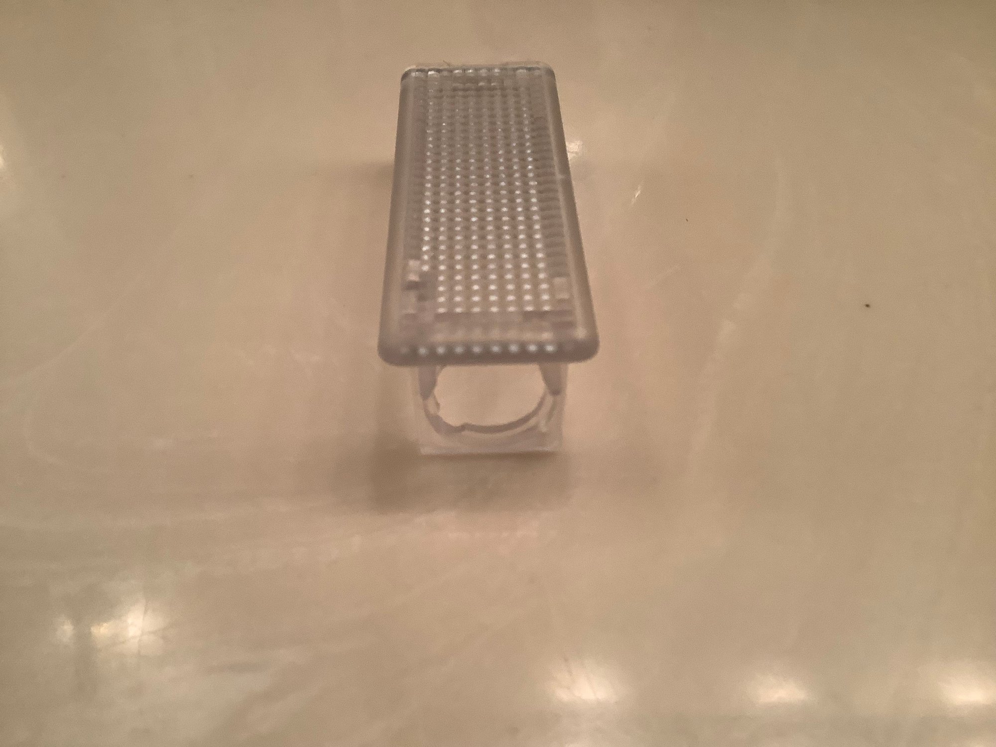

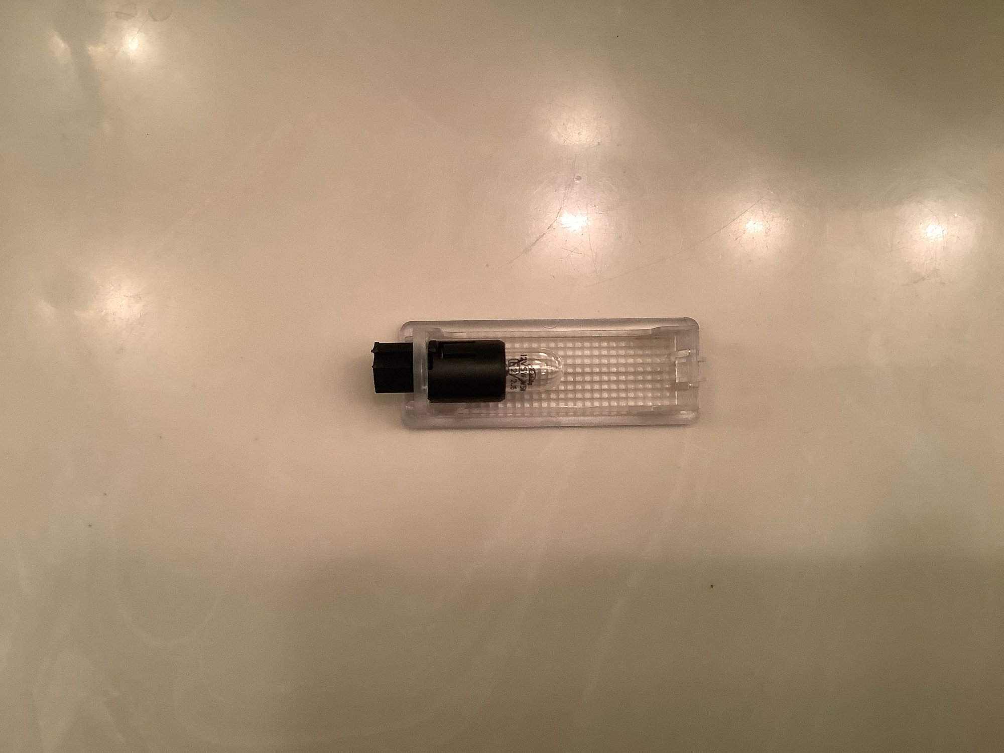

Ok, third time will be a champ…..
This photo shows the original light assembly with original bulb…..

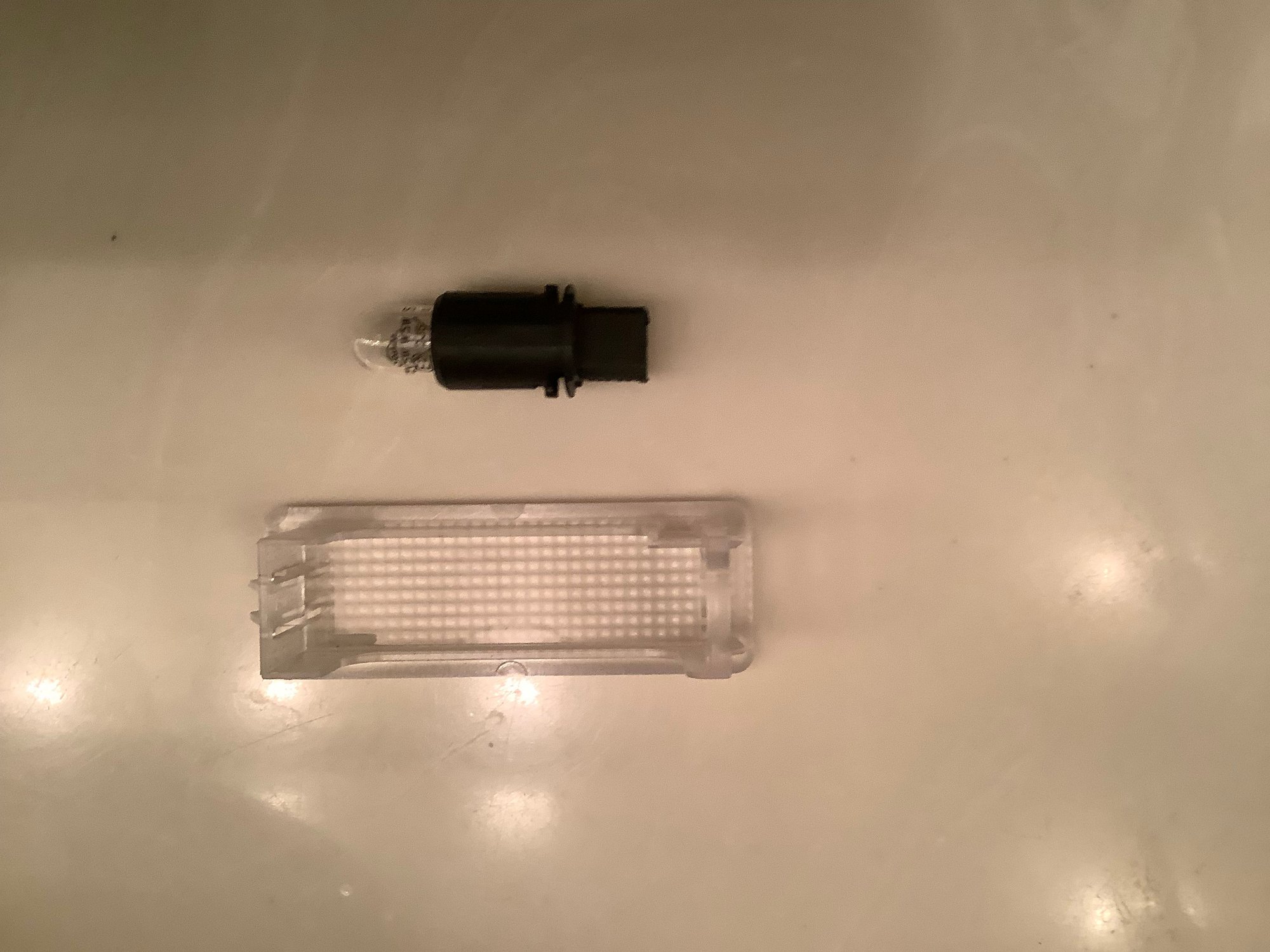

To remove the black bulb housing you must twist the black bulb housing counter clock wise and you can pull the housing out of the clear plastic receptacle as shown below.
The clear plastic receptacle will then look like photo below…..
OK, are we now on the same page?
Yes, I did exactly that to replace the OEM bulb with an LED.
But as I keep trying to explain, there is absolutely no need to do that to replace the OEM housing (and bulb) with one of the projector logo lights in question, in fact it would be a waste of time and effort. All ya gotta do is pull the existing "square" wiring plug out of the OEM fitting and slot it into your new projector logo fitting.
