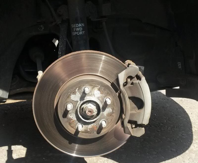

Here's a before of my sons X type Sport, rusty and generally horrible, both the hub and the caliper.

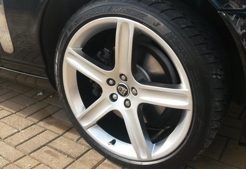

Hubs painted using Hammerite smooth silver and calipers Hammerite smooth Black for results as below.
I guess it could always be a good stop gap at least to make the car look so much better until time / money / transport allows...

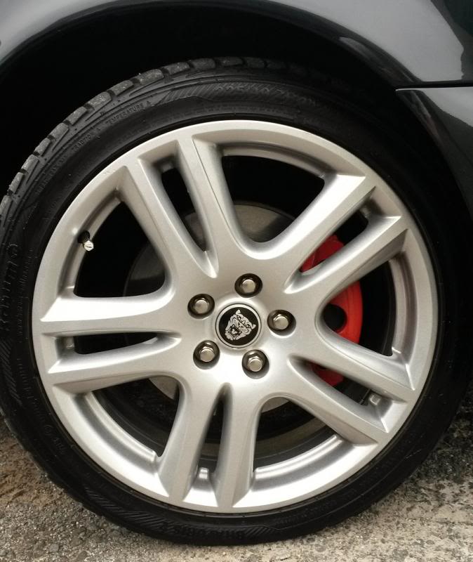

Just heard back from dealer and they are going to replace all the callipers .
Was asked how I washed it ,and they said to only use Jaguar approved cleaners ,which they have said they will supply me with !!
Deffo will not upgrade them even if I was to pay
Burnie

New callipers fitted but they used original silver centre with jaguar on it.<br/>Treated the wheels to some red centres<br/>After picked up had to go back as pedal was spongy they re bleed them and second time ok. Bit peeved they didn't get it right first time though<br/>Burnie

Looks good. Mine have managed to stay that way after almost a year. Hopefully, yours will too this time.
