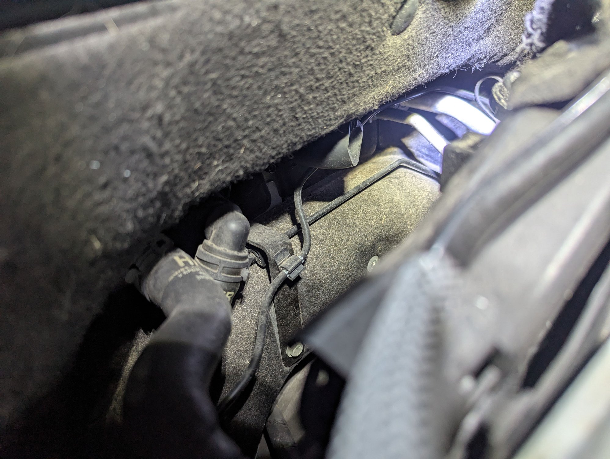

Third, I was looking behind the supercharger in the engine bay and noticed a tube that was cut and seems concerning. If someone could snap a picture of what their tube goes to that would be a huge help!
Tube that looks cut behind the super charger
I'm not trilled about some of the mods I'm seeing. It does have a after market exhaust which is very loud. I can get more info on that if it's helpful. Also there's codes that come and go but i'll deal with that after the damage is fixed.

Second good news: The cut hose is part of the symposer system. Do some searching here and you'll learn more. In short, it takes sound from the intake manifold, conditions it, and pipes it into the cabin through that hose under certain conditions. If the rest is removed or disabled properly there's nothing to worry about. With an aftermarket muffler you wouldn't hear it anyway.

The pipe could be the transmission vent that’s been discussed recently. Maybe.

Here’s a thread about the transmission vent, you can see if that’s what your pipe is.
https://www.jaguarforums.com/forum/f...ne-bay-289132/
