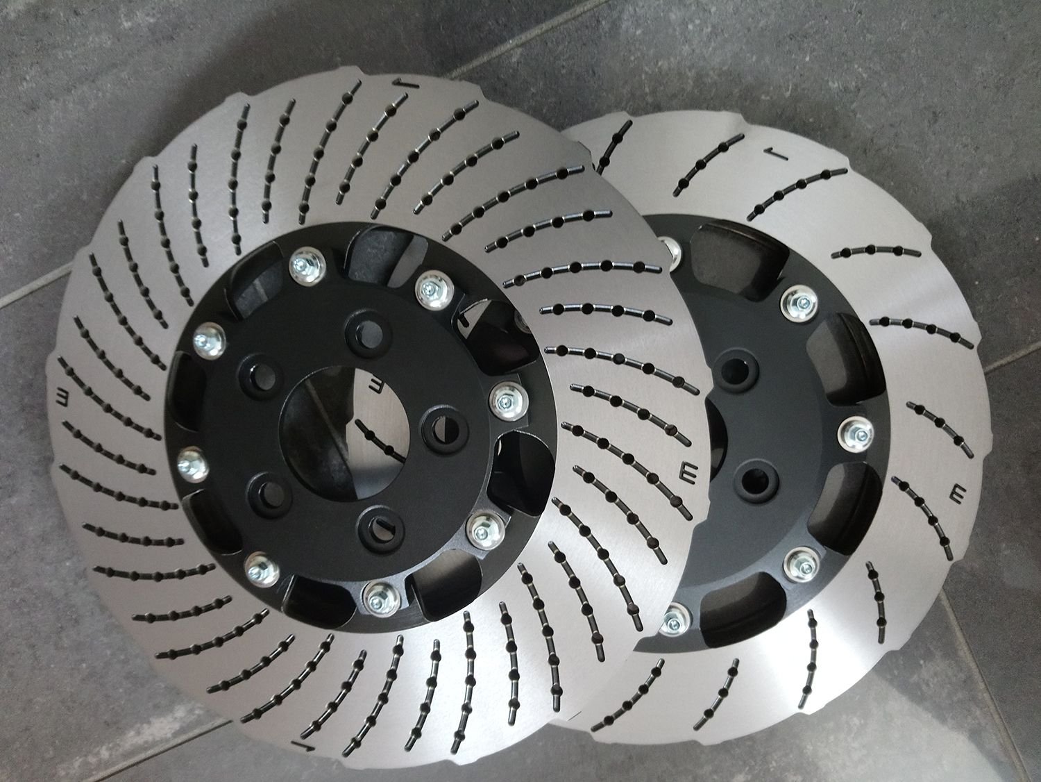

If you want to upgrade your brakes, consider the Wortec 2 pc. rotors:
Better cooling, better looking and close to 40 lbs less unsprung weight.

The Wortecs with OEM calipers weigh in at the same weight as the OEM CCB brakes.
