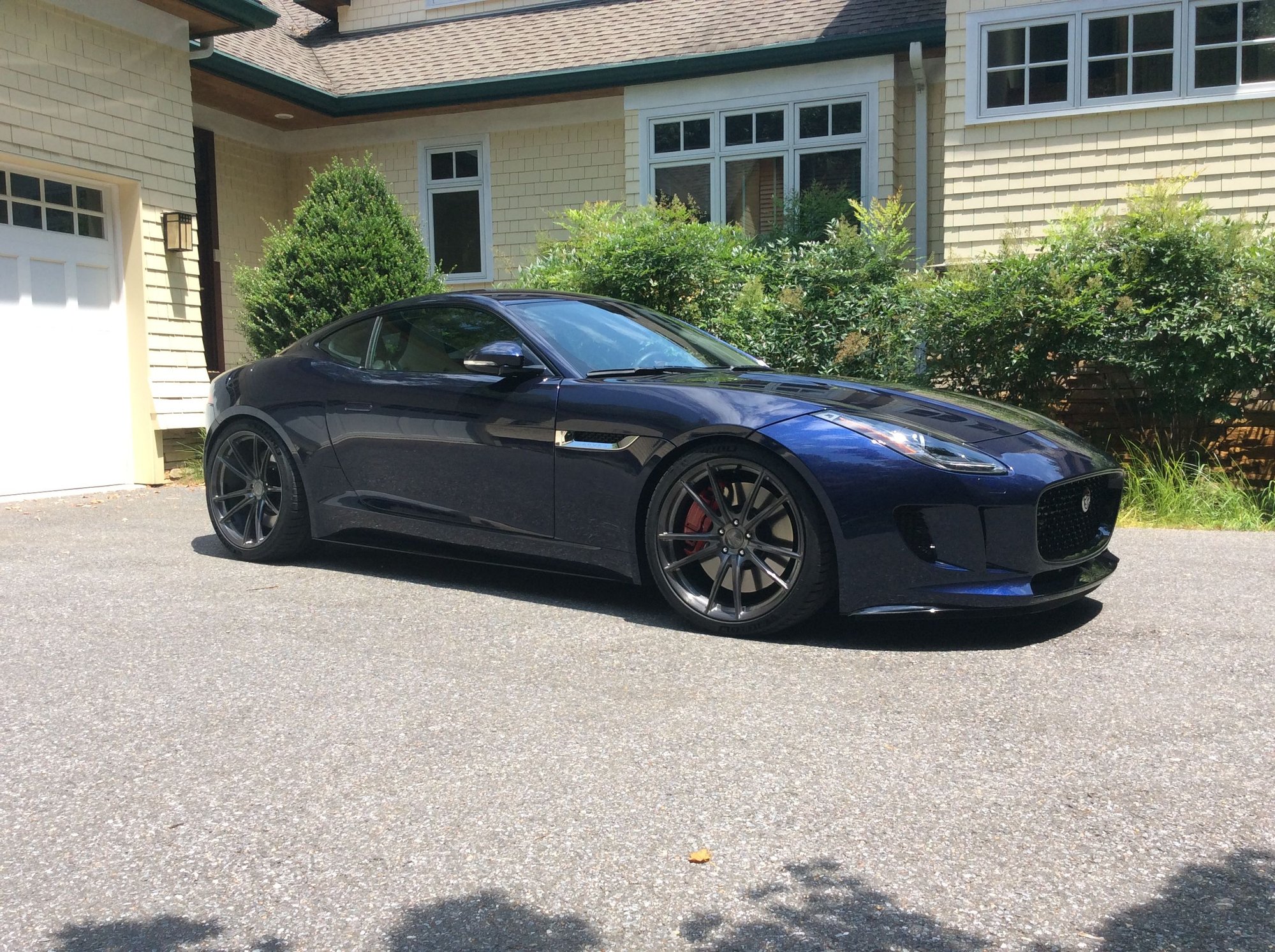

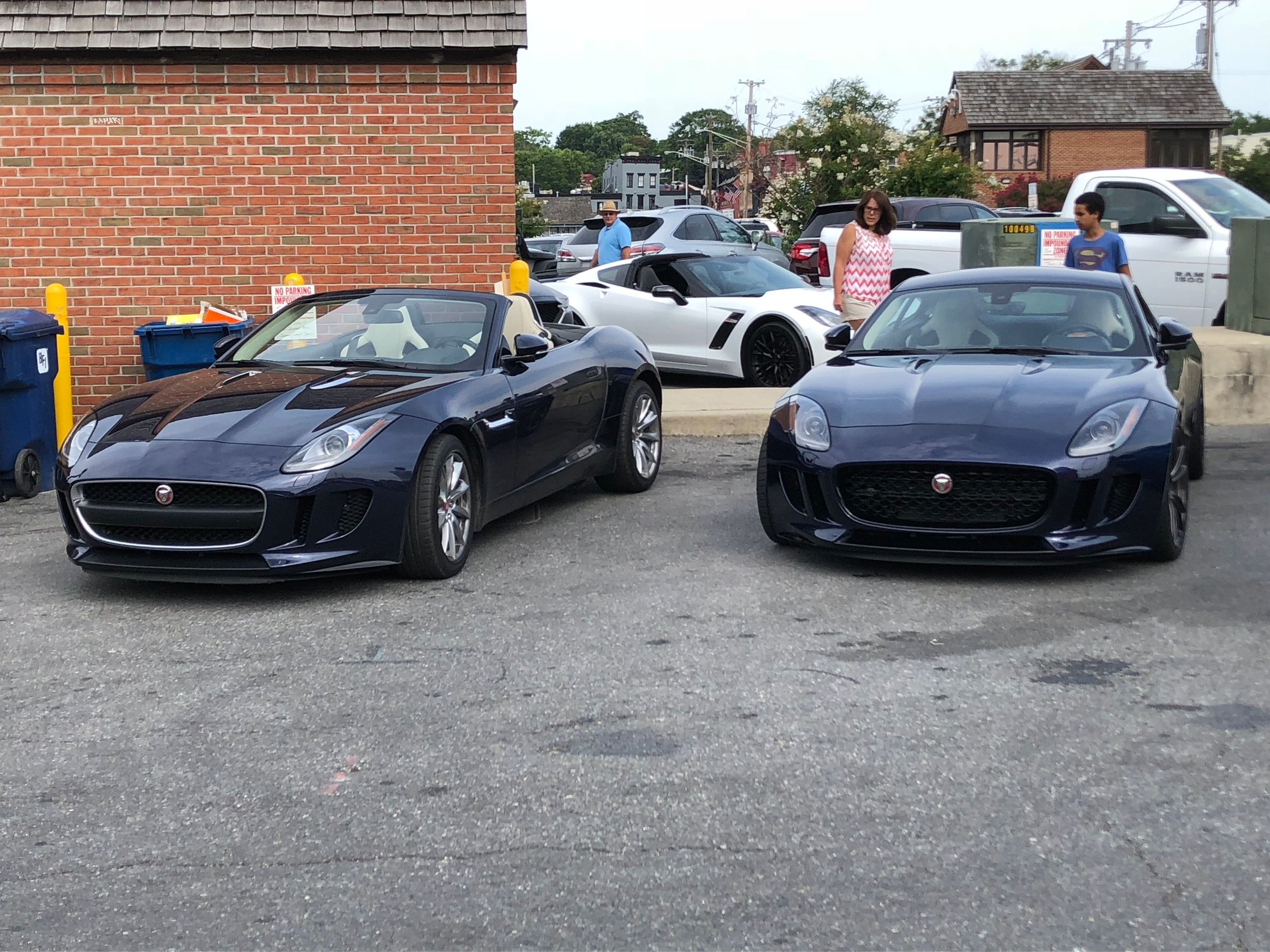

Here’s a 2015 F Type R on H&R springs for the V8, and a comparison pic with a stock car. Don’t let the pic of V6 springs mislead you .
