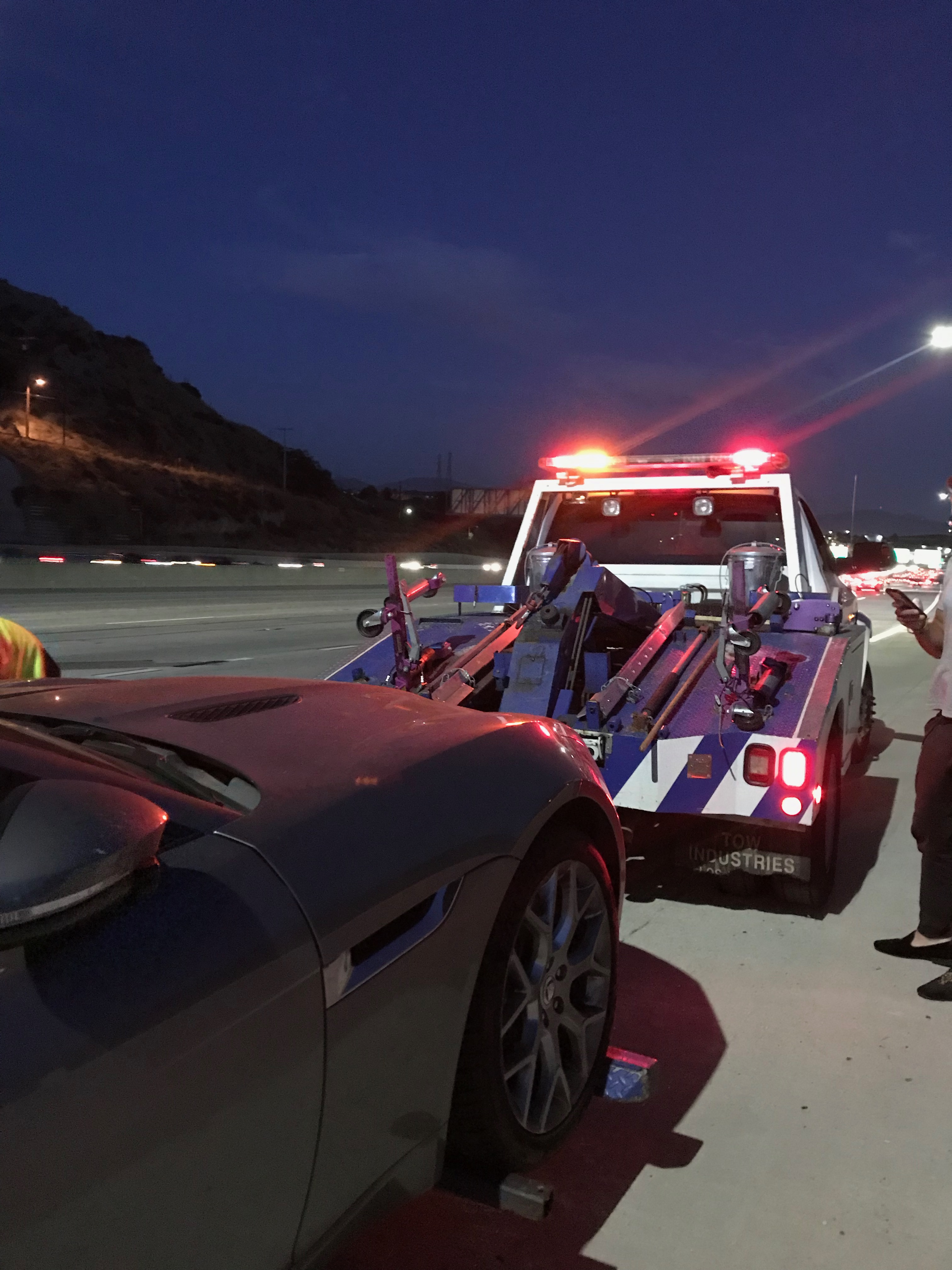

Cruising back from SF to LA — been moving pretty quick and it’s pretty hot out — 20 miles from home got a nasty exhaust leak followed 30 seconds later by a flashing CEL — immediately pulled over to a serious smoke screen (black) — smelled pretty bad of fuel
Won’t restart (pretty significant fuel smell)
Codes for misfires, both o2 sensors, and a couple jag specific codes my little code reader I leave in the car can’t read
