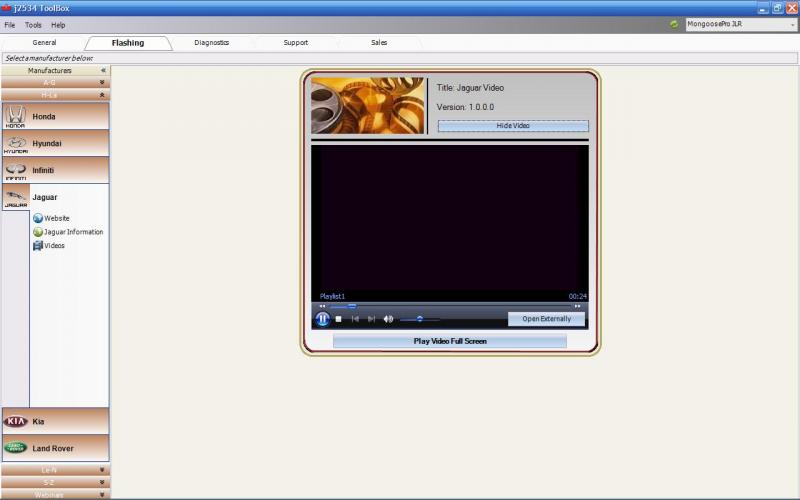

yesterday and loaded the software today. I bought the Drew Tech. Mongoose JLR. I thought that this pass thru adapter would be just Jag/Land only. Not the case it will interface with most of the car Man. websites but you need a name and password.
So..... for the home guy unless you can find an unlocked ver of IDS/SSD or are willing to pay for access to TOPIx the mongoose by itself is useless. I do think that this has been covered in previous post but I thought I would add it in case someone glossed over that fact.

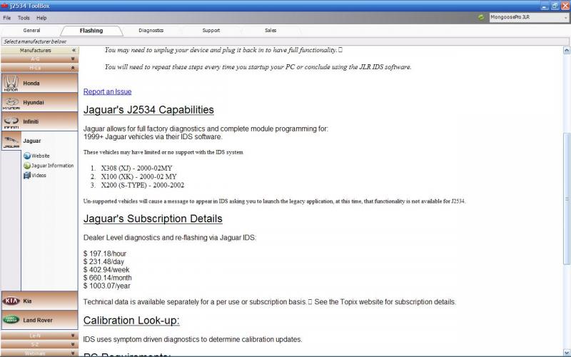

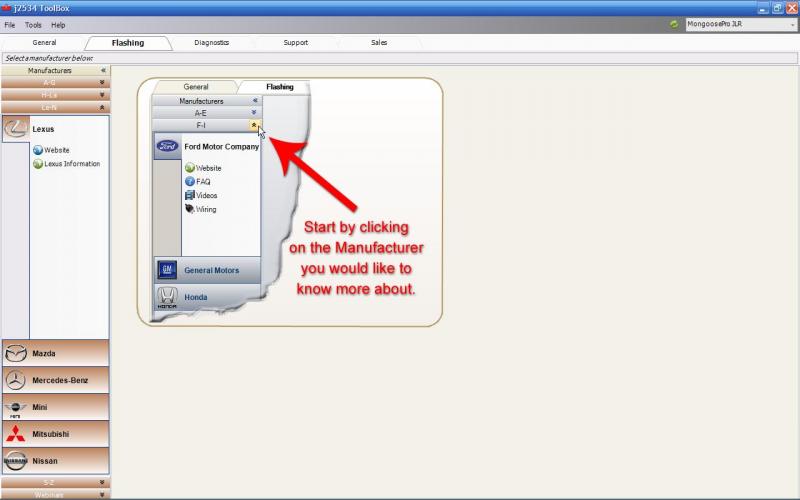

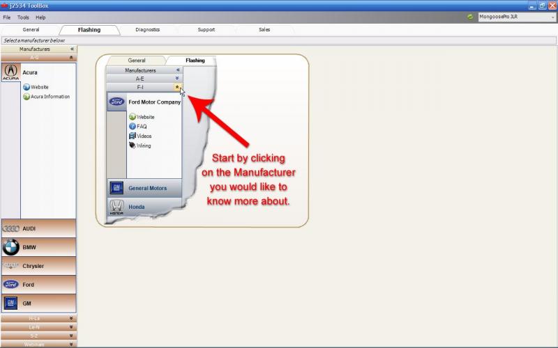

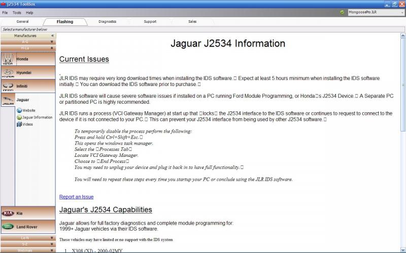

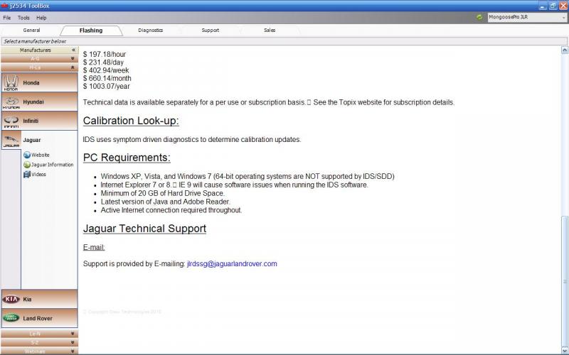

I am waiting on the Ver 127 IDS/SSD software so untill then I'll leave ya'll with a few screen snapshots.

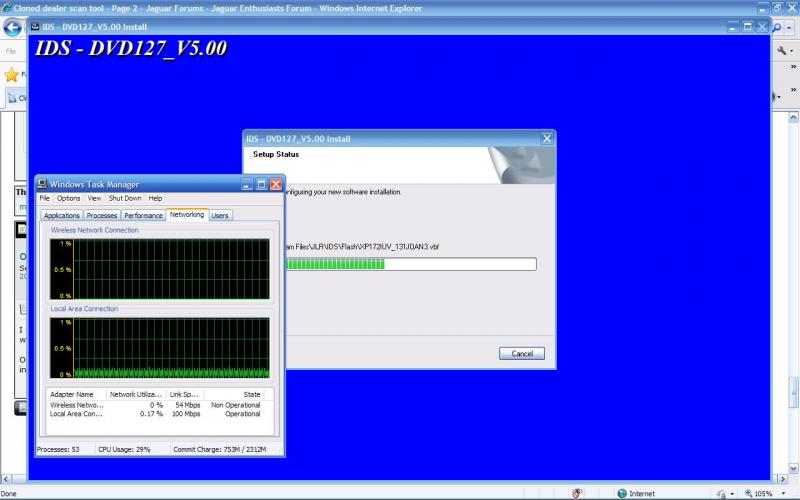

I recieved the Ver127 ofIDS software today from the seller on Ebay. Its still been loading for close to 1:20 min. I don't think I'll have time to play with it on the car this evening.
One thing that is a bit troublesome is the user name and password. Nothing in the package to disclose what it is. I'll have to assume its embedded in the software and will be revealed after setup.
Update: The DOS readme file makes mention to disconnect from the internet after software installation and before actually starting the program. It didn't make mention of actually needing the connection. By looking @ the task manager it certainly seems that is it is using connection for installation.

Everything worked out well. It took close to 5 hours to load and the user name and password was on a readme file on the disc.

Plums,
What is your concern, the cost or the limited support for the 2000-2002 MY? The cost can be avoided by finding someone selling their old version of IDS/SSD. If you have those model years you would be better served by finding someone selling one of the red VCMs.

The concern is that people go into it with their eyes open.
This thread is in the General Tech area. Therefore there is no indication of specific model years due to the area itself.
Given that people do not necessarily open attachments in threads, it is more than possible that someone may go ahead and purchase a J2534 device without realising that they will not be able to use it on their specific vehicle. That is the reason for posting a message with the full sized image of the pertinent screen and calling attention to it.
Jaguar themselves have been less than clear in their PDF document as to the exact level of support for older vehicles via SSD+J2534. The JLR diagnostics support group has been queried by email and an answer is pending. In the meantime the PDF can be found all over the internet by searching for Jaguar J2534.
Note also that the 2000-2002 year references are to build years and not model years.
Please note that all quoted year ranges are against manufacturer build dates and not market launch date - a tolerance of 1 model year should be applied

@ Plums, I recon we both were trying to accomplish the same thing. As far as the cost I had to go back and look @ what was mentioned previously and found that any reference to actually cost was to a Ford VCM for 899 I believe.
"Jaguar themselves have been less than clear in their PDF document as to the exact level of support for older vehicles via SSD+J2534. The JLR diagnostics support group has been queried by email and an answer is pending. In the meantime the PDF can be found all over the internet by searching for Jaguar J2534.
Note also that the 2000-2002 year references are to build years and not model years." Didn't know that!
This attachment may shed a bit more light on the subject of compatablity. I hope this is the one you are referring to.
Eyes wide open you bet. We both are trying to provide the best info. I think your info is more in depth than mine since you have been around Jaguars alot longer than I.
For me though I'll use every bit of info I can find and opinions from actual users and weight that against my needs before I dump hundreds of dollars on anything. I believe most folks will as well.

A couple of things.......
The reference in the J2534 Tool Box 2 screen shot about 'limited support' for 2000-2002 models is only with respect to module flash programming. Those model years cannot be programmed in the field other than for peripheral functions and setup. Contrary to popular belief, flash programming is very rarely necessary unless the mfg. has made a purposeful change in software to correct something. That does happen, but not that often, actually. And once a vehicle is mostly through the warranty period, the software will not be further updated, by then they have moved on to the more current vehicles. The exception to this is of course some update required and mandated for a Recall, as in the J004 Recall that applied to four of our carlines. There was a case on the 4.2L XK8's where a change was made to the purge valve that necessitated a reflash of the ECM if the valve was changed. Those are the rare cases I'm talking about.
For diagnostic and monitoring purposes, the Mongoose will work perfectly on all our OBDII cars; and that is what most folks need. Flash programming is only of secondary concern. So I wouldn't let that screen shot worry you. I'll also note that there are some proprietary functions and tests that don't seem to work with the Mongoose, but that will bother a guy like me more than the average guy working on his own car at home.
As far as 'build year' vs model year. I don't know where that came from. That's like saying the first 2003 S-Types came with 4.0L engines instead of 4.2L because they were built in 2002. With rare exceptions, Govt. mandates starting on Jan 1 for instance, cars are built equipped for a given model year [MY] regardless of the build date.
ooootis, good luck with your Mongoose, I use one daily and it has been money very well spent, I think you'll like it. Bear in mind though that it won't work on ALL cars as the Toolbox 2 seems to imply. Look in the Mongoose manual and there is a chart showing the pinout differences between the Mongoose versions.
