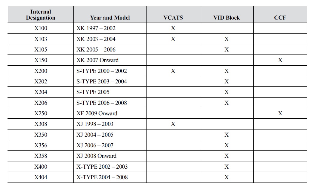

Originally Posted by xjrguy
Just to be clear fellas, a 2000 XK8 will have to have the immobilization reset to allow starting. Any car with a PATS key, a key with a chip in it, will have to have to have that done if a used IPC is installed. Without doing that, it thinks the key is un-programmed and will not crank and start.
Cheers,
Is a 2001 different? I have successfully swapped INSTPKs (with same VCATS) and it never set immobilization, just as motorcarman described.

Likes: 976
From: Indianapolis, IN
Thanks for keeping me honest, Steve. I sure didn't stop to think it fully through before I hit 'submit'.
Whether or not the immobilization has to be reset to allow starting after a module substitution, really depends on which engine management system the car has. That is because the modules involved in the PATS security system varies. I'll see if I can make this understandable:
X100, X308 4.0L V8 [AJ26/AJ27]
Denso 16-bit Engine System
X200 4.0L V8 and 3.0L V6 [AJ60/AJ28/AJ26]
PTEC Engine System
X103, X105, X202, X204, X206, X350, X356, X358, X400, X404 [AJ61/AJ62/AJ33/AJ34]
Denso 32-bit Engine system**
PATS Involved Modules:
Denso 16-bit
Engine Control Module [ECM]
Key Transponder Module [KTM]
Body Processor [BPM]
PTEC Engine System
Instrument Pack [IPC]
General Electronic Module [GECM]
Denso 32-bit
**For 2006-2008, the XJ and S-Type got a new engine system called the PAN-PAG ECM system, but the PATS remained the same.
Any PATS involved module, if it is substituted, can be 'immobilized' so it will function, [and allow starting] but it cannot be 'programmed' to the vehicle like it is a new module.
Whew! There it is. And you thought it was cut and dried...........
Sorry for the confusion.
