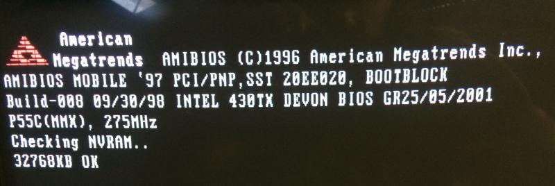

I have the 3 lots of software.
FORD Euro A6 / B45 / C5
JAG CD-2 / CD-42a / CD-43
ASTON CD002 / CD011 (Not the latest released CD013 is I believe)
The plan is to make a multiboot system to choose which to load at boot up.
Ford is a very powerful software install.
The Jag version lacks some of the Ford toys but does the job however can be temperamental!
Aston system is a lot like the Jags but a bit more basic.
I have also been able to run Windows 2000.
Upgraded processor from 233mhz to 275mhz.
Can only get locked PC66 memory to work upto 128MB
Used a solid state 16GB hard drive & 20GB normal types but no partition over 4GB!
The latest BIOS I have seen is this one.
