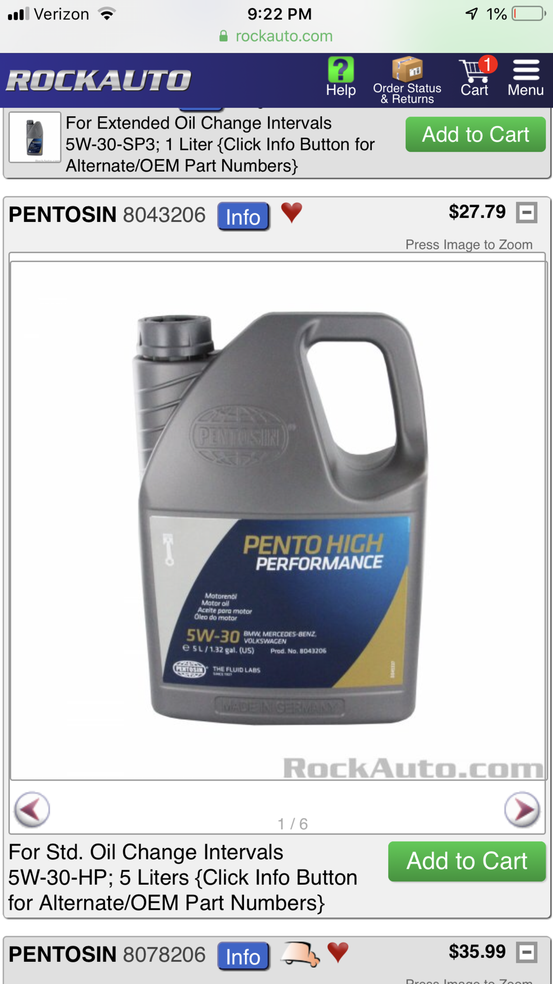

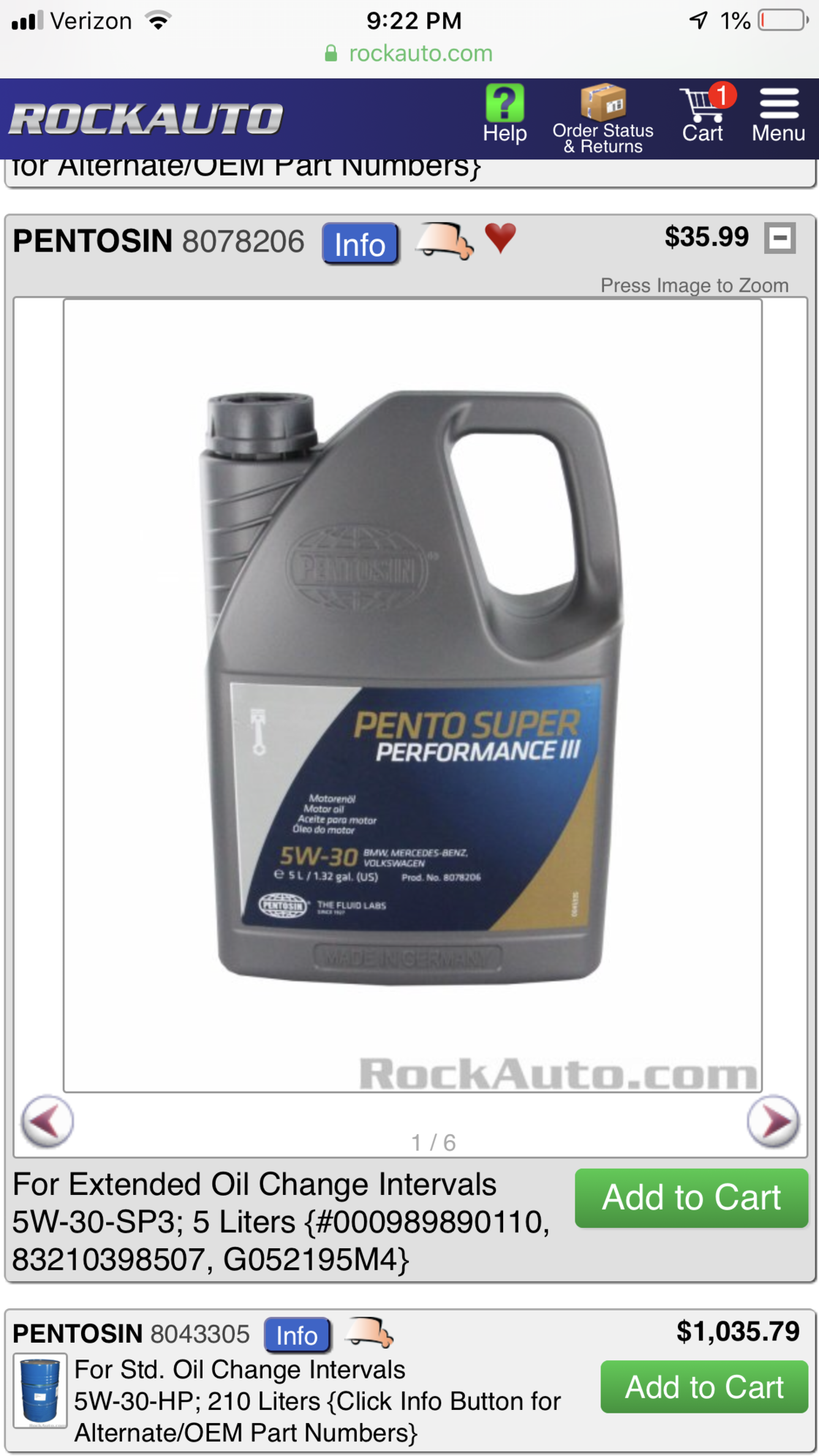

Default Where to get the oil and filter? Which one? How much?
Are any of these oils good? If so, which one should I get? How much do I need?

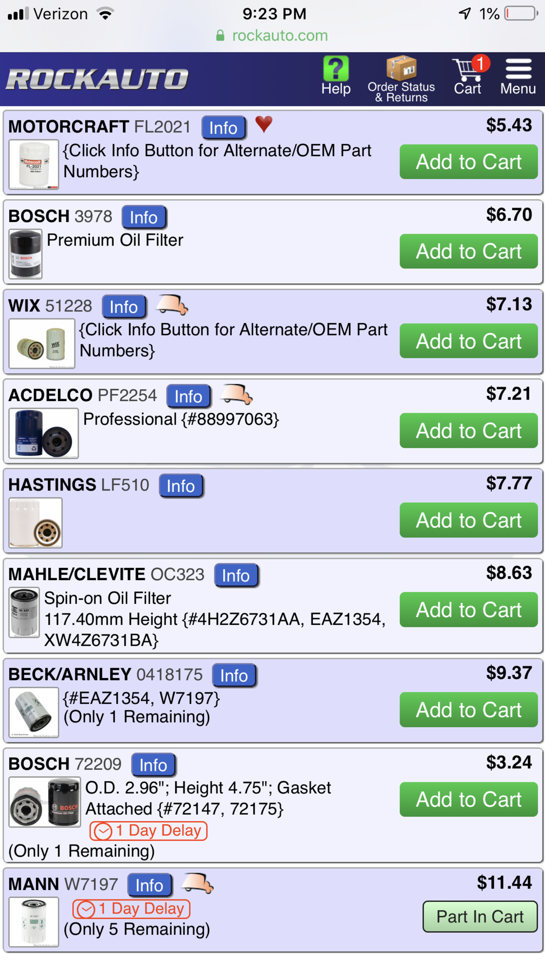

Will the mechanics be okay if I bring my own oil and oil filter? One mechanic here got irritable when I said I can buy the parts inline and I have the codes interpreted by forum friends.
Are any of these oil filters okay? Or is the Jaguar oil filter still better?

Default Oil filter
Is PG5317 an okay alternative to EAZ1354? The shop won’t allow me to bring my own oil filter.
Thanks guys. No I won’t do it myself. And yes maybe I am over analyzing but I just want to be sure with the parts and specs before I go.
