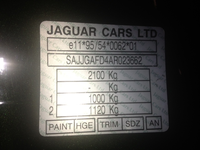

Dear Doug, I forgot to thank you for your reply. I am coming back to my original question as I am curious again about the VIN of my Jag. I tried many other VIN audit sites and no one is able to decrypt it.
I am attaching a photo of the VIN of my XK8 Convertible 1997 (SAJJGAFD4AR023662). Some sites reply that the 9th digit (control digit) is wrong and it should be 7 instead of 4.
Some other give as feedback an XF produced in 2010 (?).
Thanks in advance for any further help you may provide.
Luca
