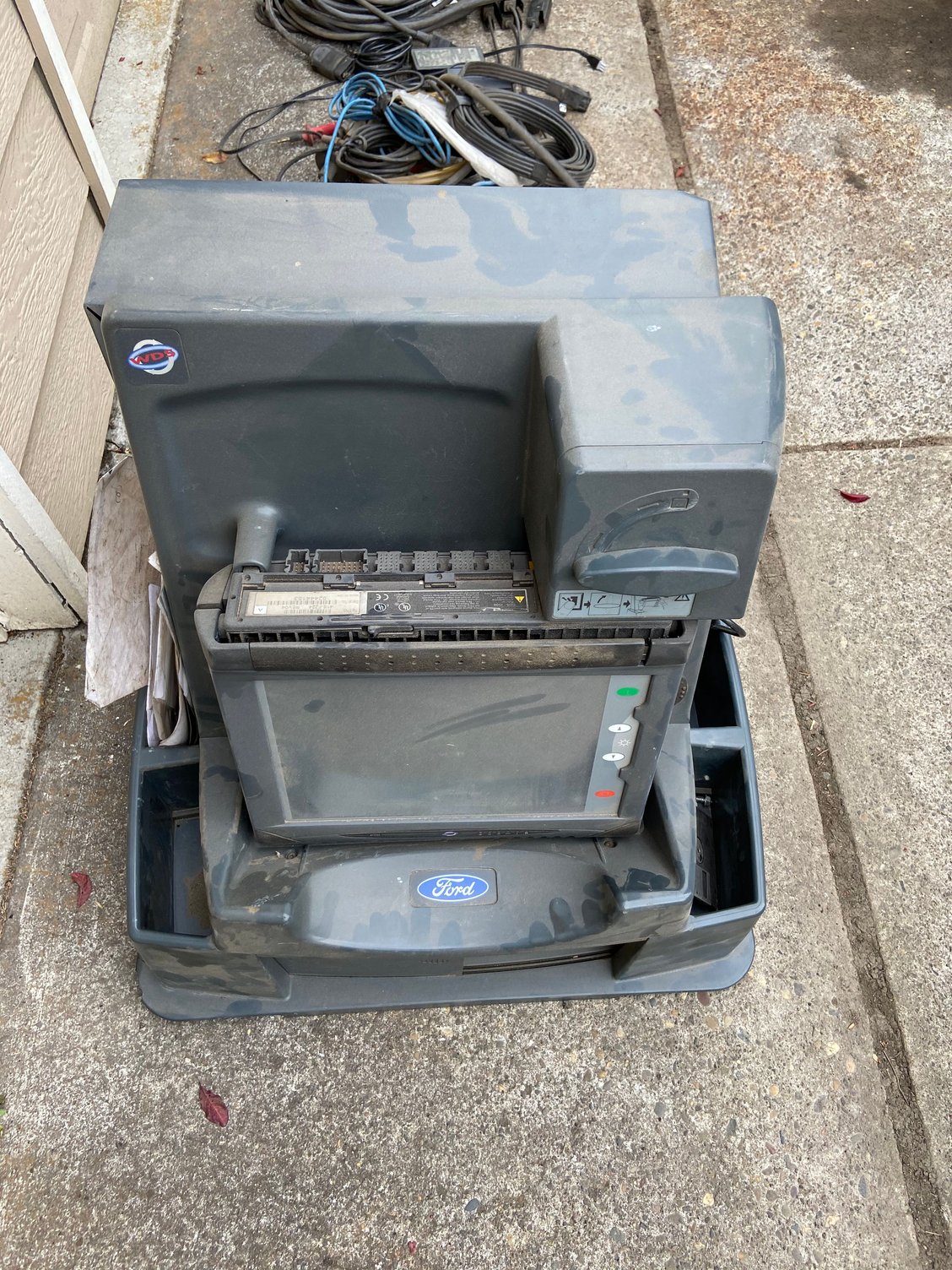

Look what I picked up on my trip to crater lake! Now my wife was very unamused. Any tips in software or should I just add to the giant WDS thread ......

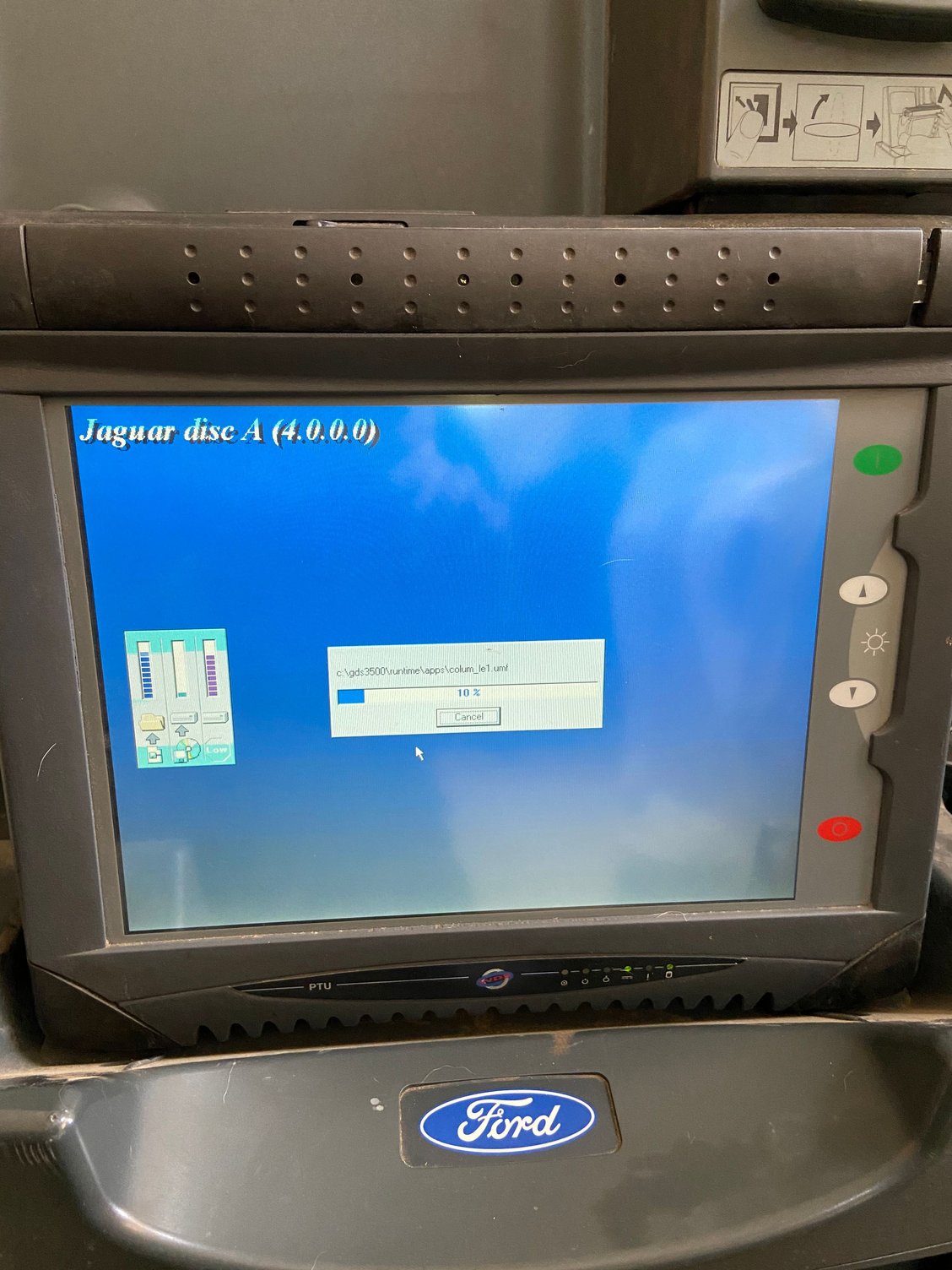

Default Getting closer

It takes about 3 or more hours to load GHOST, 42a and 43 into the Hard Disc Drive.
HDD needs to be larger than 3.2gb for Jaguar software. (3.2 is OK for Ford 43)

From: PDX
yeah, i was hoping i could squeeze it on but not gonna happen i guess, since i have the 3.2. mainly just wanted to see if the CD drive was functional and if the power supply fan can hold up.
