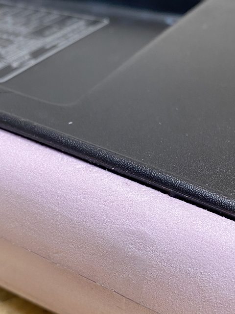

After doing some research and wandering at Home Depot I found a very dense foam that is generally used for insulation. I am not positive if I will end up wrapping the foam, or just using the foam as a prototype to make the final version out of wood or fiberglass. Either way, as with anything else, it is all about measuring and patience.
[Measuring the bottom plate, and the width of the OEM armrest.]

[Foam cut down to a closer size to armrest and stacked three pieces high]

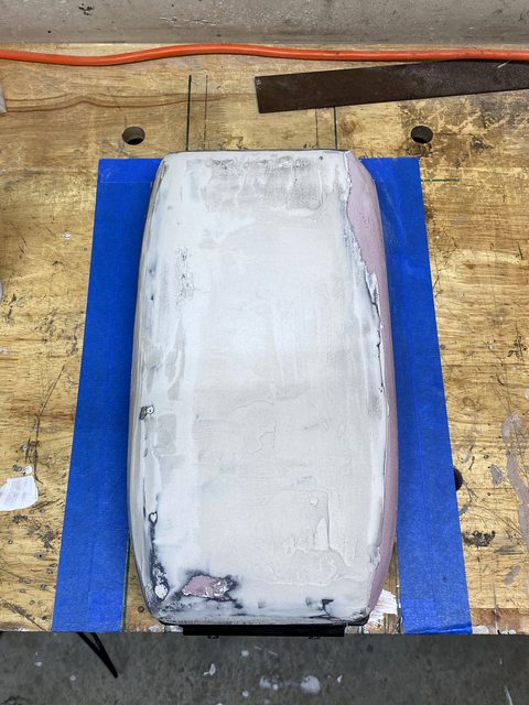

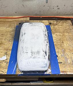

Spent the last week or so shaping/sanding/priming/sanding the foam to get it about the right size before finishing sanding etc

Getting there!

This is where I stopped last night. I hope to finish it up today:

I need to decide what my next step is. I dont know if I should send it to get covered like this, or wrap it in fiberglass first, so it is more rigid. Thoughts?

Depends on how much "give" you want in the finished armrest. A fibreglass wrap followed by trimmer's thin foam under the cover will make it about as rigid as a door card. Leaving "as is" will probably get it about the same "give" as a seat bolster. First option would be longer lasting but second option more comfortable.
