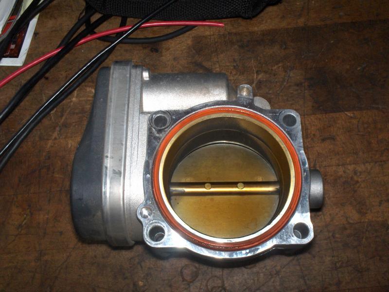

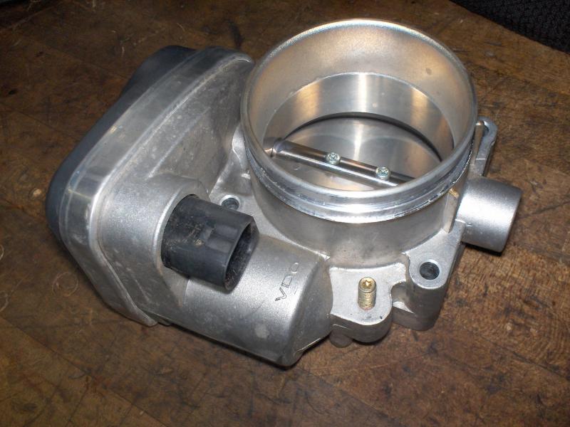

Any opinion as to why this throttle body from a 2005 BMW X5 is not heated in any way? There is no preheated air before the throttle body or air cleaner housing. It has a fresh air duct (from above and in front of the radiator support) to the air cleaner housing. Why do you suppose the icing is not a problem here?
It does have a pressure controlled crankcase ventilation valve. Many manufacturers are using this design. No blow-by gasses are directed before the throttle plate. Notice the clean throttle body plate and bore on this high mileage (150,000+ mile) BMW engine. I know it's just a coincidence that there is no blow by residue problem here and the throttle body is not heated.
Any thoughts?
Any thoughts?
^^right, key being the crankcase is NOT vented to the inlet track BEFORE the TB. This is common on most cars because you need to vent before to allow flow during higher rpm and low to no vacuum. Then its ported behind the throttle body for venting when vacuum is high and rpm is low. Im sure there are other ways this can be done. But the current setup has been used for decades. The info Iv egiven on the WHY, is from ASE Advanced diagnosis training as to functionality of differant systems
Thanks, Brutal. I understand how the pcv system works on both the traditional pcv sysem and this newer pressure controlled crankcase valve system.
The topic of this thread is "Why heat the throttle body?". The answer on this thread is that it's to prevent "icing".
My question is "Why is this throttle body not heated?". What did they do to overcome the icing problem and not require the heating? I'm sorry if you already explained it and I have not yet grasped the answer.
No Joe, you grasp it which is why I said "^^^^RIGHT" and then just went alittle further for all reading. auto engineers do many things the same way theyve always been getting the same results theyve always gotten. Until.....someone goes out of the box and then we get things like variable valve timing that morphs to variable lift and duration, to injecting fuel IN the chamber instead of in the intake track. and we end up with smaller engines putting out way more hp, way better mpg, and lower emmissions than ever before. Cant wait to see where we are gonna be in another 10-20yrs
