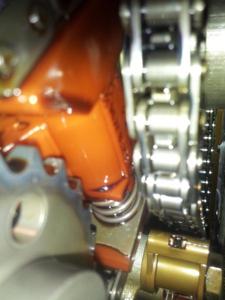

Well folks,
Removing the valve covers was actually pretty easy. I recommend having a metric deep socket set handy. I found that there is enough space and as XJR-0220 said, there is enough compliance from the wiring and hoses that you can leave them all connected.
I put on new gaskets and changed my plugs with NGK iridium (had bosch, cough) while I was in there.
But, one problem.....orange plastic tensioners with small crack (too small to see in the close up photo, but there) Poo.
Attached Thumbnails Would anyone be kind enough to tell me the procedure to remove a valve cover?-2012-07-05-13.19.48.jpg   Would anyone be kind enough to tell me the procedure to remove a valve cover?-2012-07-05-13.09.03.jpg   Would anyone be kind enough to tell me the procedure to remove a valve cover?-2012-07-05-13.18.52.jpg   Would anyone be kind enough to tell me the procedure to remove a valve cover?-2012-07-05-13.22.28.jpg

Old 07-05-2012, 08:00 PM
Join Date: Nov 2010
Location: Utah
Posts: 404
Received 67 Likes on 47 Posts
Ok then something is not right here from what I know, and thts not everything Im sad to say, but your car being an 02 should not have plastic tensioners. But guess its a darn good thing you looked makes ya wonder if your engine was replaced and you may have an older engine in a newer car. Maybe its nikasil block not lined (if its still running good thats a bonus not a bad thing like some like to think nikasil is better) Id pull the engine number and see what you can find out. Also did you remove the wire loom from the coil wires in the 2nd pic? this too leads me to believe something is amiss, well another project tht you can put in the books lol.
Old 07-05-2012, 08:56 PM
WaterDragon's Avatar
Join Date: Jun 2012
Location: Los Gatos, CA
Posts: 1,761
Received 278 Likes on 193 Posts
The car was made July of 2001, so I think it was the last of the plastic tensioners (lucky me).
I only moved the wire loom over the charge coolers, but left everything plugged in the whole time.
Old 07-05-2012, 11:47 PM
Join Date: Nov 2010
Location: Utah
Posts: 404
I was meaning tht the wires are bare and can be seen mine have a loom covering the wires
