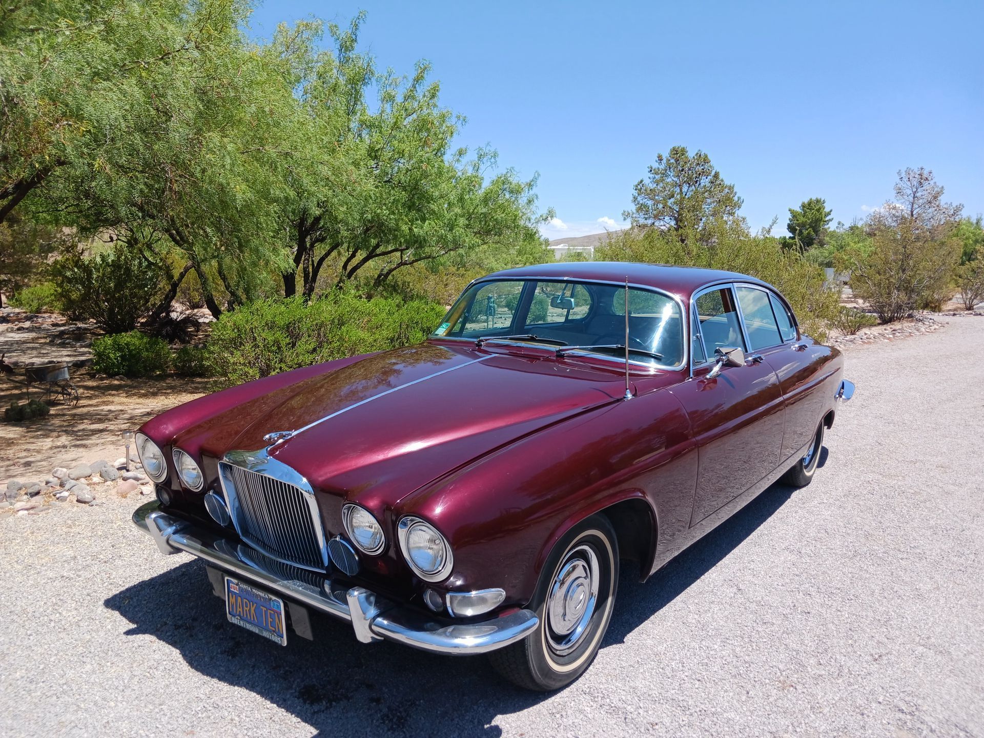

So here she is:
Now I just have to figure out how to get her here.
Isn't she pretty? 😍
