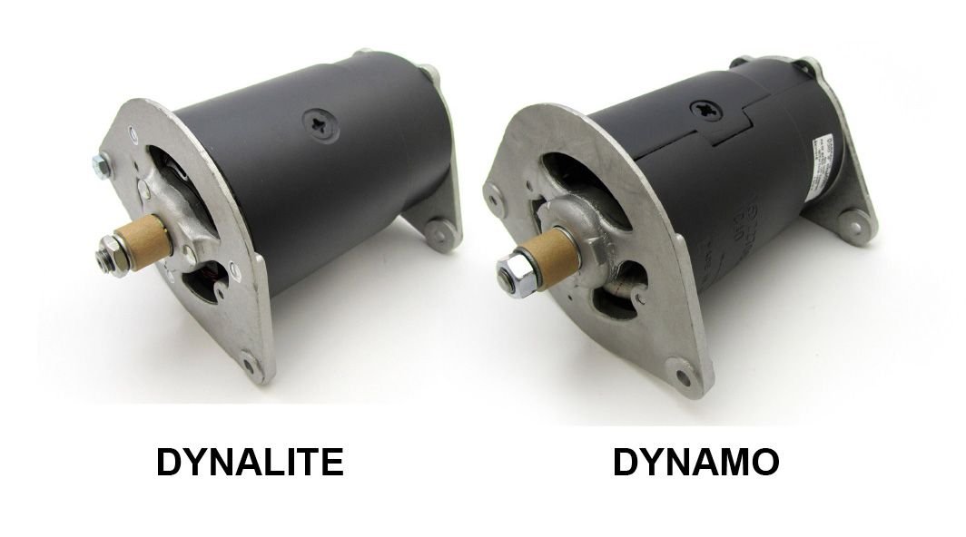

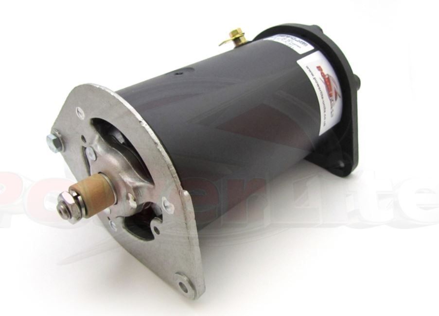

Most people use the Dynalite units ~ they have a few Jag models depending on output you want. They use them because they are purposely built to look like a Lucas generator & are available with the PS Pump offtake on the rear. (Also known as Dynamator in the US.) Available positive & negative earth. Also available without PS Pump offtake.
Alternators are not cheap. You may want to have your existing unit rebuilt. Might only need new diodes.
https://www.powerlite-units.com/dyna...ns.html?page=3
Standard Lucas generator on a friends car (There was an uprated unit available with a brush cover band around it similar to above) IIRC Standard 30amp ~ uprated 45amp.

I changed to a Dynalite a couple of years ago when I converted to Negative earth. The unit looks identical to the original Generator, easy to fit and gives a lot more power. Prices were up around £600 in 2014 but dropped to around £150 when I came to buy one in 2018. This is one site that sells them but they have gone back up in price. https://www.powerlite-units.com/dynalites/rac007.html
