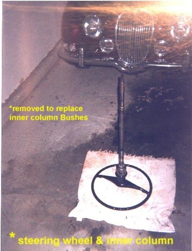

here's a pic of mine when I replaced the bushes.
