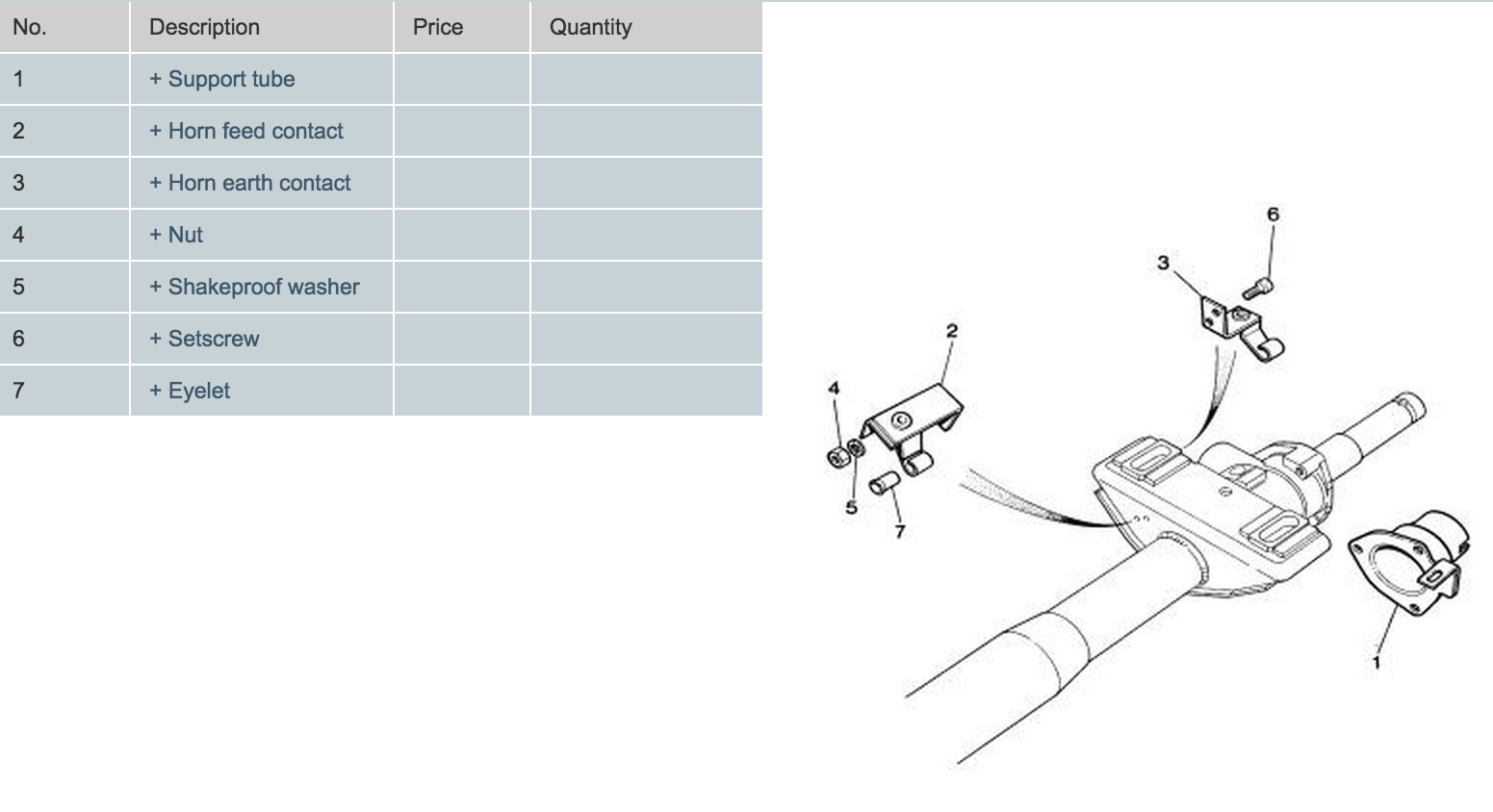

In the picture I noticed these parts (#2 & #3) further down on the steering column having to do with horn earth contacts. Has anyone replaced these yet?
Those are the 'wipers' Greg was mentioning

the mounts for these can become loose and cause a short or open circuit resulting in horn problems
the parts shown above are available brand new from jaguar for about $10 each , or less
they are fiddly to refit, but it can be done, as i have replaced my own
this will no doubt be your issue with a continuous horn
