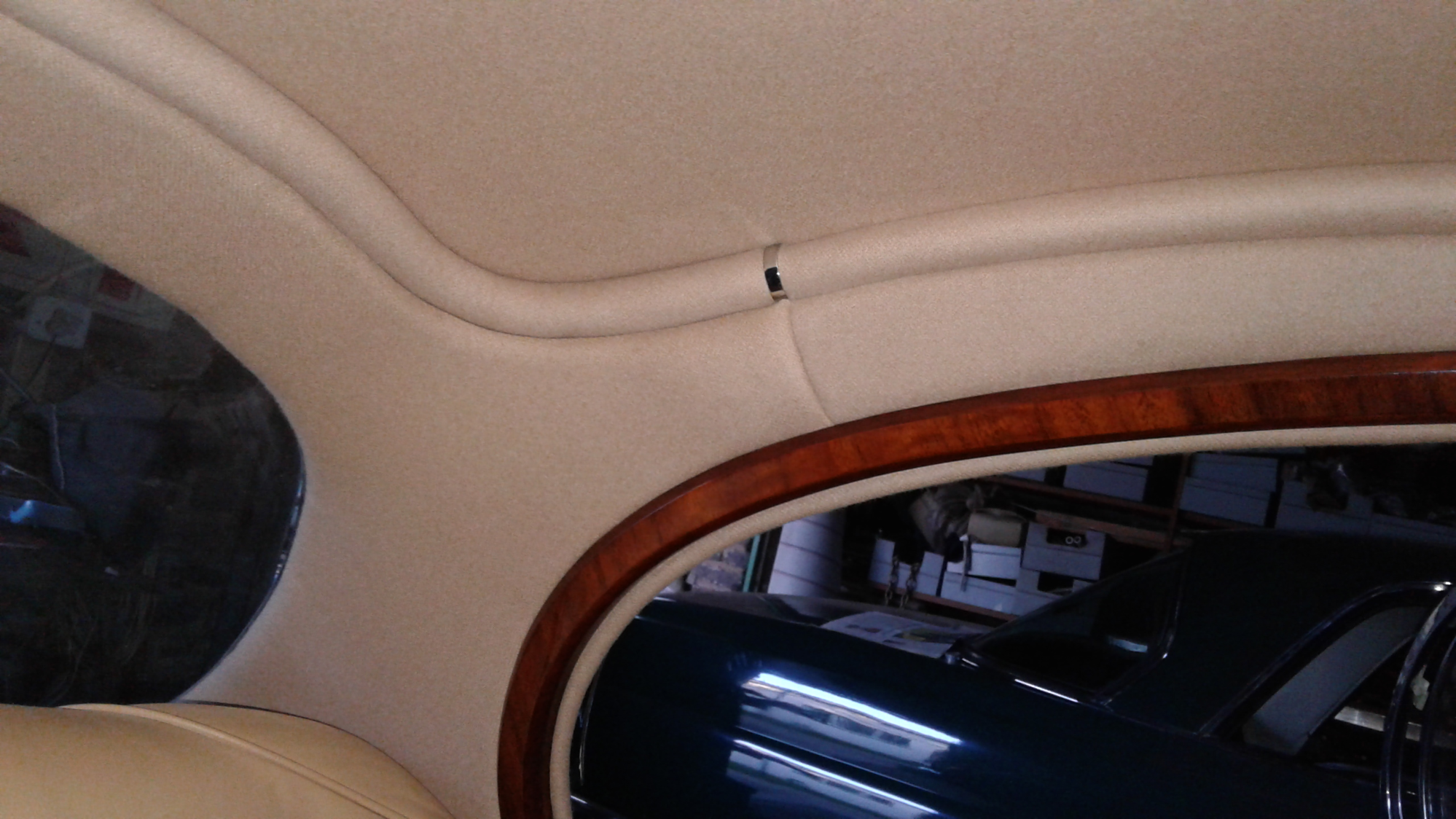

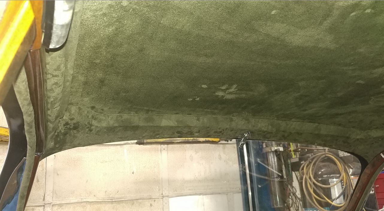

Not at all. I agree with you completely. All I'm saying is he would like to send out a finished product That He makes a Profit on. He uses some pics of my car on his website & I have sent him bits he had missing from his S Type templates. I have found his kits more accurate than BAS. Especially materials. e.g. roof lining. BAS uses the wrong material. (I have samples of both) Jon (Jonathan) uses lambswool Union Cloth which is what Jaguar used. John was his Dad after whom the company is named.
e.g. BAS rooflining. Thin hard foam backed. (depends on the way you brush it as to how it looks).
Skinner Rooflining (Original Union Cloth).
