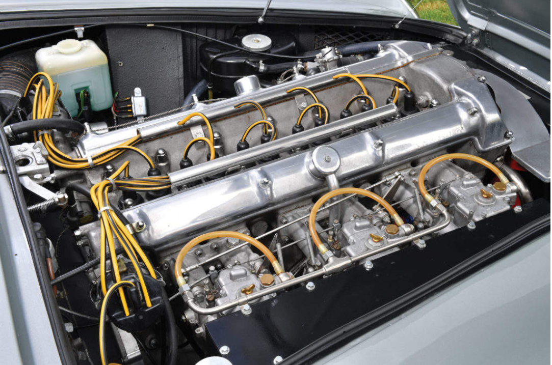

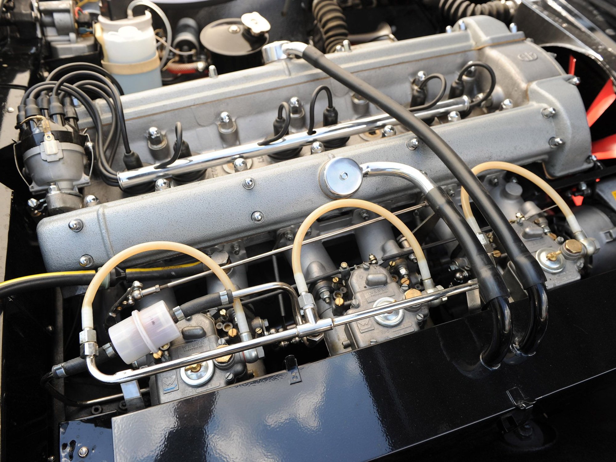

Indeed ~ Just pointing it out. In SA we have plenty of wide open spaces where you can take a car up to it's max speed. I've had my Merc at 270km/h before I chickened out. We don't respect Europe's 250km/h cap. That limit is not controlled on SA vehicles. Come to think of it neither does Jaguar on some of their top models even in Europe. A well restored E Type will push it's nose up against that V rating. Especially if fitted with triple side draught Weber carbs like an Aston Vantage of our era. And no the Tadek Marek engine is not a copy of an XK. Firstly it is not long stroke, secondly it is all aluminium including block & thirdly it runs dry sleeves sealed top & bottom for greater efficiency. No coolant around the sleeve.
Then you had the twin plug per cylinder engine that was even quicker/more powerful but a b*tch to tune. Synchronising twin distributors!
