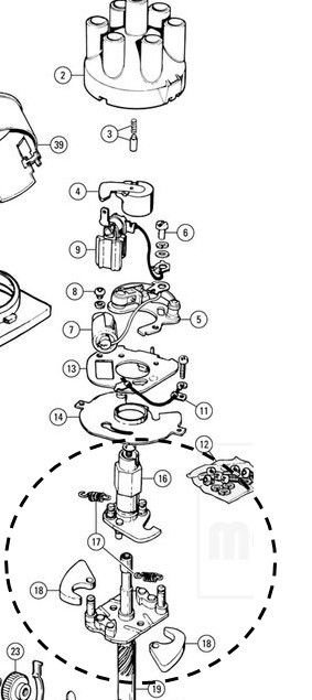

Hi Glyn
Are there any detailed photographs showing the internal components of the Lucas distributor DMBZ 6A, in particular the indicated (dotted) area, once the point plate has been removed ?
My best regards
Gérard
