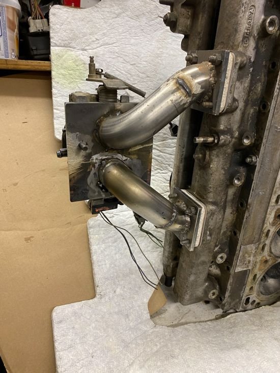

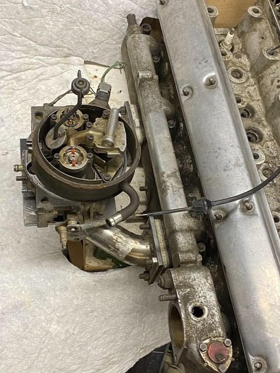

The final option, my preference, is make your own plenum and manifold.
That is the route I'm going to take as a next winter project. I currently have adapters that put an injector on top of the SU's and I'm having trouble with even fuel distribution. I think fuel puddles behind the bridge at low speed and then gets sucked in when I open the throttle. I am having trouble getting repeatable results, which makes it impossible to tune.
I made a manifold out of some stainless tubing with a 90 and a 45° bend and had plates laser cut to fit to the existing manifold carb mounting points and a flat plate to bolt the TBI unit to. The TBI is a General Motors unit, used on the 1988-95 trucks and Suburbans. They are very durable and seem to last forever. I've driven some high mileage GM trucks and the TBI units give no trouble. The injectors for the 5.7L match the flow rate of the ones I have now, so tuning will be minimal. I like these TBI units as they are self contained. The idle speed control and throttle position sensor are all there, as well a vacuum ports for the brake booster and ECU. I'll have to connect the wiring and figure out a throttle cable, but that shouldn't be too difficult.
The head and manifold are off a parts car, I'm using it for mock up purposes.

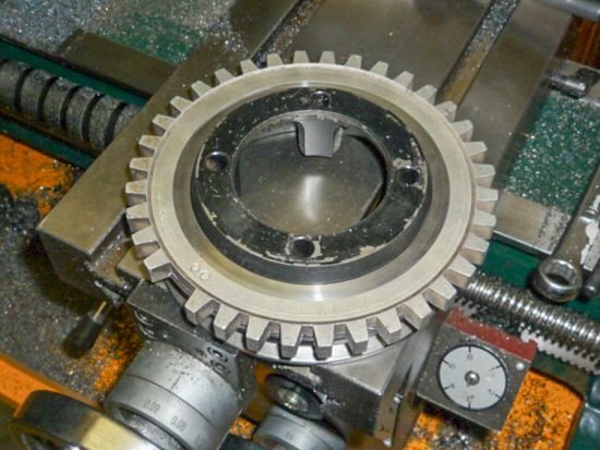

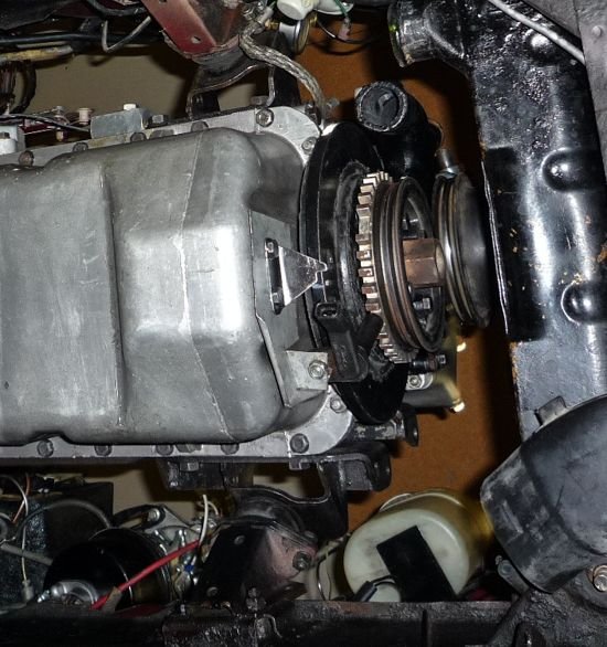

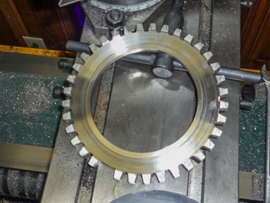

I obtained a 36-1 wheel from a Ford Escort 1.9, and then I machined a shoulder in the pulley of the 3.8. I made it a slight interference fit, and then I heat shrunk the trigger wheel onto the pulley at the correct orientation. I am using the Ford EDIS ignition system, and then made a bracket to hold the pickup sensor. The sensor came from a Crown Victoria.
Many Fords used a 36-1 wheel, so it was a matter of looking at cars in the junkyard until I found one that was the right size to use with the Jaguar pulley. Some Fords have grooves machined into the front pulley, the one I used was a discrete piece that was pressed onto the crankshaft damper.
In the last photo the sensor is unplugged, as I had the front suspension removed. The machine shop didn't give enough skirt clearance when the engine was machined, and the first time I drove it hard up a hill the engine seized. I dropped the pan and pulled out the two pistons that had seized and cleaned up the internals and then reassembled with two new pistons. Running fine so far!

Thank you! The idea was that if I ever wanted to return to the original carbs, I could; so I'm trying to make the modifications as bolt in as possible and reversible. The original Jaguar manifold is far from ideal from a flow point of view, but the choices are limited for what fits a B type head.
My "Plan B" if this doesn't work well, is I have a manifold from the J60 military engine and I'll put the TBI on top of that. The military engine had a big Solex downdraft carb, so replacing the carb with the TBI would be simple. The downside is that it is designed for a straight port head, so I'd need to change the head. I do have a head from a low miles XJ6 in my stash of spare parts, but that's a lot more work than bolting on my manifold in place of carbs.
It's interesting that the J60 manifold is clearly based on the 4.2 E type manifold, but converted to downdraft, rather than side draft. Jaguar was clearly making as few new patterns for casting as they could get away with. I'm not sure how ideal the flow path is either!
