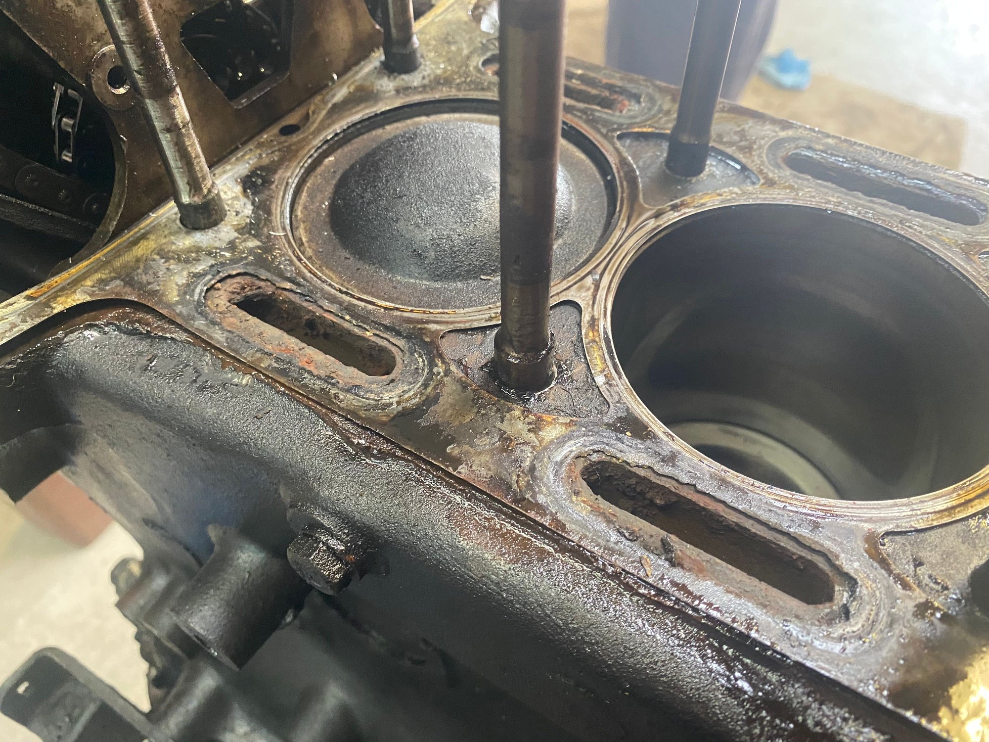

You might try spraying some lubricant in between the studs and the head and let it soak in a day or so. If they are corroded then it will be difficult to remove the head. My head gasket failed and the head came off real easy.
The stud in the foreground is the number eight stud with the larger collar

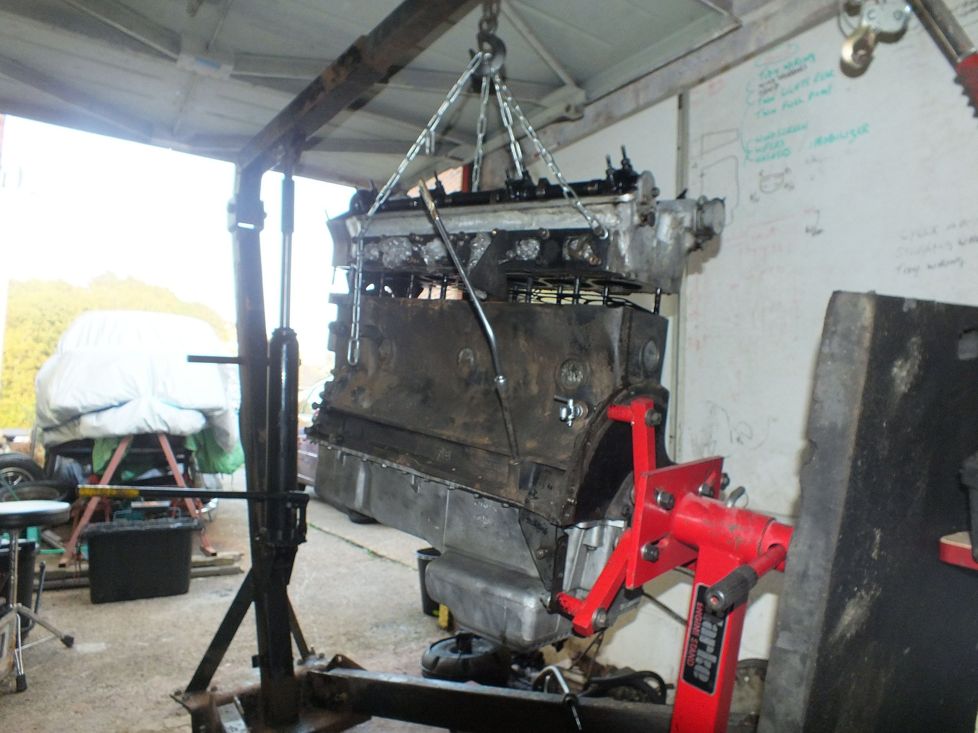

The studs only need replacing if they are damaged. They can be damaged in a couple of ways. The studs can rust into the block especially if you have had a head gasket go and water has seeped into the thread holes. I have seen studs snap off when trying to be removed from the block due to corrosion. The shaft of the studs can become corroded due to the chemical reaction between the alloy head and the iron of the stud. This is generally the alloy that furs up locking the stud in the hole in the head making the removal of the head almost impossible. Not heard of using bottle jacks to get the head off but I used an engine crane to remove mine. The block was held on an engine stand and I then attached the engine crane to the head using chains to give an even pull. I then put pressure on the engine crane to lift the head and with some suitably directed hits with a nylon hammer the head eased off the block. Photo below.
If you do want to remove the studs heat is your friend and I was given a tip to free up any stubborn or rusted in studs. Using a hot gun or a gas flame heat up the stud and block which normally breaks the rust lock but whilst it is still hot get a wax candle and press it against the stud so the wax melts and runs down the stud into the threaded hole. The wax lubricates the thread and you should have no trouble turning the stud out.
