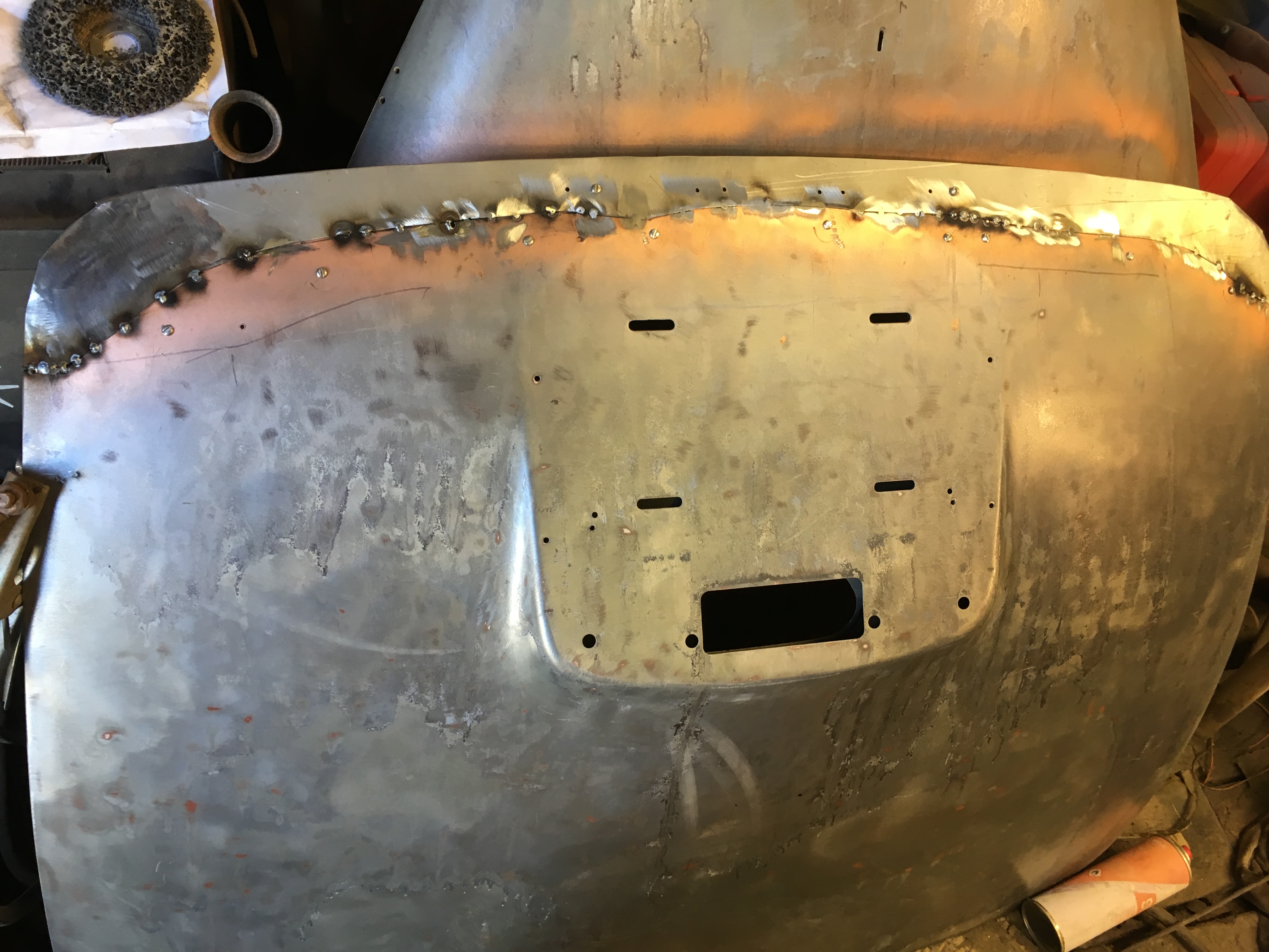

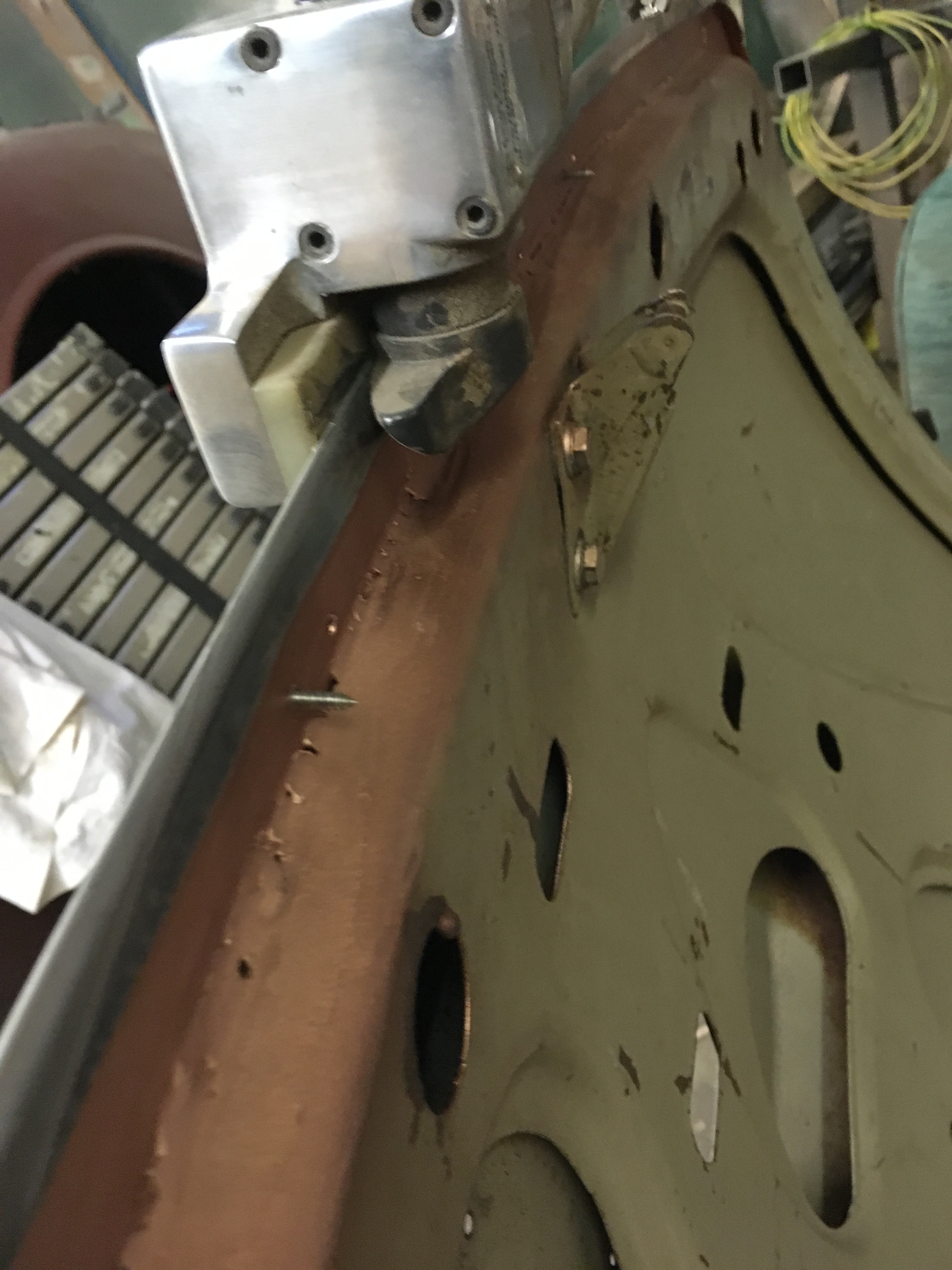

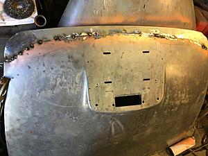

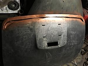

Striped the boot lid, and cut out the rusted section at the lower edge, I had to fabricate a new lip for the inside frame, and also a section of skin for the outside.
The skin is the most difficult as you have to fold the edge on a curve and without a press with a die this is not simple, I find that but using a grinder with a cutting disc to score a very shallow line on the inside face to match the curve, you can dress the metal and it will bend at the score point as this is slightly thinner than the rest of the metal, maybe not the perfect solution, but it does work.
After prepping the area, spot weld into place, and then fold over the seam, I have a great seamer which does a great job, and leaves no hammer and dolly marks on the edges, really easy !!
Now I have to refit the boot lid and fettle the edges to fit before spraying with zinc primer and epoxy after sandblasting the inside face.
I will start the same process with the doors, I have a new skin for one door and will make up a new bottom outer skin for another, hopefully the other 2 doors won't need the same treatment, but until I strip the paint and see if there is a bunch of filler covering unknown issues I don't know yet.

Thanks for sharing how you did that. The seamer is very impressive. Nice work. It is amazing what you can do!

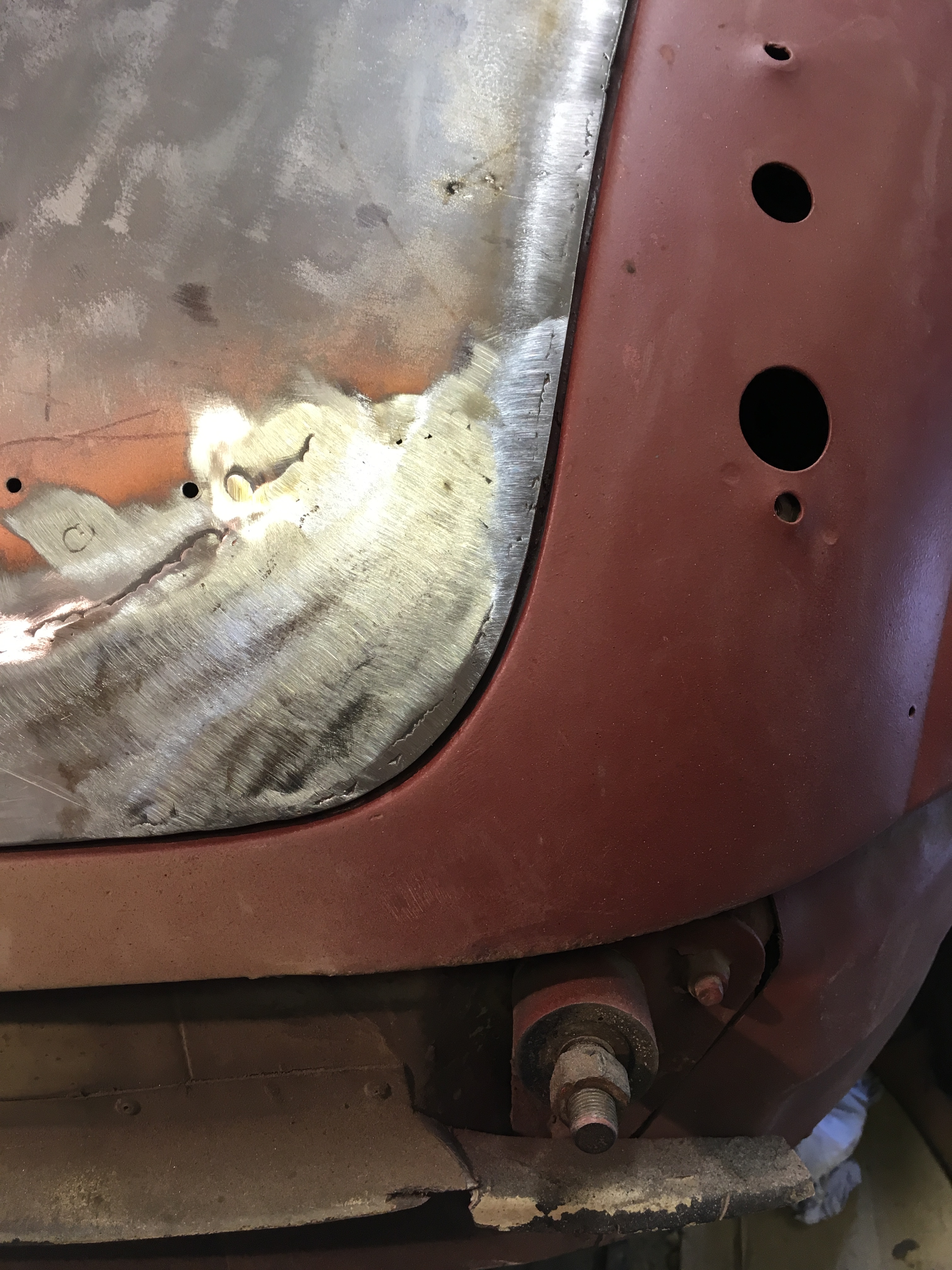

I got to start a little fettleing on the fit of the boot after the repairs.
The gaps were a little out on the tight curves, so I applied some mig weld to the edges and ground these back to improve the fit.
Little more to do before I get it in primer, and have to blast the inside face off too.

You can see the seamer in action in post #207 in the last but one picture.
Astro Pneumatic Air Power Car Door Skin Auto Body Shop Skinner Installation Tool | eBay
It wasn't cheap, but I am pretty sure I paid less than this, but they are the only manufacturer I have found that do one, saves a lot of time and does a great job.
I just looked it up. I paid £80, if you look for Astro Pneumatic DS1000 you will find them cheaper than the listing above, around $130 but I haven't looked very hard for cheaper suppliers

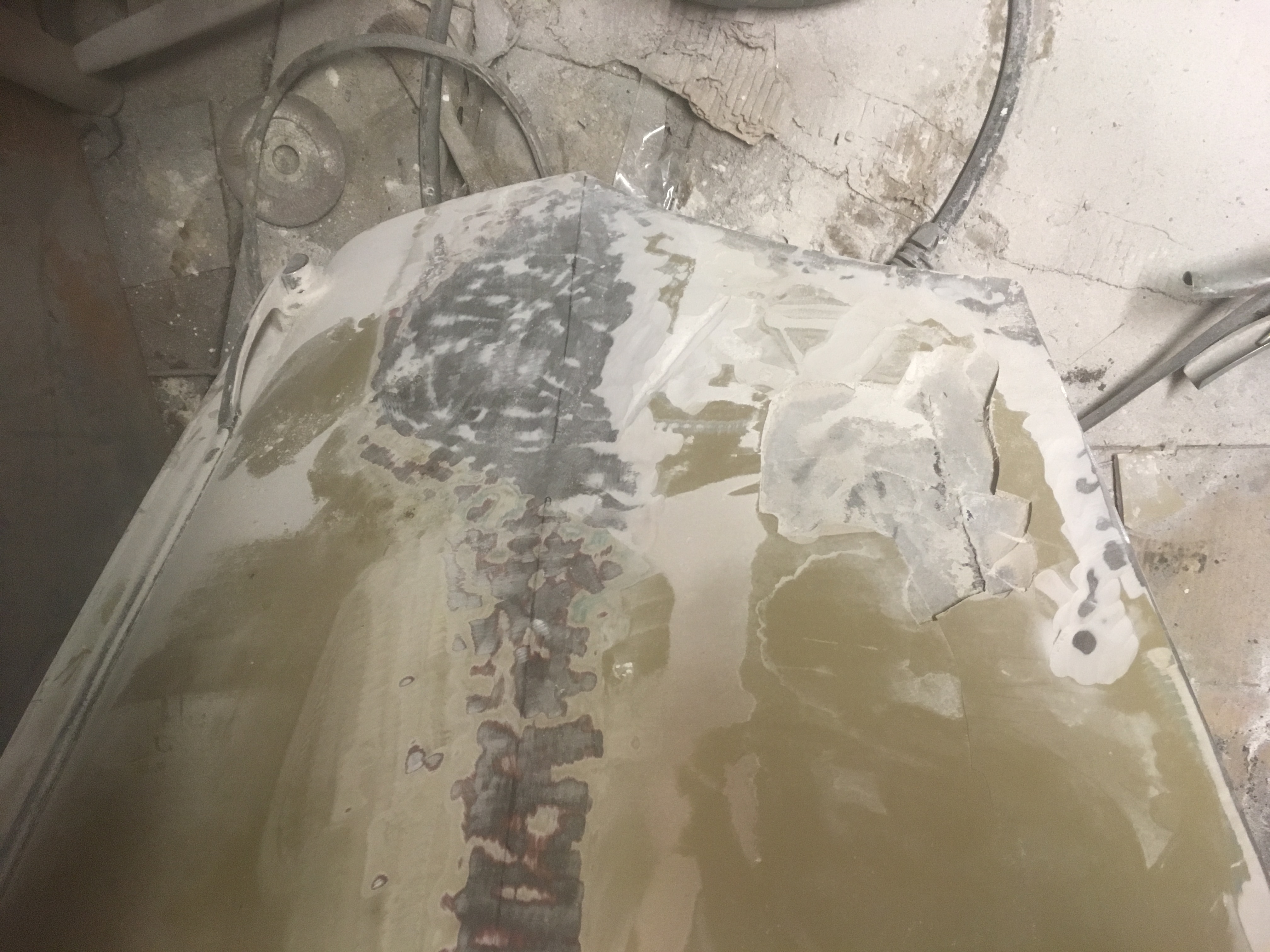

Thought I would strip the last rear door, this one looked pretty good - how wrong can you be !!!
The first thing I noticed was that I couldn't get the window frame out, the captive bolt on the rear window frame leg would not clear the mounting point, and I had to force it out, there wasn't enough clearance, and I thought that the wrong bolt had been used, but the real reason came to light shortly after.
I started the flap wheel on the door, and found some filler, then more and deeper and deeper, eventually I found the metal, buried under 1/2" of filler in some places, there had been a repair to the bottom of the door where about 3" of the skin had been replaced, and a strange 3" square patch part way up the door, for some reason beyond my comprehension, it is obviously a good idea to weld in the repair sections, and then drive over the welded area with a small articulated vehicle before carefully re sculpting it back into a very presentable shape with copious quantities of filler !!!!!!!
If you have followed this thread you will know that I have found that whoever did some repair work in the past was a genius with body filler, and no damn use at all with metal !

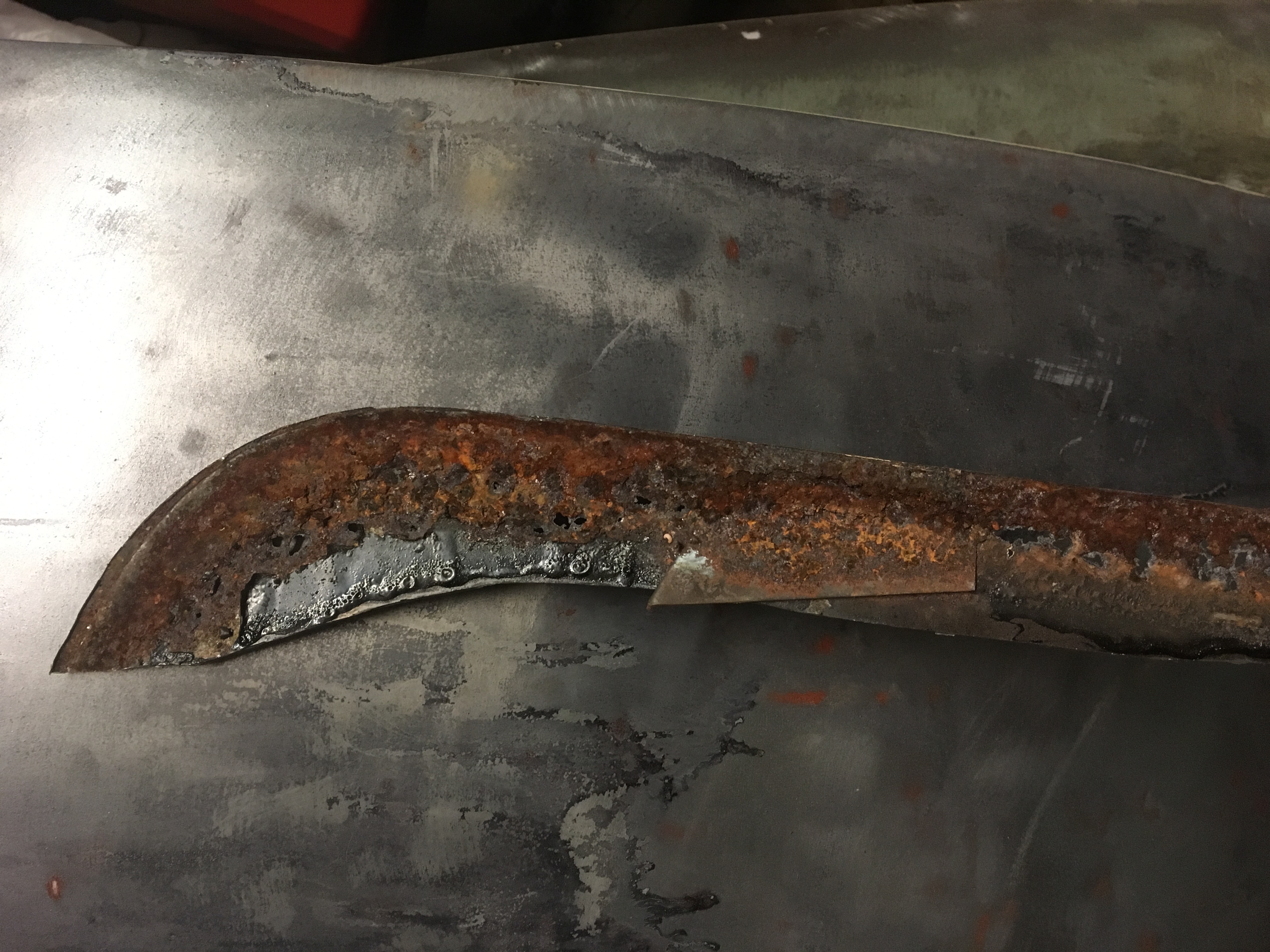

So off with the bottom half of the skin it is, you will see that this is fairly straight forward, grind the edge with a flap wheel until you just see the 2 parts coming apart, carry on around the door for the entire area that will be removed, cut across the panel, and off comes the skin - simple.
The mount for the rear window frame leg has rotted away, this is quite common as any water ingress soaks into the fiber packers and wreaks havoc with the steel, this is an easy repair with the skin off, and an absolute b****r if it's not.
I will update as this progresses, I have to order a new skin for this door as I thought it had survived intact before today's discoveries.
